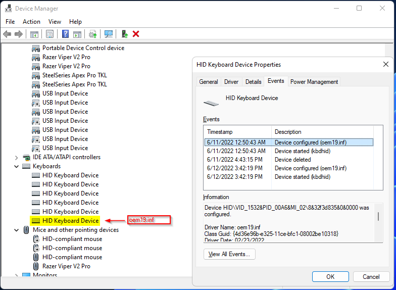

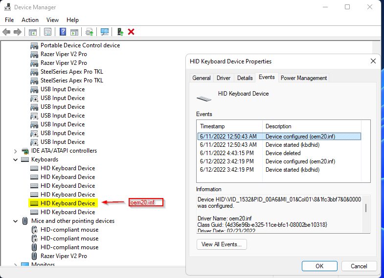

What a nightmare Razer mouse drivers are but I think I was able to accomplish everything you asked me to do. Check screenshots to confirm. Thanks again!
Note: Turns out the 'Razer Control Device' driver is required to communicate w/ Razer Synapse Software so I can configure my mouse settings so I had to re-enable this one.
all nice, but remove non connected old devices from devicecleanup
Ahhh, thought I did that already. I think when I disabled all of those devices, new 'non-connected old devices' reappeared again. I just cleared it out again. I did make an observation on the keyboards drivers install dates however and wonder if it's a problem. After performing all of the steps and disabling all devices except the mouse driver on my USB controller I noticed one of the keyboard drivers disappeared. I've been looking at the install dates of keyboard drivers and the newest one being today dating 6/12 is no longer under keyboards in device manager. Now all 4 drivers only show the existing date of 6/3 which may have been the original install date.
Is it a problem that the most current keyboard installed driver is no longer under Keyboards in device manager? I attached a snip showing what all HID Keyboard Device driver install dates are. The newest installation dating 6/13 disappeared after a reboot from disabling other usb input drivers on my usb controller.
More on this... I reset my settings and reinstalled my razer mouse to see what the razer keyboard drivers being installed are because my mouse felt off. Turns out the keyboard drivers being installed are oem19.inf and oem20.inf. When I disable all of the devices you said I should disable, these drivers are now disabled and removed leaving only old keyboard driver entries from 6/3 even though I installed today. I'm just speculating here but I wonder if this is a problem? Here are more screens to better illustrate What I'm trying to convey. Are these drivers even necessary? I honestly don't know.
I have one more screen which I'll post right after this one. Looks like I'm maxed out.

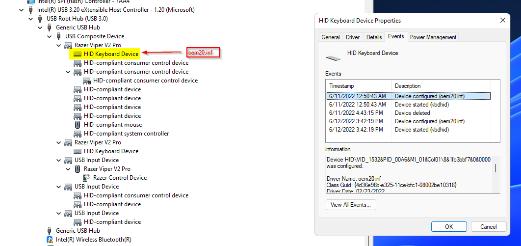

Last screenshot.

Edit: Razer drivers are a nightmare. For starters, Razer drivers install 2 keyboard drivers for unknown reasons. In my case oem19.inf and oem20.inf. I can't seem to figure out how to get this mouse to track consistently for long periods of times so I've decided to abandon this mouse altogether.
I'm going back to my pulsar xlite wireless mouse which appears to be very easily 'clean installed' and tracks perfectly with no discernible input lag. Maybe I'll spend more time on figuring out how to get Razer mice drivers/devices to work properly in the future but this has caused enough frustration as is.

Hi Slender, did I do everything right? (I cleaned everything and reinstalled the mouse driver), but why aren't the mouse drivers on top (the topmost red cross)? Does it affect which usb port my mouse is plugged into?
It's often preferable to have keyboard and mouse in completely separate USB root hubs anyway.
When you move the mouse or keyboard plugs, they will show up in different locations in these Device Manager. If you swap the mouse/keyboard plugs, the entries will also automatically swap in Device Manager. The location of USB devices in Device Manager is often dependant on which port you plug the USB device.

Noticed that my keyboard entries were above my mouse entries (same root hub though). When I switched the plugs around- their entry orders didn't change.
But when I plugged mouse in first (same port as original), and then keyboard, the mouse entries were on top. Does the order they're plugged matter?

Yes, it can affect the order of enumerating the USB devices.
As long as they're separate root hubs, the order doesn't really matter in my experience (unless they're contending the same USB root hub).
There should only be one high-Hz pollrate device per root hub anyway, otherwise they can start interfering with each other's performance. That part is way more important.

Other than mouse/keyboard, do the other devices using the same PCI bridge matter? Root hub found with Audio controller, Network Controller, etc.

Yes, and even more especially if you're using pollrates above 1000Hz.
I highly recommend such ultra high pollrate have its own dedicated USB root hub, even if you have to purchase a PCIe USB card and plug your Razer Viper 8KHz or Corsair Sabre PRO 8KHz mouse into it. Such ultra high pollrate devices are extremely sensitive to being jittered by other USB traffic on the same USB hub.
