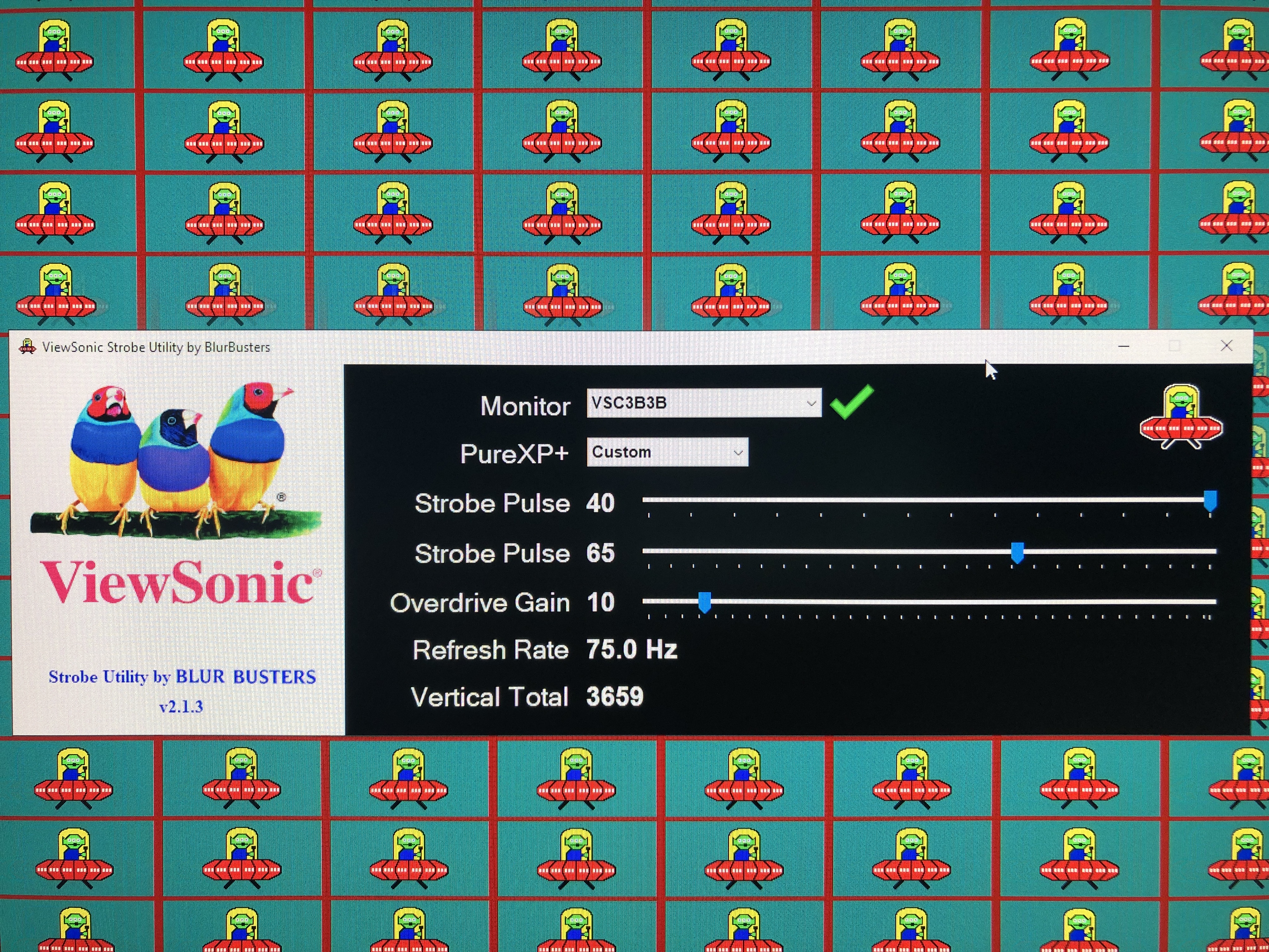

Love this monitor! Coming from an Asus PG248Q. I recently found out about ULMB and its benefits.
Nvidia Control Panel:
Brightness 60%
Contrast 70%
Gamma 1.20
Digital Vibrance 70%
Output Dynamic Range: Full
Strobe Utility by Blur Busters:
Width 40
Phase 65
Gain 10

TREACHER0US671 wrote: ↑
30 Oct 2022, 12:00
:D
Fantastic 75 Hz QFT crosstalk-free strobe mode.
There's some camera artifacts (moire) but certainly looks better in person than even that photograph.
