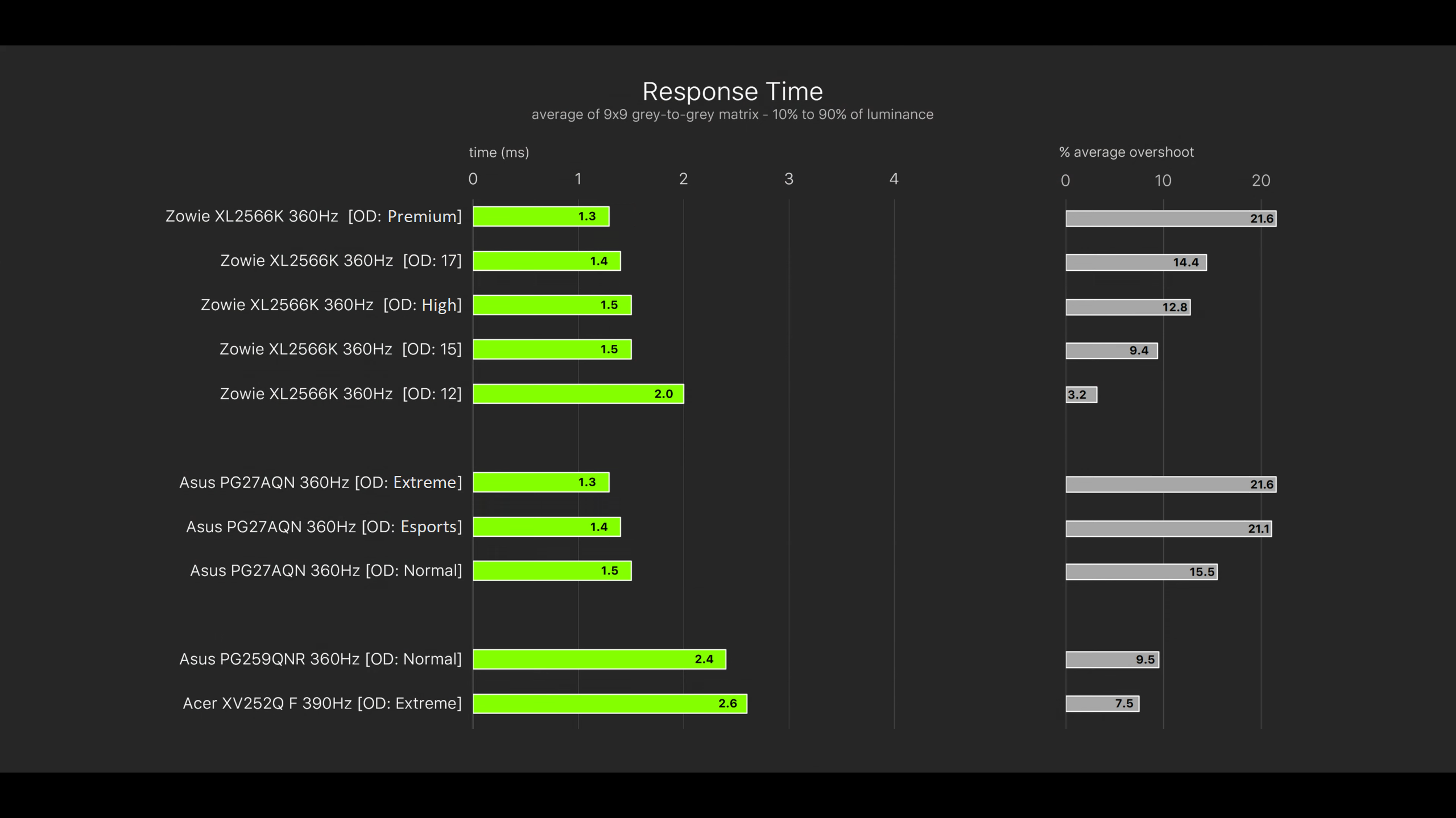

Oh that's unfortunate but good to know, thanks. Can his response time charts be used for a apples to apples comparison?
Response Times - Asus PG27AQN
Bildschirmfoto 2022-11-06 um 19.04.13.png (811.95 KiB) Viewed 25287 times
Response Times - Zowie XL2566K
Bildschirmfoto 2022-11-06 um 19.05.55.png (611.55 KiB) Viewed 25287 times
Pursuits are still usable tho.
From what I see both XL' and PG' are measured with same "10-90% of luminance" method so yes. But keep in mind its not really a 1.5 ms due to choice of this method.
Actually PG's extreme overdrive has the same avg 21,6% overshoot as XL's premium overdrive. So that's perhaps a good panel-vs-panel comparison. Off vs off would be ideal. We can see TN has faster falling transitions while IPS has faster rising transitions. Although IPS GtG doesn't enter the yellow/orange area on this heatmap (notice the max response times). On average they turn out identical.
If TN panel had same factory optimizations as this IPS it would definitely outpace it.
Very interesting! Thank you for the explanation.
Does that mean that this IPS panel has already caught up massively to the new 360hz Fast-TN panels in terms of motion blur and response times? (Compared to the previous 360hz IPS models)
That would be impressive

Actually looks like TN is still a hair faster. Zowie doesn't need as much overdrive gain to achieve same avg response, at least at 360Hz (OD 15 vs OD Normal). But god they are close!
Optimum Tech 360Hz GtG Comparison XL2566K vs PG279QN.png (388.12 KiB) Viewed 25210 times
This is awesome! But since "10%-90% of luminance" was measured when measuring with 0% to 100% GtG instead, could the result differ more? Or will the ratio remain roughly the same?
Can't say for 0-100% but for 3-97% + gamma correction is about 60% slower difference, roughly speaking.
