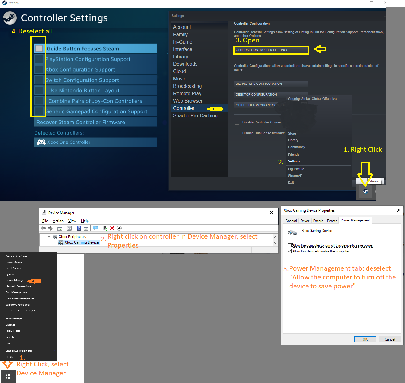

Is your PC in high performance power profile? I would make sure steam controller input is disabled and under Device Manager the controller isn't allowed to save power. These have caused all lag on my system.

and make sure those other settings are right:
computer not allowed to adjust power lower on peripherals, high performance power profile, steam controller input disabled

1. What is Steam Controller input? Where I can switch it off?

I had a lot of issues with spinouts in Assetto Corsa because of steam settings and power saving settings, especially when other players were nearby (online). I think the network packets were being prioritized over the controller inputs. I changed these controller settings and it helped a lot. The difference is significant and the cars handled much more responsively. I also decreased the force feedback frequency from 333hz to 60hz, I think.

Oh, thats interesting. Few days ago I checked "Xbox configuration Support" and it right away added input lag to my controller. I turned this off. But I dont turned off other settings. I will try this later. Thanks.

I forgot to mention before: Under Steam Library, right click on the affected game and go to properties, then disable Steam controller input from there.
