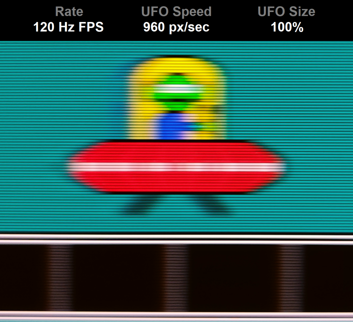

PG27AQN vs PG259QN @360Hz-FPS 960pps.png (641.81 KiB) Viewed 16633 times

Discorz wrote:
16 Nov 2022, 15:33
^ Ultra-fast IPS seems to be quite a jump from Fast IPS at 360Hz, and appears to finally have caught up with that refresh rate, for sure. Its overdrive performance in that capture rivals what I'm seeing on my PG279QM at 240Hz in the same scenario.

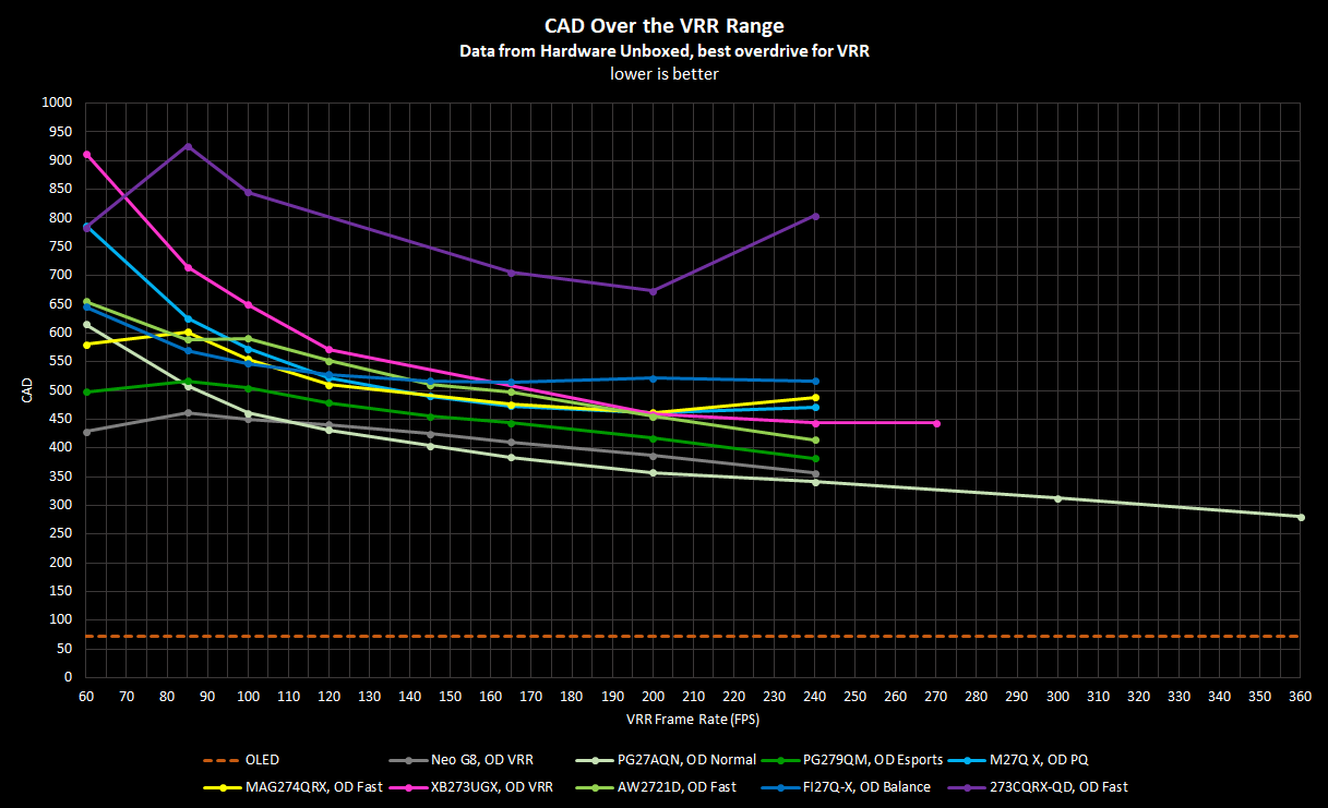

Considering how slow LCD GtG is evolving this is impressive for only one generation. Its lowest CAD on IPS so far. I'd like to see a cheaper "XG27AQN" model with same panel. That one would probably have ELMB/SYNC.
I wonder why they didn't tune the lower VRR framerate properly. Could of been much better.
VRR Performance, 1440p 240-360Hz.png (65.46 KiB) Viewed 16529 times
