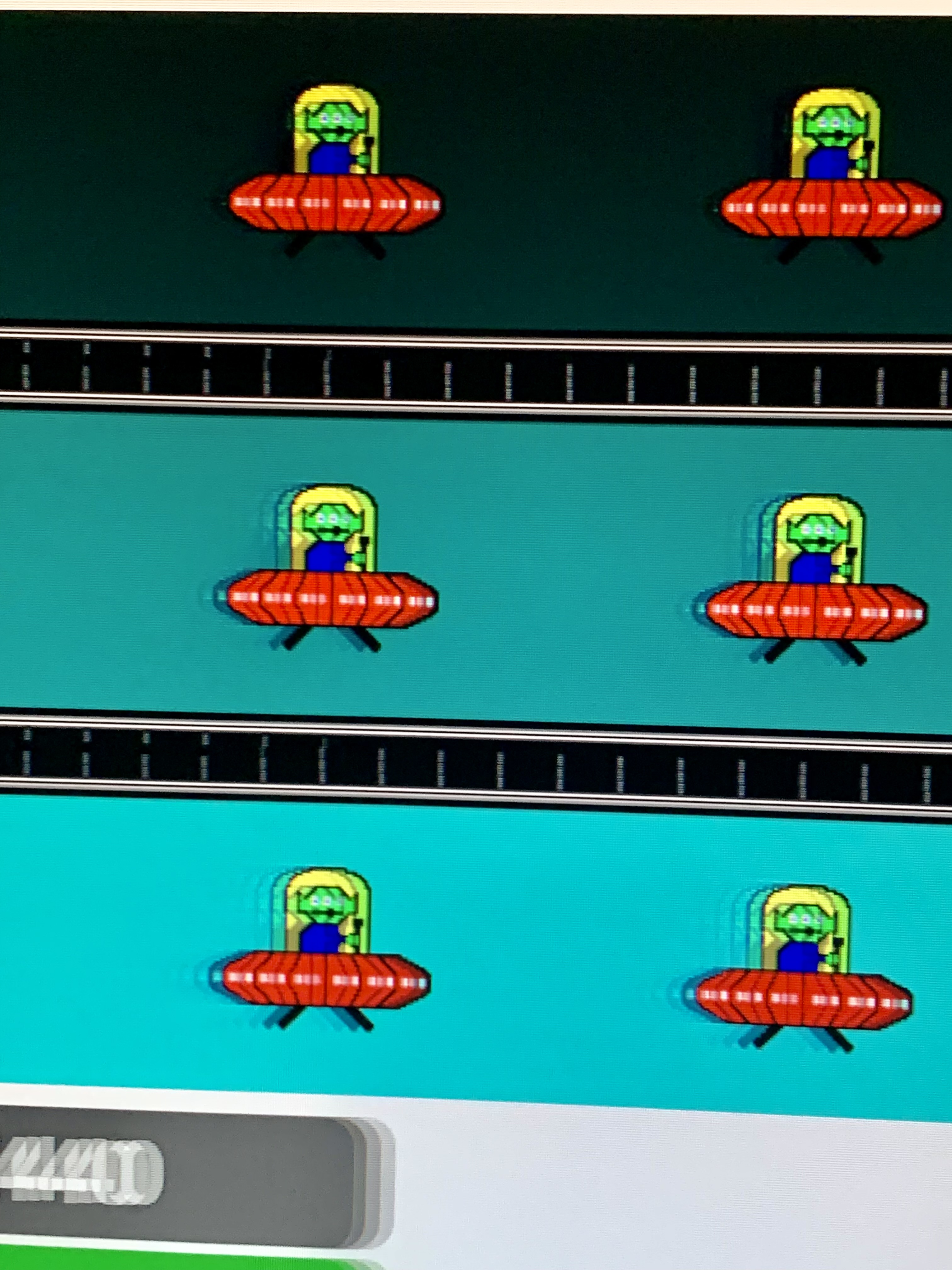

Can you do more pursuits of '8QM? With ELMB ON at max Hz and 120Hz. Btw is overdrive locked with ELMB?
Also it would be great if u can test ELMB-SYNC (adaptive-sync ON). But for this better use Smooth Frog because TestUFO does not test VRR range propery. Let me know if u're interested so I can give you quick instructions for the program. It's very similar to TestUFO so it will be easy.

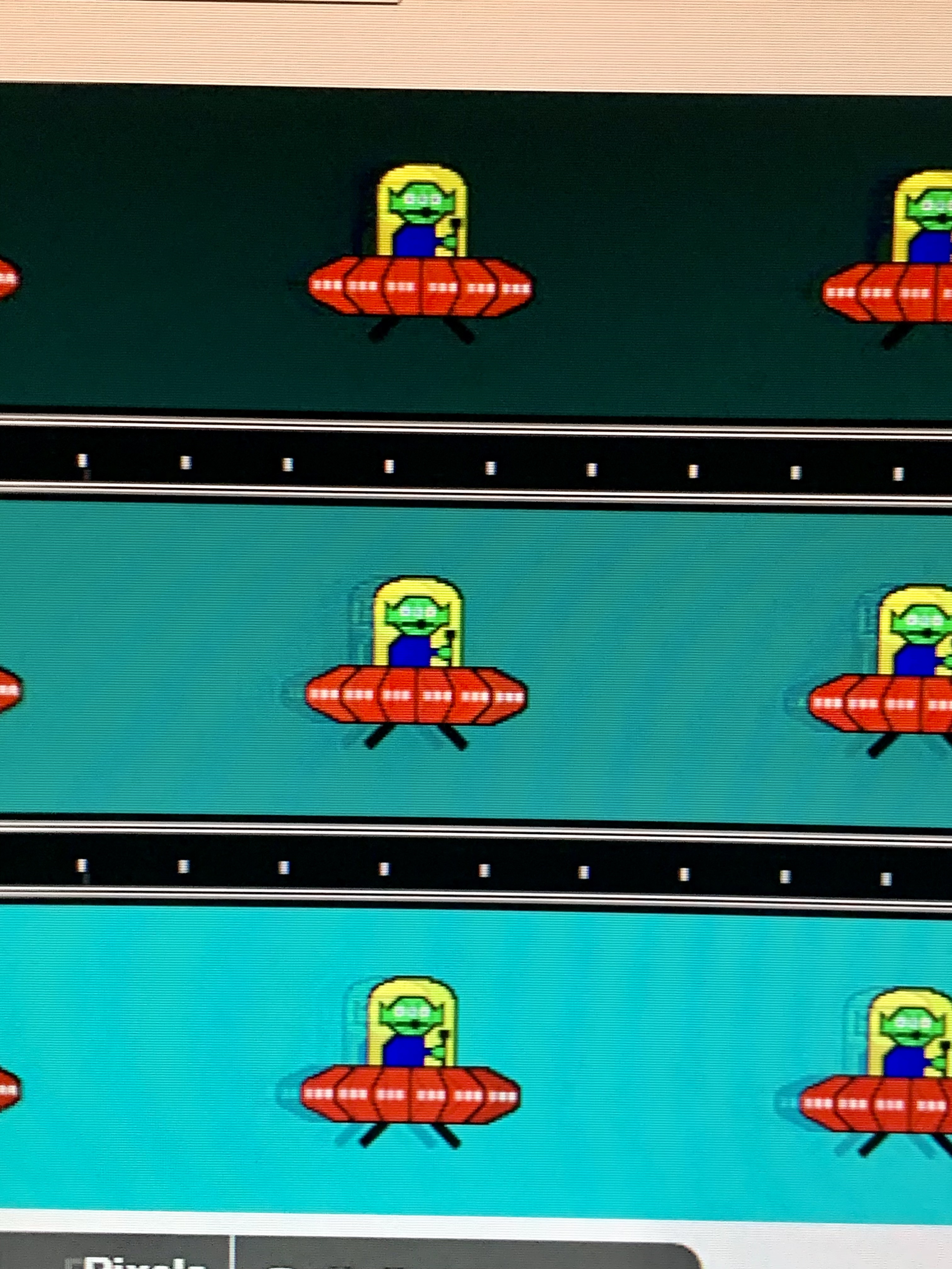

Yeah sure, but with my shaky hands and smartphone :D. Its as good as it is. Maybe these helps a bit!
Settings for photos:
960PPS 280hz:
960PPS 120hz

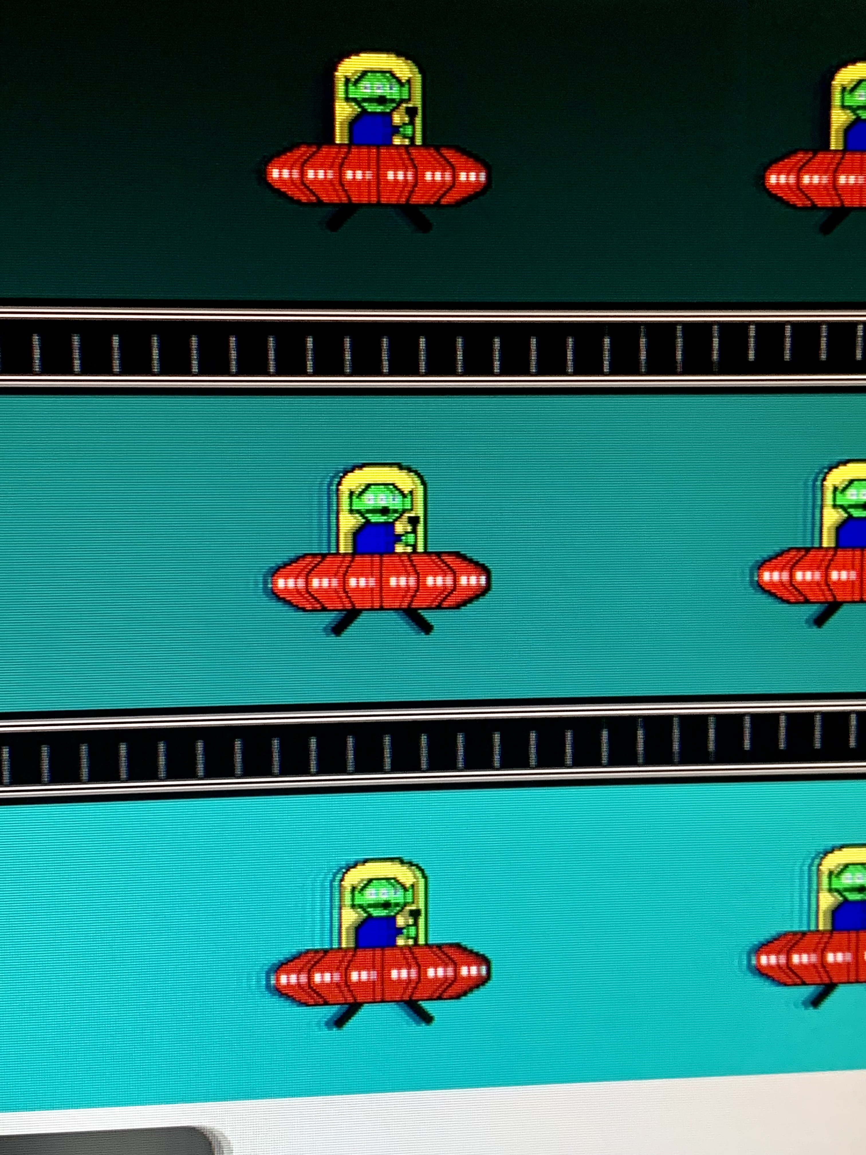

Post by Kosvill » 05 Dec 2022, 09:05
280hz 1440PPS

That will do the job. Thank you for doing these. I added them to database.
So Asus locked overdrive but not to aggressive level like on '9QM. Here it's the other way around, with not enough overdrive. They really don't know what they're doing hh.
For ELMB SYNC testing download latest version of Smooth Frog. Enable ELMB SYNC and Adaptive-Sync within OSD and inside nvidia or amd panel. Open Smooth Frog and quick test if VRR is working by using FPS Counter within monitor OSD, through Game Plus features. FPS should vary up/down as you change FPS limit slider in program.
In Smooth Frog leave vsync enabled for stability reasons. Use default pattern (Frog Pursuit, a bit bigger pattern than testufo) and stay inside pixel/frame panning type. Enable PCST (Sync Track) in menu (or with mouse wheel click). Now it will be best to do 280, 120 and 60 fps pursuits. Adjust panning speed until it reaches approximately 1440pps. Each framerate requires pixel/frame change. For 280 FPS it should be 5 pixels/frame (5*280=1400pps), for 120 its 12 pixels/frame (12*120=1440pps) and for 60 its 24ppf. Now do pursuits normally as you do. To start/stop panning use space key.
In the end it should look something like this. When I was doing these Smooth Frog didn't have proper Sync Track, but now it does.
Extra tip:
See if your camera can adjust shutter speed. For 280 use something closest to Hz/4 value. s1/70 for 280Hz, s1/30 for 120Hz, for 60 u can use s1/20 or s1/30 if your hands are too shaky.
Hopefully I didn't scare you with these instructions.
