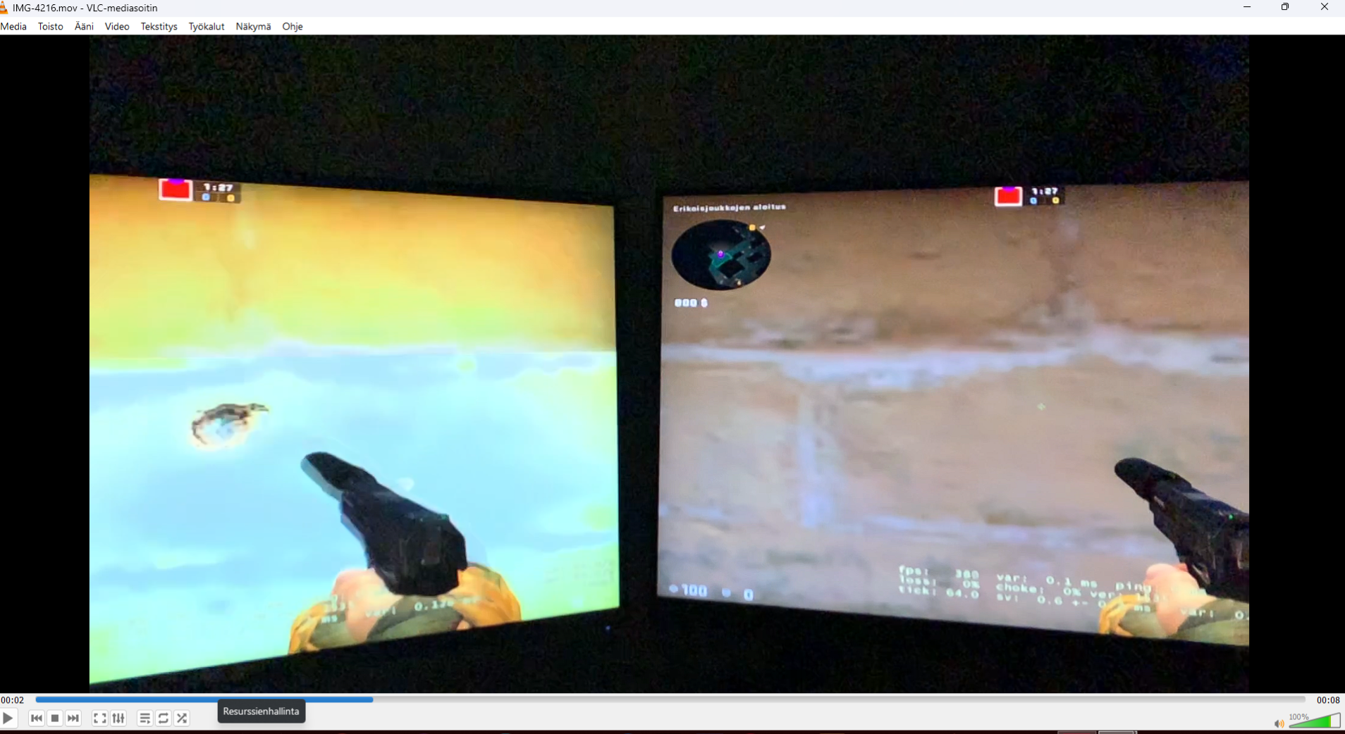

Post by Kosvill » 06 Dec 2022, 09:46
vg258qm vs x25f.png (1.63 MiB) Viewed 1900 times
VG258QM left, X25 f right
Both displayport copied image
Here is photo taken from iphone 240fps slowdown, opened with VLC media player and slowed down even further to so slow that i can see frame by frame. Both set 240hz, adaptive sync off, both on best OD recommended. I did same test with 58qm 280hz and X25 f 240hz result same. It isnt placebo, Asus has lower inputlag. I do later test so I turn off Vividpixel and Sharpness.
Retested sharpness settings off and Valorant. Same result. I can feel the difference so I bet it is more than Rtings results 2.4ms vs 2.6ms

Kosvill wrote:
06 Dec 2022, 09:46
On which OD the x25f is on?

Avi wrote:
06 Dec 2022, 13:06
Kosvill wrote:
06 Dec 2022, 09:46
X25 f OD 3/4 and VG258QM Level 3

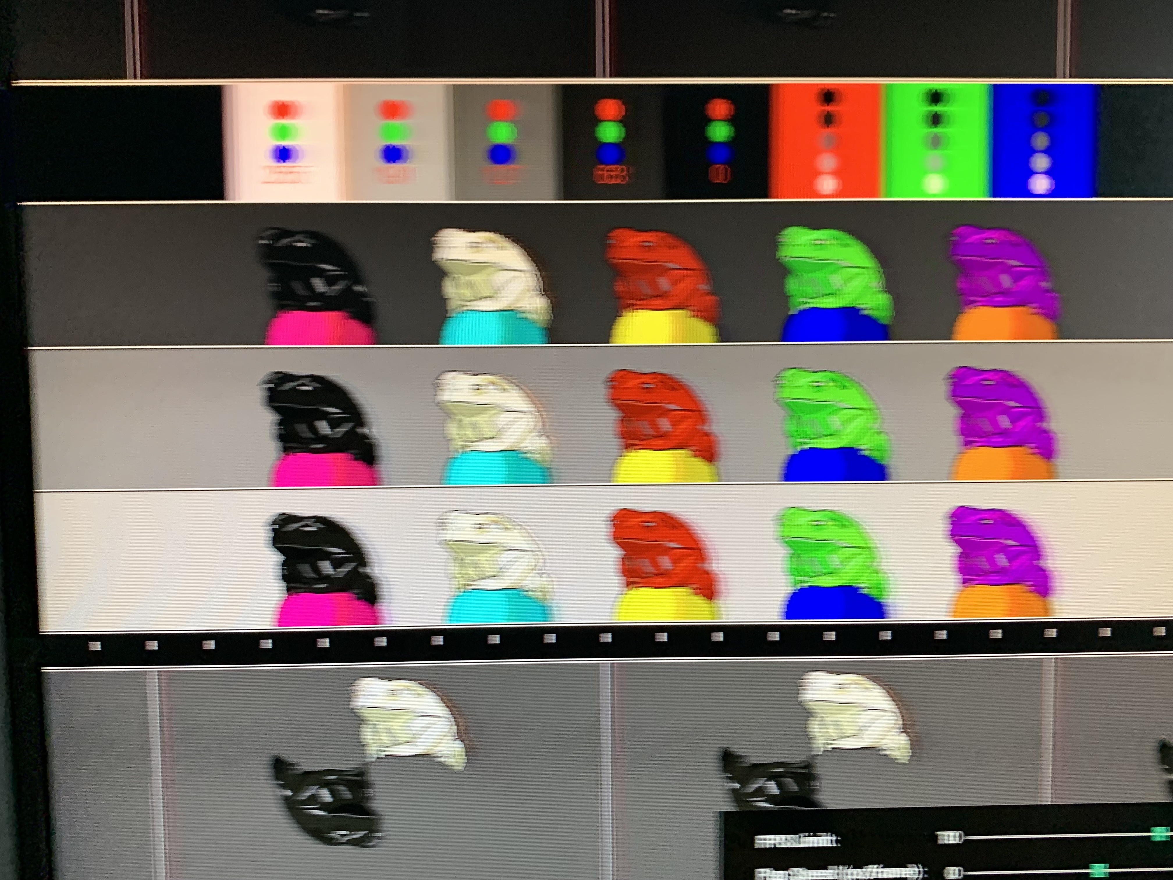

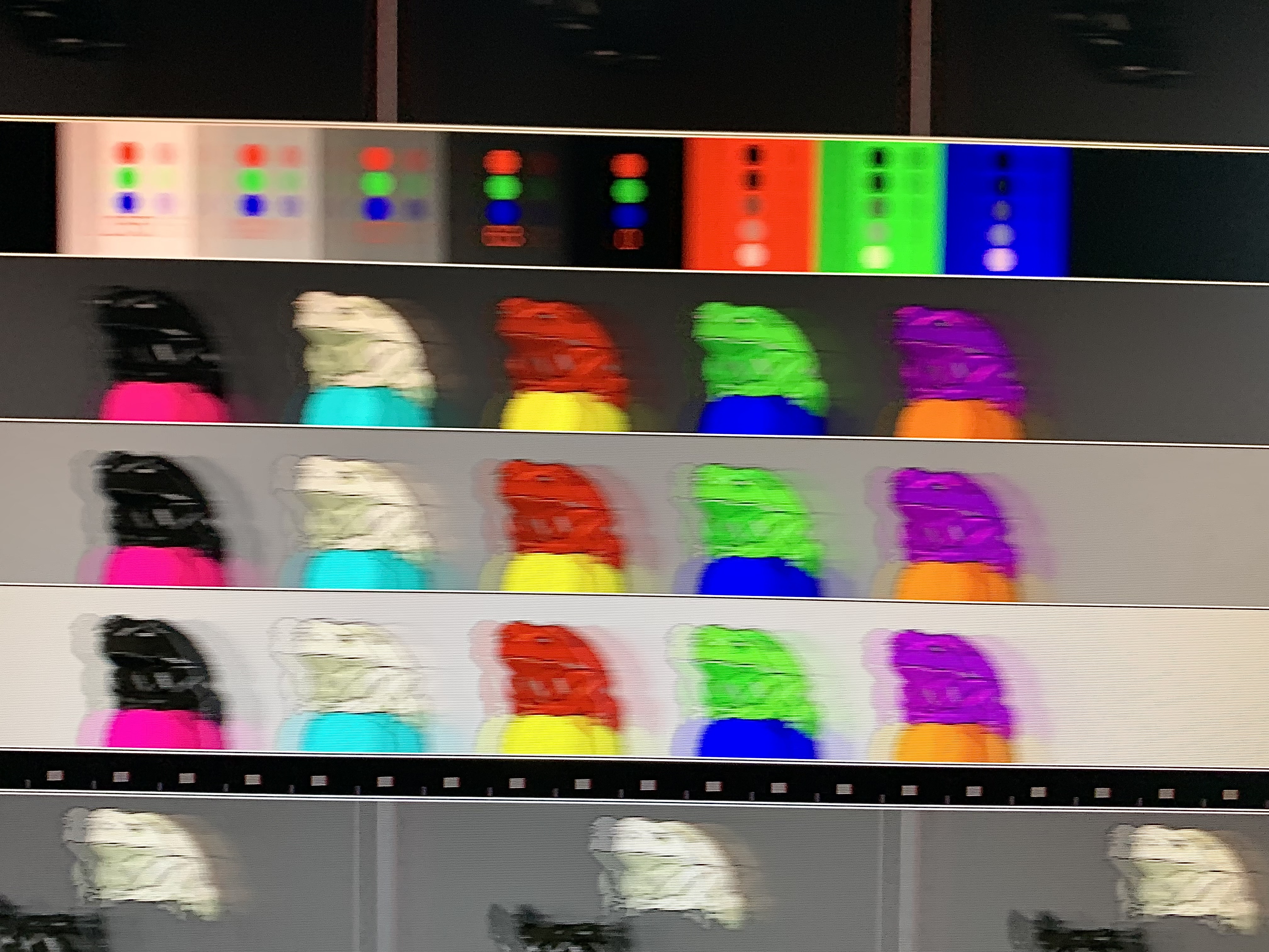

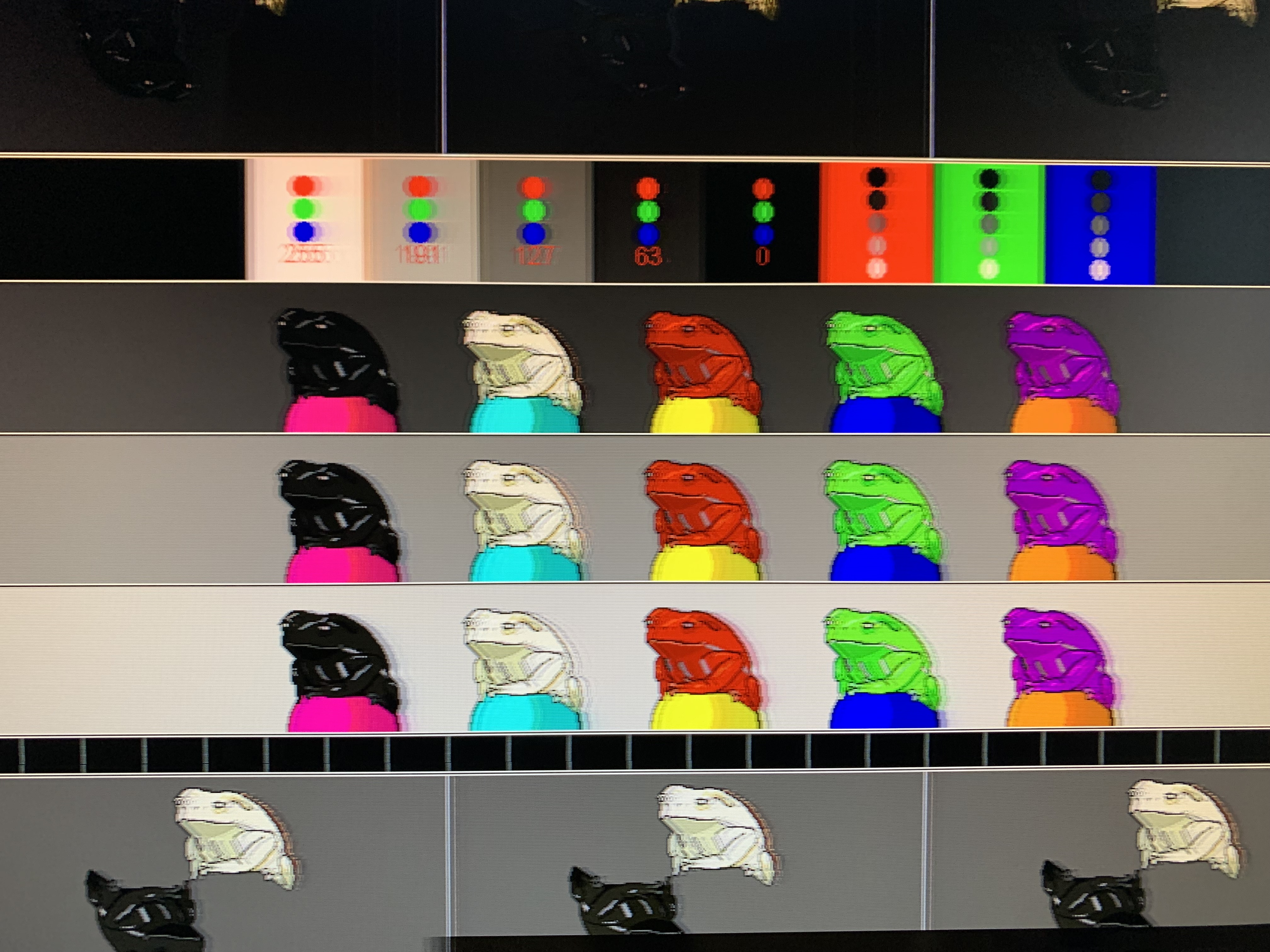

For ELMB SYNC testing download latest version of Smooth Frog. Enable ELMB SYNC and Adaptive-Sync within OSD and inside nvidia or amd panel. Open Smooth Frog and quick test if VRR is working by using FPS Counter within monitor OSD, through Game Plus features. FPS should vary up/down as you change FPS limit slider in program.
In Smooth Frog leave vsync enabled for stability reasons. Use default pattern (Frog Pursuit, a bit bigger pattern than testufo) and stay inside pixel/frame panning type. Enable PCST (Sync Track) in menu (or with mouse wheel click). Now it will be best to do 280, 120 and 60 fps pursuits. Adjust panning speed until it reaches approximately 1440pps. Each framerate requires pixel/frame change. For 280 FPS it should be 5 pixels/frame (5*280=1400pps), for 120 its 12 pixels/frame (12*120=1440pps) and for 60 its 24ppf. Now do pursuits normally as you do. To start/stop panning use space key.
In the end it should look something like this. When I was doing these Smooth Frog didn't have proper Sync Track, but now it does.
Extra tip:
See if your camera can adjust shutter speed. For 280 use something closest to Hz/4 value. s1/70 for 280Hz, s1/30 for 120Hz, for 60 u can use s1/20 or s1/30 if your hands are too shaky.
Hopefully I didn't scare you with these instructions.
I did this and followed your instruction. ELMB Sync wasnt available on 280hz so I should do the test with 240hz, 120hz and 60hz. Panning speed as close to 1440pps as possible. FPS counter showed changing FPS/HZ so I assume it worked. My bad Iphone camera faced too powerful enemy and these pictures are bad, Im sorry I couldnt offer better images. Frogs hurt my eyes and anything below 200fps looked pretty stressful to my eyes.
After testing my recommended settings for gaming with this monitor are: 280hz, Adaptive sync On, Variable OD Level 3, CRU VRR range 48-279hz, FPS cap 275fps on Rivatuner/in-game
ELMB Sync on, clarity position middle, Brightness 20, Contrast 80, Racing mode
240hz

Post by Discorz » 07 Dec 2022, 04:37
That will do the job. Thank you for doing these.
You managed to get good tracking accuracy for 240 fps shot.
Looks like '8QM is doing same devil's horns type strobe as '27/259QM. Btw you say clarity positon is middle, does this mean you can modify it with ELMB+SYNC enabled or only with ELMB (without sync)? Also what about clarity level? Is overdrive also modifiable or greyed out?
