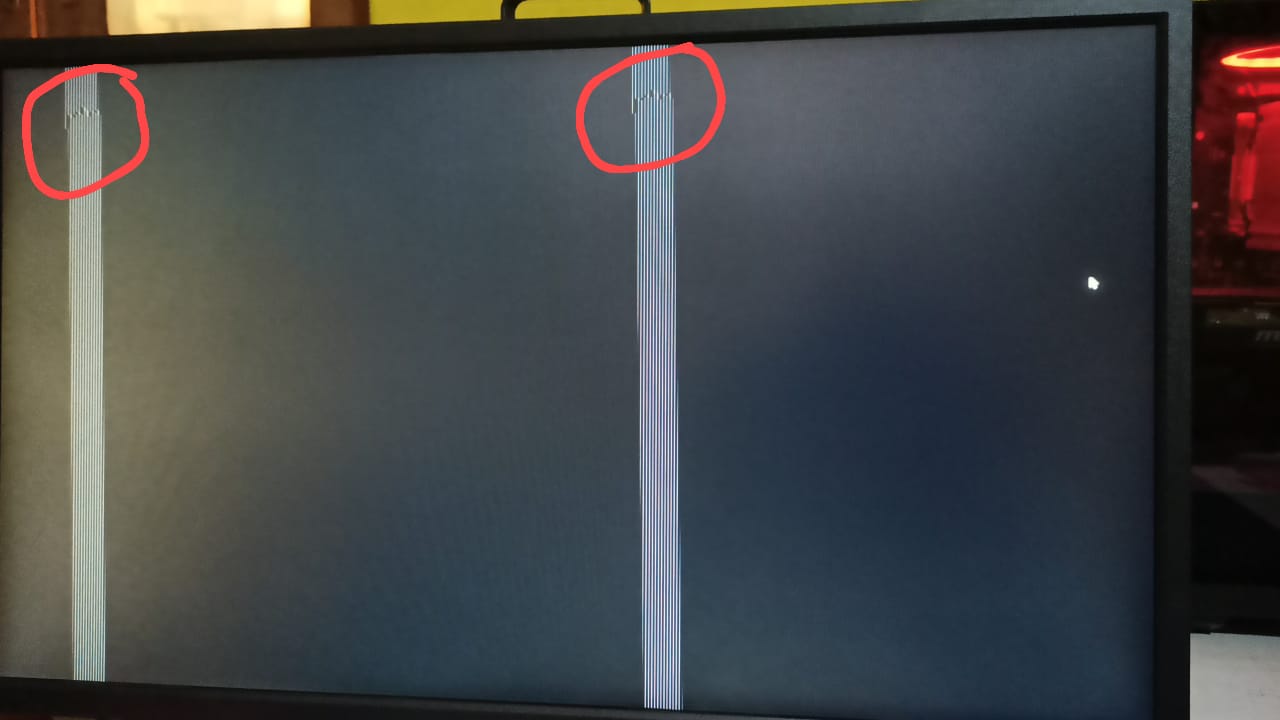

So i just purchased a new BenQ XL2546K and after testing it on the testufo website i found that under stutters and tearing test i dont get get complete straight lines which should be the case on ideal monitors. i have attached a video about this, please help.

You don't want to use testufo for these type of tests. "Stutters and tearing" is more for a preview/simulation rather than testing. I assume u used one of the non ideal demos instead of "Smooth (VSYNC ON)"?
For proper testing use any game or testing oriented game like Smooth Frog.

That specific TestUFO, while used as a demonstration of stutters/tearing, is showing abnormality: The tearing demo of TestUFO randomizes the location of tearlines throughout the whole screen.
So, try www.testufo.com/photo full screen. If you see tearing, then you've got VSYNC OFF forced for fullscreen in NVIDIA Control Panel. TestUFO is a VSYNC ON system, but browser fullscreen mode sometimes gets (partially) overridden by the sync technology configured in NVIDIA Control Panel.
