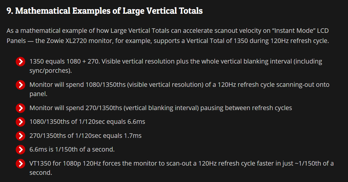

its very important, by default the extra porches are massive, like 10-30% above your monitor resolution.. Chief wrote a good post explaining it viewtopic.php?t=3248
so if your porches are 270px thats an additional 1.7ms of delay..
Posts: 12306
Re: ZOWIE XL2566K Discussion Thread [24.5" 360hz TN]
Post by Chief Blur Buster » 16 Jan 2023, 02:06
While large VTs can cause a backlight to strobe a bit earlier --
The sync technology configured also can yield further lag reductions. Microsoft Windows VSYNC ON does Present() at beginning of VBI, while lag reductions from QFT requires Present() to unblock at end of VBI. The most common workaround is RTSS Scanline Sync but Special K Latent Sync can do it too, to realize QFT lag reductions.
Basically unblock the frame presentation as late as possible, to allow the next input read to occur closer to the next VBI, reducing input lag between inputread and the GPU render that will be displayed to human eyes.
Also, QFT has no (averaged-out) lag reductions for unstrobed VSYNC OFF, since random tearing can occur anytime over the refresh interval (in VBI or out of VBI). So realizing lag reductions from QFT requires something that delays photon visibility (either the sync technology or the strobe technology, or a combination of both) will however hugely benefit from QFT (Large VT) tricks, via either earlier backlight flash (strobe tech) and/or more inputdelayed frame Present()-atation.
