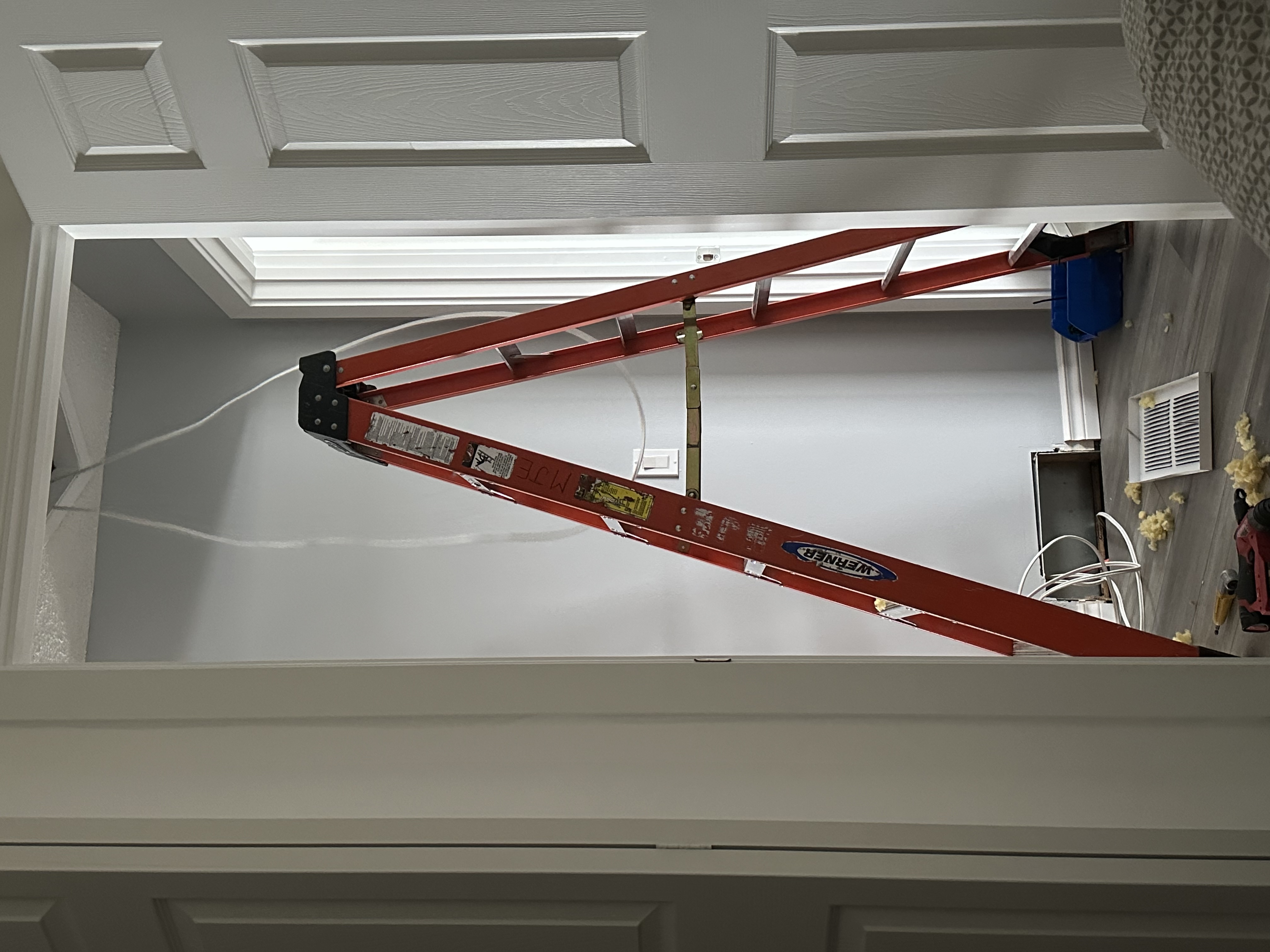

Today electrician was installing new outlet for my new laundry room. I explained to him my issue and he said that he has very expensive audio system at home that used to run with power conditioner, filter, you named it. He said the day he installed a dedicated circuit line in his audio room, everything changed and it’s also a set up that he recommends for his audiophile client.
Well since he his doing the laundry new circuit, he will install a new dedicated circuit for my office! Let’s see how it goes in few hours

The dedicated circuit did not work, Interference from the other circuit is still impacting this new circuit from the same panel. Now I guess I need to filter the power and make it clean!
