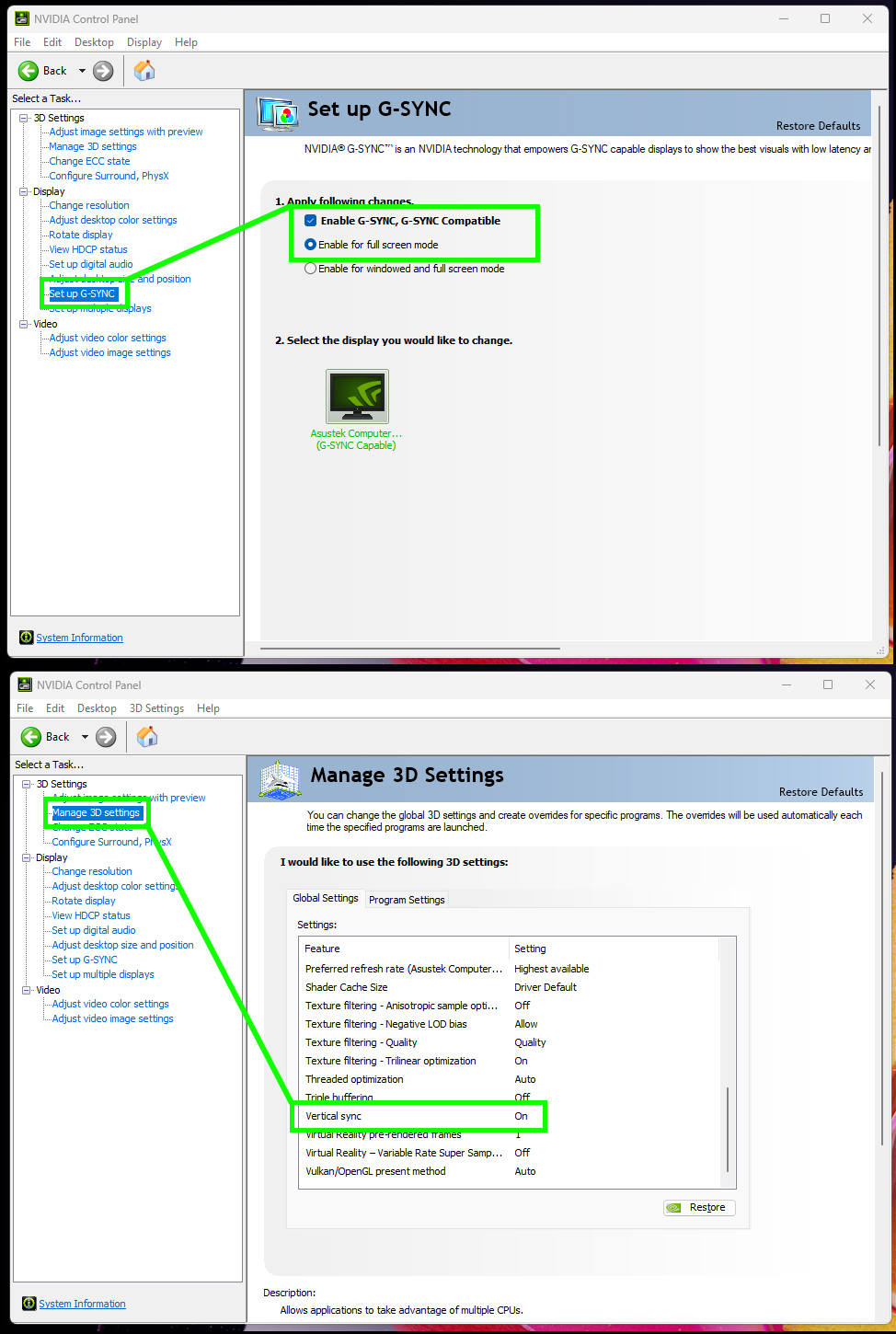

NVCP settings:

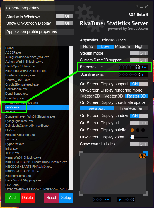

RTSS settings:

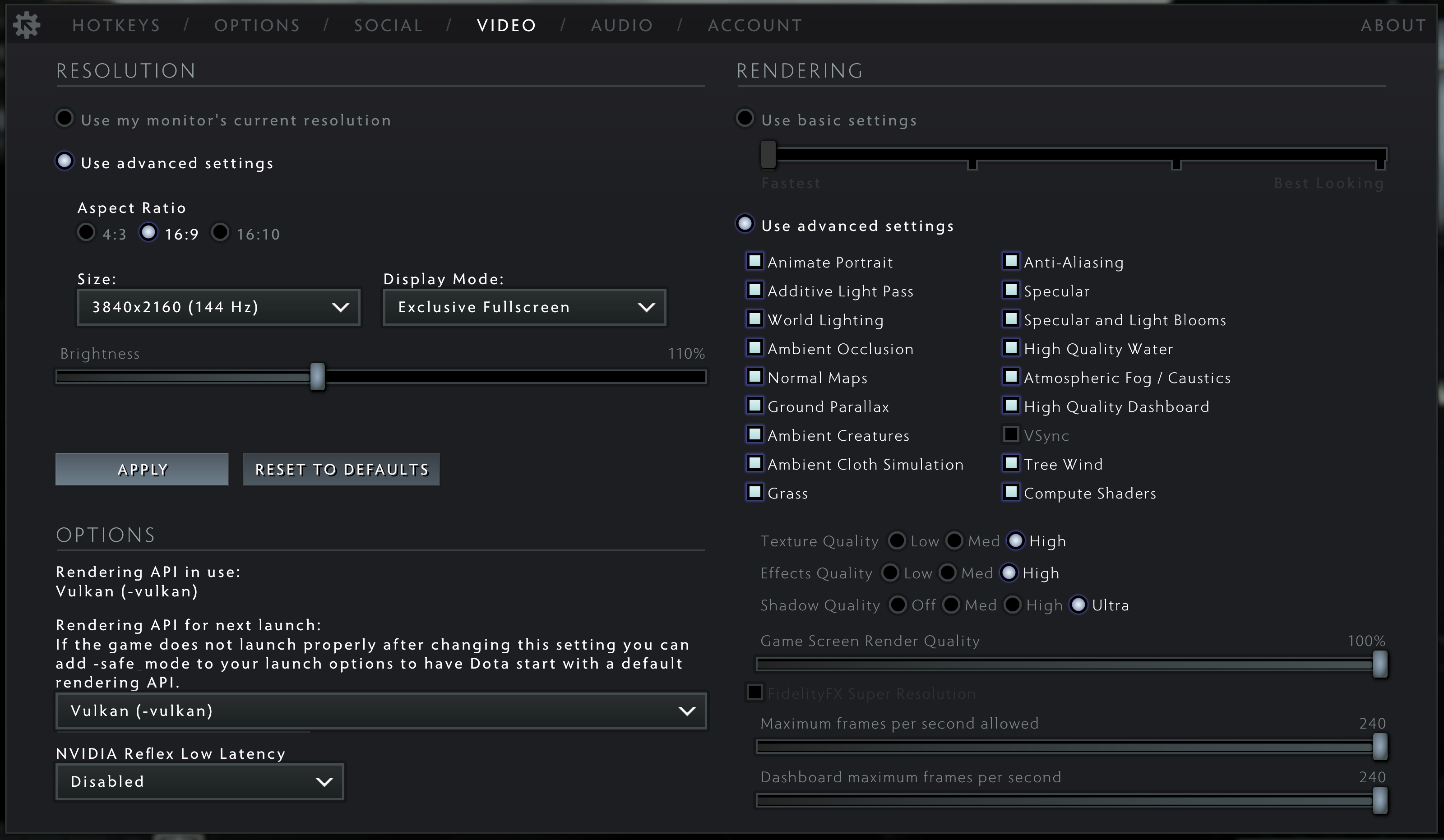

Dota 2 settings:
(I used the Vulkan API, which you can download in the DLC section for the game, along with OpenGL, but use whatever API works best for you and make sure it is the one selected and applied below instead. Also, you'll have to restart the game for it to take effect).
I did the above, only at 1440p 240Hz with a 224 FPS RTSS limit, and I had no noticeable stutter when moving or panning the camera, with only minor expected frametime variances on an occasional basis.
