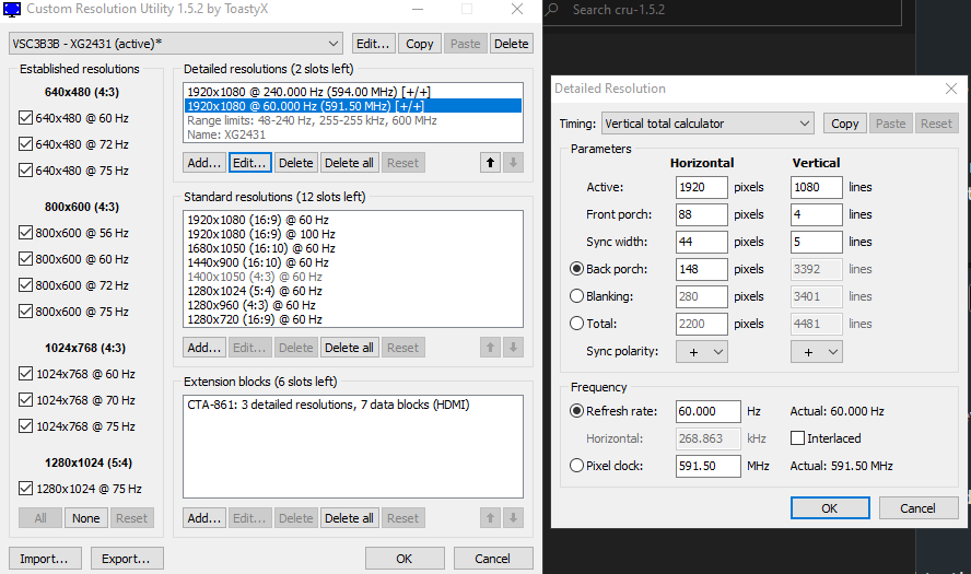

I followed the guide step by step, total vertical doesn't change. It's always 1125. I wanted to try sekiro 60hz.
Tried 239hz instead of 240. Now it shows 4481 vertical total on 60hz. Btw display was set @10bit on amd software. I read somewhere that this display is 8bit I don't why it detects it as 10bit.
Tried to do 120hz didn't work either so I selected 119hz instead of 120hz and then selected 119hz on windows setting it worked that way.
This solved crosstalk top side of the screen and other spots as well @119hz. 2259 vertical lines on strobe utility. I am still testing but this is really amazing no more distractions and eye hurts.
I am still not sure how it worked. Was having black screen like you guys while trying to get 60hz strobe. Try these exact settings, see if it works for you.
- Screenshot 2023-03-21 162953.png (69.24 KiB) Viewed 13482 times
