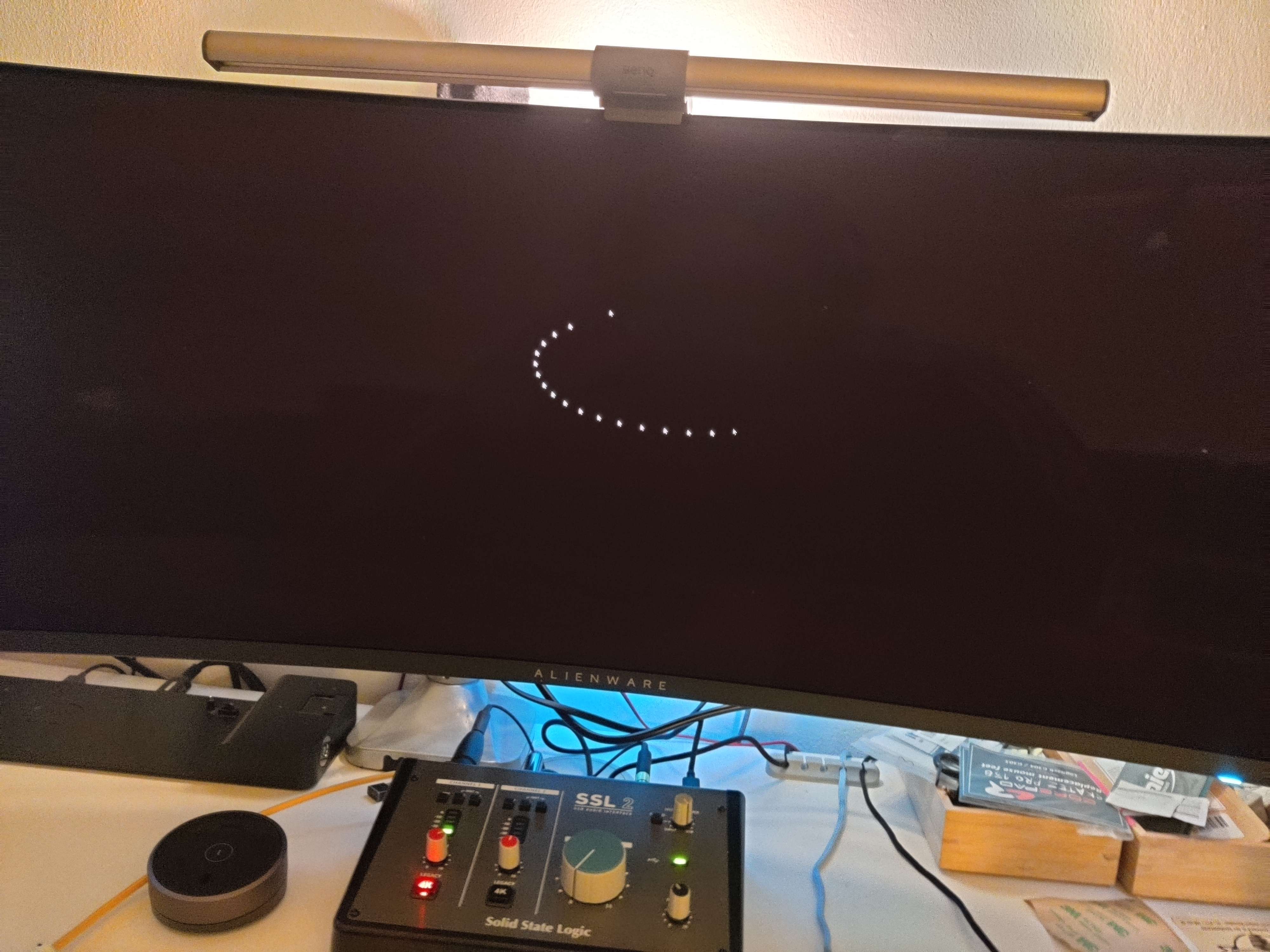

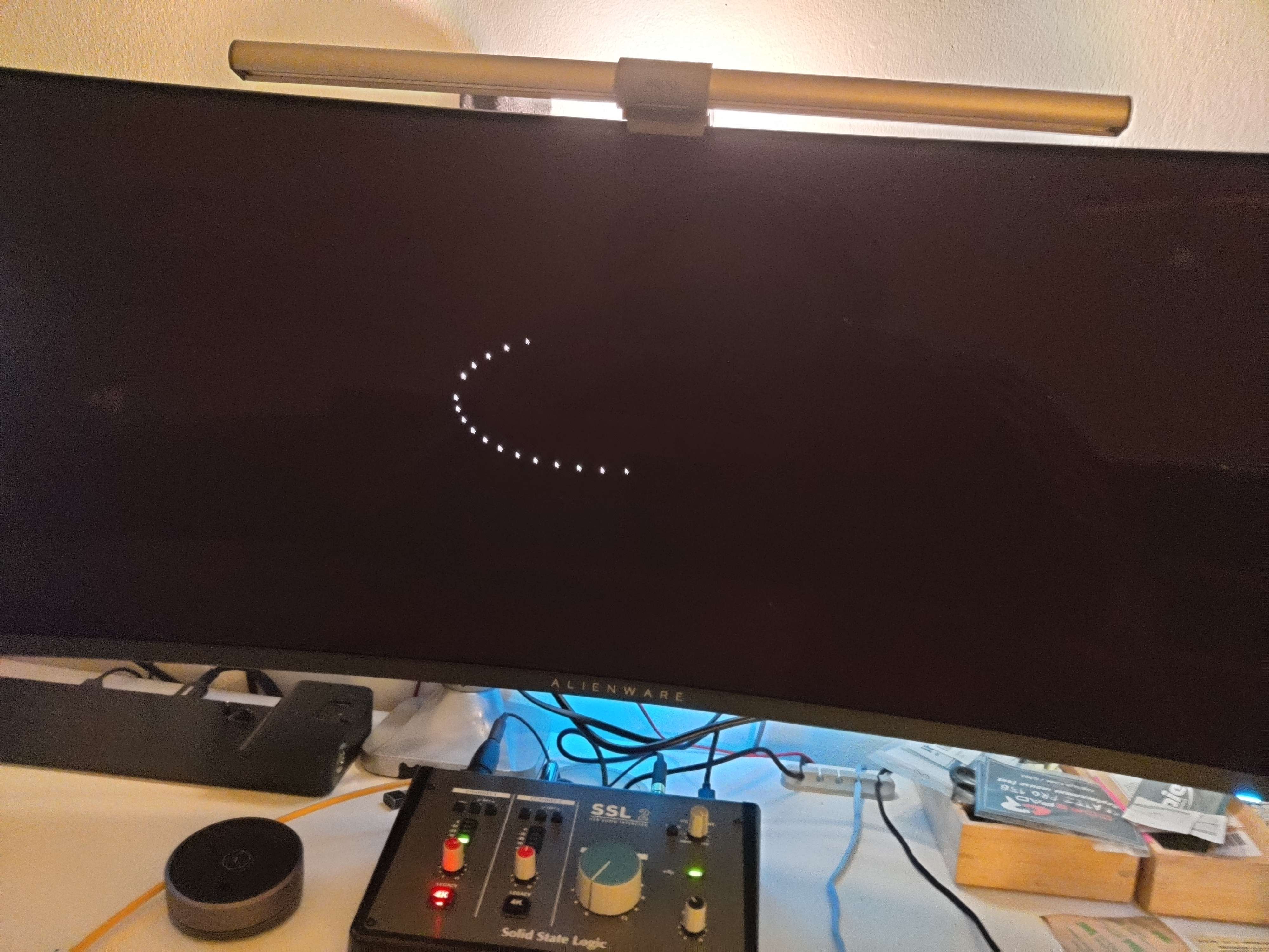

i suddenly discovered that moving my mouse around on my black monitor has gaps in the mouse trail wtf is happening ?

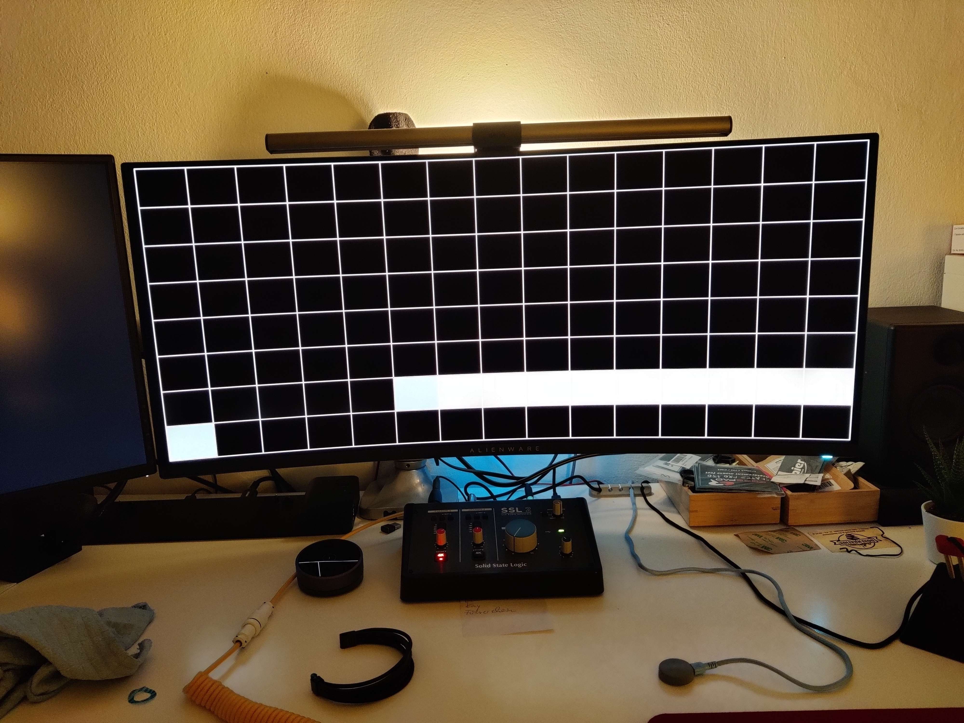

reinstalled the driver, unpluged the monitor.... cant seem to fix it .... weird thing is i don't notic those gaps at 144hz though at 175 they are clearly visible all of a sudden. I thought its maybe frame skipping but all fotos i took with my phone showed nothing skipped.
i also tried to test with mousetester, but it doesnt sow any massive skips i'd recognize either
what the hell is this ?

Look simply like the "Stroboscopic Effect" to me:
https://blurbusters.com/the-stroboscopi ... -displays/
If so, there's nothing to "fix."

It will require above 10,000 fps at 10,000 Hz to completely eliminate this effect, unless you wish to add intentional GPU-effect motion blur (one frametime of motion blur).

I would definitly have noticed this, if it were norm. The gaps were not there before !jorimt wrote: ↑16 Mar 2023, 22:39Look simply like the "Stroboscopic Effect" to me:
This explains the mouse trial by itself (really nice read btw!) but not where thos gaps come from.Chief Blur Buster wrote: ↑16 Mar 2023, 23:58It will require above 10,000 fps at 10,000 Hz to completely eliminate this effect, unless you wish to add intentional GPU-effect motion blur (one frametime of motion blur).

Im on relatively fresh install (2 days old) and i also can remember having this issue some time ago on my old 240hz g7 before. But back then it was fixed by some easy steps like switching the refresh rate or replugging stuff. this definitly was not there 18 hours ago
was my guess also, but it persists even with an old wired mouse. What seems really strange to me is that its only happening on 175hz and not on 144.... enhanced sync, vrr, vsync, framerate cap nothing seems to affect itRealNC wrote: ↑17 Mar 2023, 06:00Does this bigger gap happen only after you haven't moved the mouse at all for a while? If yes, it could be due to USB power saving mode. Search for "USB selective suspend" and how to disable it. Worth a shot to see if it's indeed the problem.

Make sure you don't have frameskipping at www.testufo.com/frameskipping ...
What Hz is your mouse? Increasing mouse Hz can help.
Erratic gaps can be a jitter effect between mouse Hz and display Hz.
(Latter is from a research paper - https://dl.acm.org/doi/10.1145/3472749.3474783

im at 4k Hz, i took like 20 fotos with the frameskipping test yesterday night and no skipped frame.
i think that If it were microstutter from the mouse it should be:
1.) fixed by either changing mouse, or switching the hz on mouse, but neither does fix it.
2.) it should persist on 144hz aswell but doesnt
its also noticeable in fullscreen games e.g Starcraft Broodwar (don't judge me im an old man).
Hmmmm im considering reinstalling now, to see if that fixes it :/
but before il tweak around a little more and gonna report back ¯\_(ツ )_/¯
Thx for the input and help ! if you guys have any more suggestions don't hesitate to drop them, im open for everythign aslong as it doesnt involve soldering

Re: Weird "Mouse Trail" issue
my second monitor is my old pg279Q which is overclockable to 165.
Turns out when il go to 165hz its visible on that one aswell + bonus of my distorted woman
but why is it fine at 144hz ... oO ...gonna read that paper now that u provided chief, thank you !
