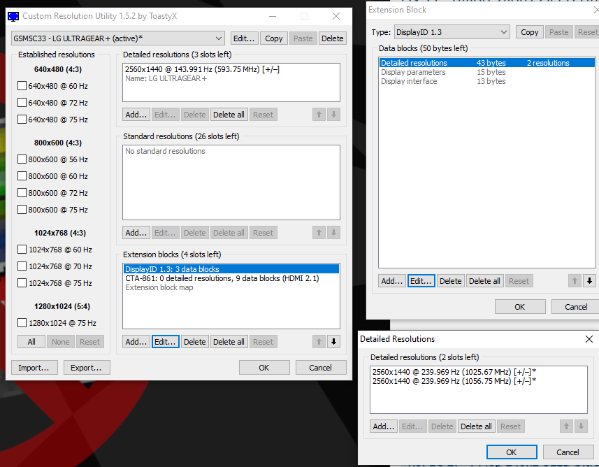

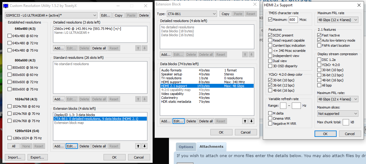

What's the best settings for the CRU utility?
How do I know the profile is active? Where to check it?
How do I know it's running 10bit or 12bit? I can only see at nvidia panel.
Attached are the settings I'm using but I'm not sure games and window is using it.
