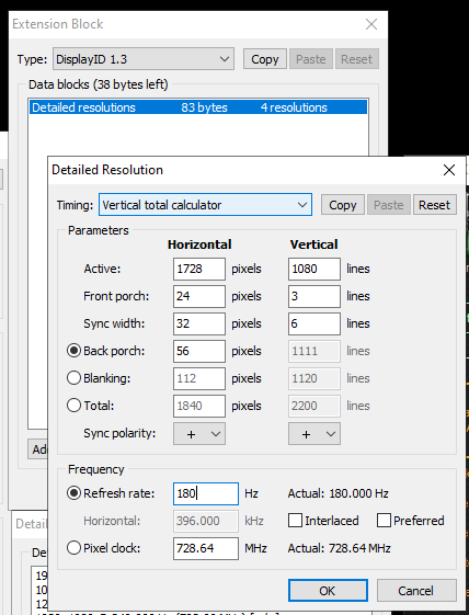

extract reduced preset 1728x1080 / 360hz before use Vertical Total Calculator 180hzdaviddave1 wrote: ↑24 May 2023, 02:44Hello everybody,
I hope this dont come off as a lazy question but I was wondering If someone could point me in the right direction in setting up CRU for a 180 fps 1728 x 1080 resolution on the Zowie XL2566K . Should I just use the ToastyX CRU Vertical Total Calculator for Quick Frame Transport (QFT) as in viewtopic.php?t=10402 and call it a day? I am a noob to CRU. If the ToastyX CRU Vertical Total Calculator for Quick Frame Transport (QFT) is not the answer; can someone please give me a example of the data I can use when I put the timing on Manual for a 180 fps 1728 x 1080 resolution?

- 1728.PNG (25.64 KiB) Viewed 14519 times

ty!! appreciated !!Slender wrote: ↑25 May 2023, 00:42extract reduced preset 1728x1080 / 360hz before use Vertical Total Calculator 180hzdaviddave1 wrote: ↑24 May 2023, 02:44Hello everybody,
