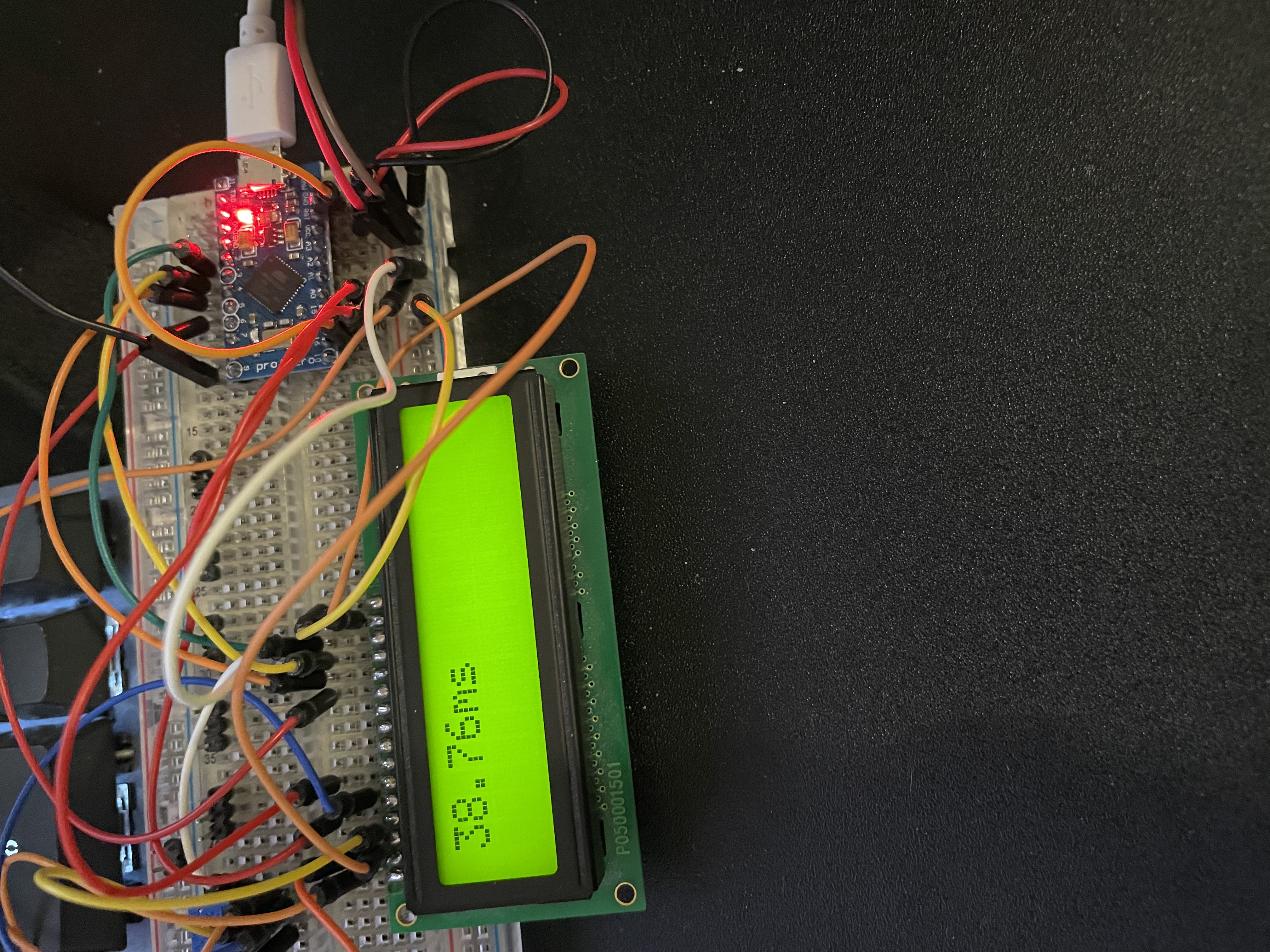

Wire77
- Posts: 3
- Joined: 15 Jul 2023, 16:45
Re: DIY Arduino Latency Tool
Added a LCD Screen
- IMG_0254.jpg (3.22 MiB) Viewed 14006 times
- IMG_0252.jpg (3.21 MiB) Viewed 14006 times
Wire77
- Posts: 3
Love this DIY Arduino Tool, I added a lcd screen so I don't have to use serial monitor

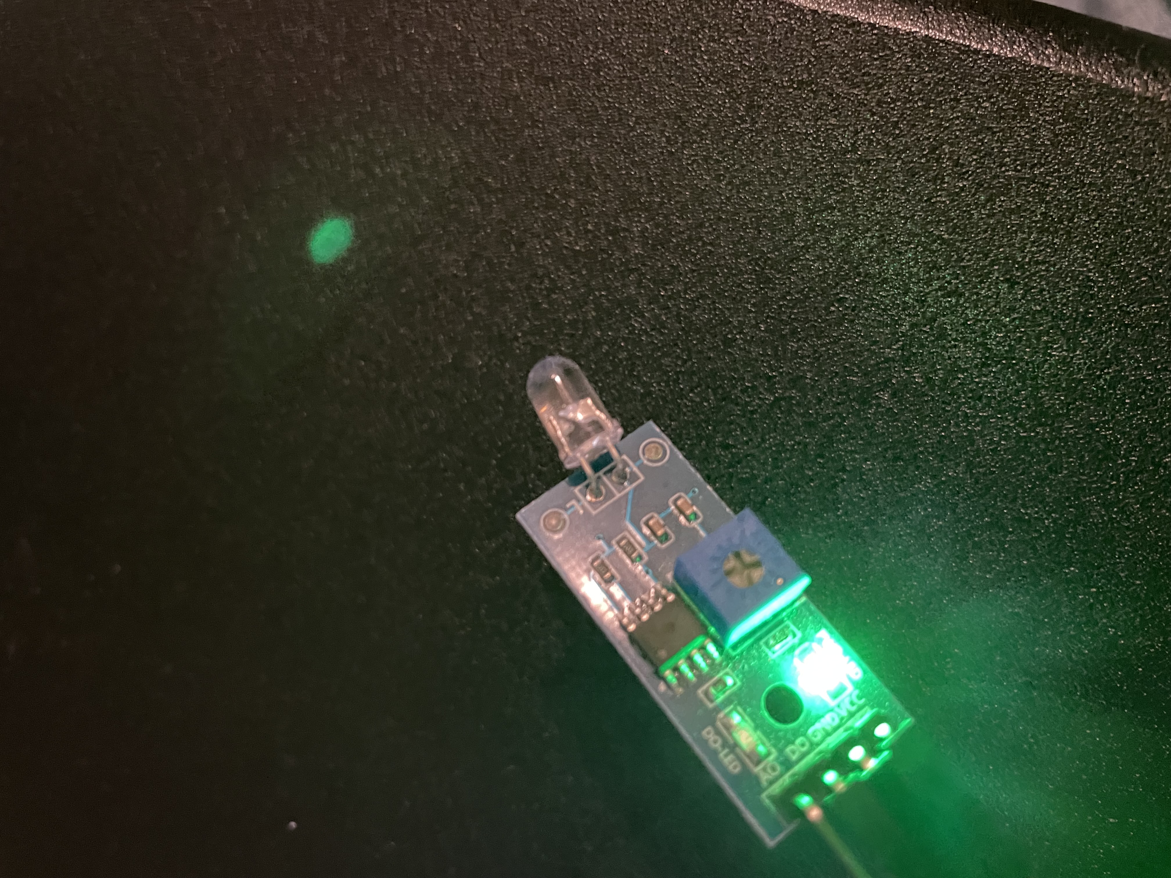

Hey, I just randomly stumbled over this post. I build the same tool myself. There are only 3 concerns with your setup.
1. You're using a photo resistor. There is a second variant of this LM393 light sensor, which has analog output and a photo transistor, instead of a photo resistor. Using a light transistor should give slightly more accurate results.
2. You're not fully shielding the sensor from ambient light. You could use tin foil to shield the sensor.
3. Your code doesn't have a dynamic light calibration. That means you always have to re-adjust the potentiometer, depending on the ambient light, monitor brightness etc.
I actually used your code and modified it to include a calibration method, so ambient light won't disturb the tests. Also, I switched from digital signals to analog signals, which made this even possible.
Here is the optimized code (only works with the Analog LM393 Light Transistor):
