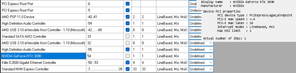

I have tested further, and it turns out that my NIC driver cannot be set to limit 1 or put into legacy mode. Whenever I disable MSI Mode on my NIC, my internet is completely off (Error Code 10). Did you ever have problems like this before?.

Press Apply and restart PC. I suspect realtek audio could be another device that works best in legacy but haven't tested this idea yet.
EchoGhost wrote: ↑
29 Aug 2023, 04:43
I looked up error code 10 and it's an indication the driver isn't working. It's possible your NIC does not support legacy mode, or the drivers might need to be reinstalled or rolled back. My NIC is only pci-e x1 speed and was "designed" into a board with all pci-e 3 and 4 components, so it makes sense for legacy mode to work better in this case. CSGO is also running on an 20+ year legacy engine, which could be another reason legacy settings could work better. Running 'ipconfig /flushdns' in command prompt as Admin helped restore connection when my drivers weren't working correctly.

Post by imprecise » 31 Aug 2023, 03:15
I found Legacy devices are listed as "PciExpressLegacyEndpoint" in MSI Utility under device type. I'm now testing only the 3 devices that have this designation as Legacy. NIC was not one, so I'm currently testing with it on MSI and will check back on it later. So far the results seem promising.
Edit:
This did not work out well at all. Testing in CSGO FPS was dropping to 300s and 200s, and then the computer completely locked up. The NIC lag also returned, so I switched back to everything MSI and NIC legacy.
