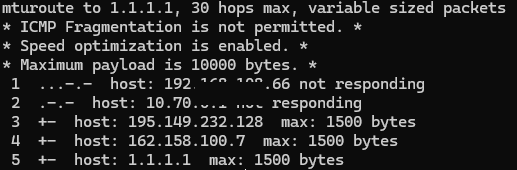

kvix9r wrote: ↑
02 Nov 2023, 12:47
Thanks, yes I've noticed that too. But other than that everything else seems fine or at least in my perception.
#1 and #2 are my own routers. I am not sure what #3 is?
#1 is a router with openwrt, I should be able to configure it to use MTU 1452
#2 is a fritzbox connected with VDSL2 WAN and I am using it for Wifi. Not sure if MTU is configurable, I think they have an automatic way to deal with fragmentation.
Also what is "Speed optimization is enabled."?
I've set it up to 1452, new result:
How to set It up with different values man? Is there a command to set up mtu?

skkiNN wrote: ↑
03 Nov 2023, 08:55
Most likely it depends on your router. It should be somewhere in the settings for the WAN interface / Internet access settings.
You should check the manual of your router it may be explained there in detail.

skkiNN wrote: ↑
03 Nov 2023, 11:15
https://ibb.co/3dg8THT
this is mine guys... is it bad? "no response from traceroute for this TTL"
No it's OK even if you have no response from some routes, it just means they have ping dropped/filtered. The point is to have the same from the first till the last which you do. The 1492 is because ur provider is using PPPoE authentification. I'm just looking for people with clean 1500 to see if they get the same error that's all. Anyway it's better than most of us who have lower values. Valve network admin recently said the problem lies with packets exceeding MTU values of connections so...

agstrato wrote: ↑
04 Nov 2023, 19:59

Hey, I've been having these problems "bullets disappearing, enemies moving unnatural" since day one. The problem comes and goes. When it comes to mturoute, two first hops always show as "not responding", is that ok? I didn't check for the error in the console, but I will do it tomorrow and will let you know. Did you find out anything interesting during your reasearch?

Not an issue, first hop is not responding because its firewall is dropping icmp requests. The second IP is also some local address. Common setting to prevent icmp floods. Smarter config is to drop only excessive requests (typically - drop any more than 1 requests per second, however this wouldnt help for relatively aggressive mtu icmp request nevertheless).
MTU seems fine. Issue may be caused by different source?
