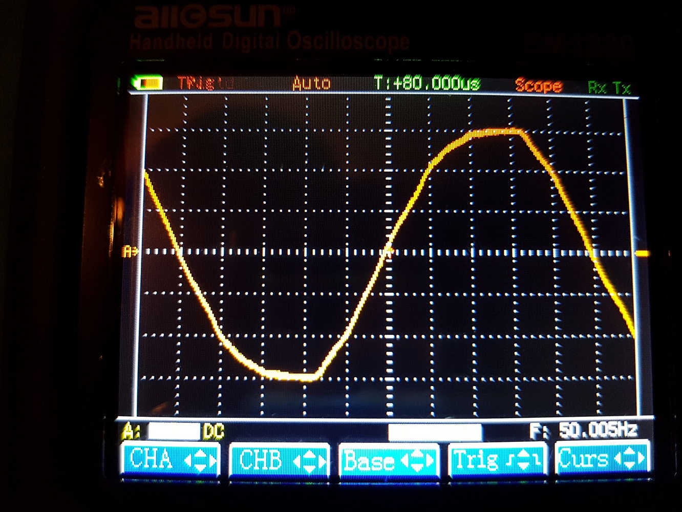

Okay, great info. Can you please tell me if a balanced toroidal transformer aligns a sinusoid?
It happens that there is a sinusoid curve in the electrical network and it causes an input lag.

A good switched-mode power supply has electronic systems that should eliminate the harmonics to some extent so I don't know as long as you will not check the signal behind PSU or track any rectangular signals (those responsible for all 0 and 1) for interference. You can measure interference in your mains but it can be eliminated or not depending on the nature of interference (frequency, power, amplitude etc.). The question is what do you need to eliminate it. In some cases only ferrite clams can be enough, for some solar panels.
BTW toroidal transformer is basically isolation transformer (but with 1:1 ratio). The problem is, that this type of transformers designed for lets say 300VA and more have high starting current so you need soft start system.
