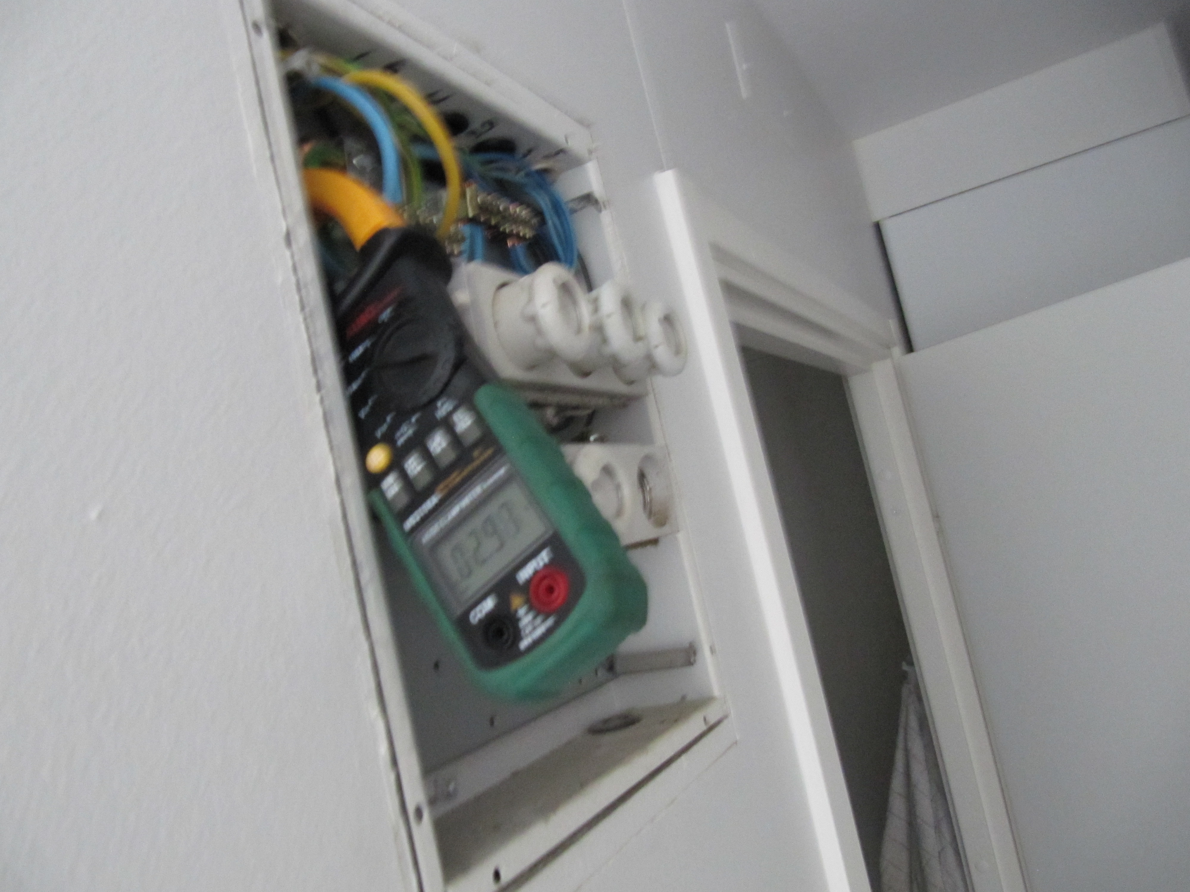

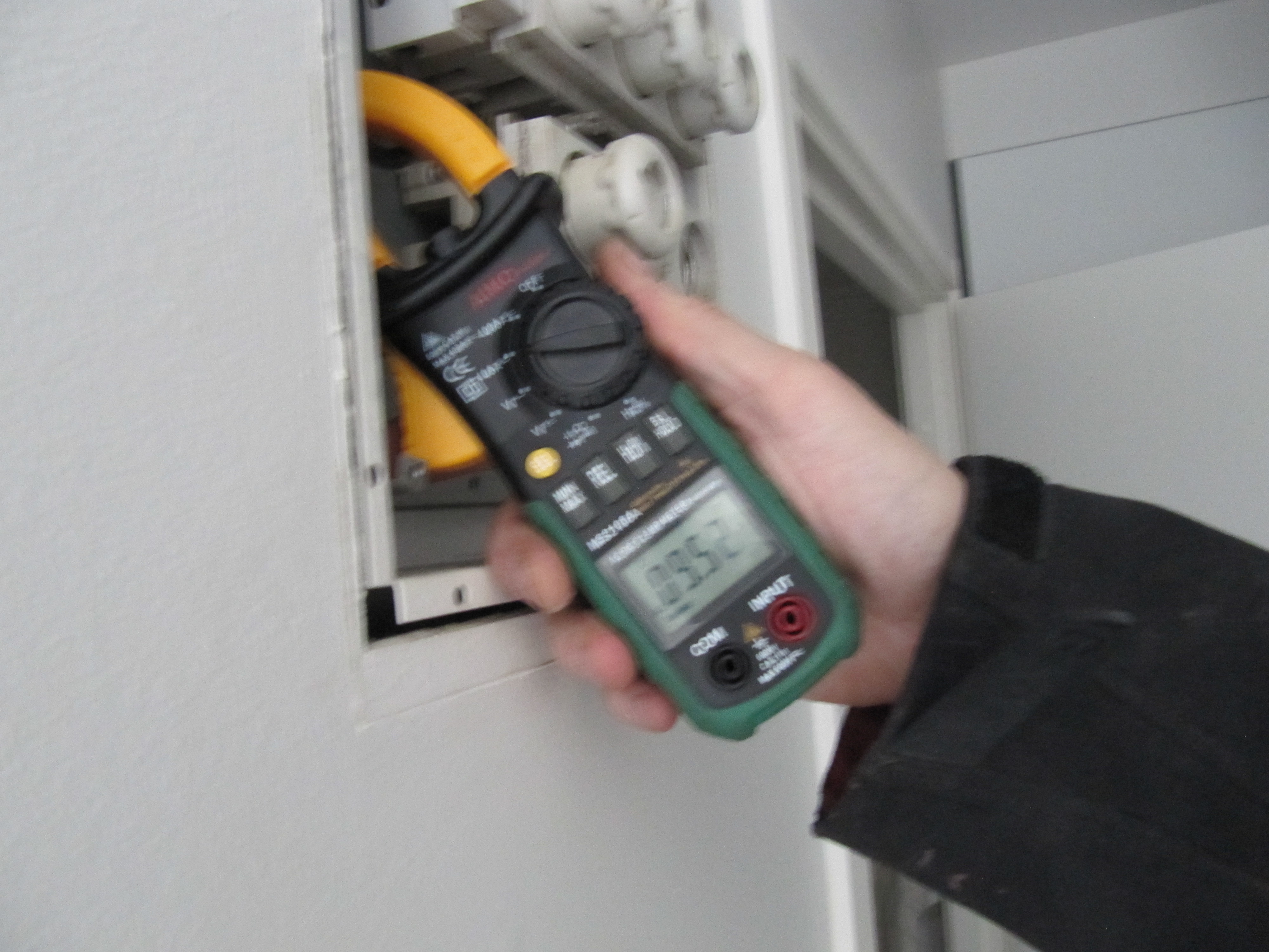

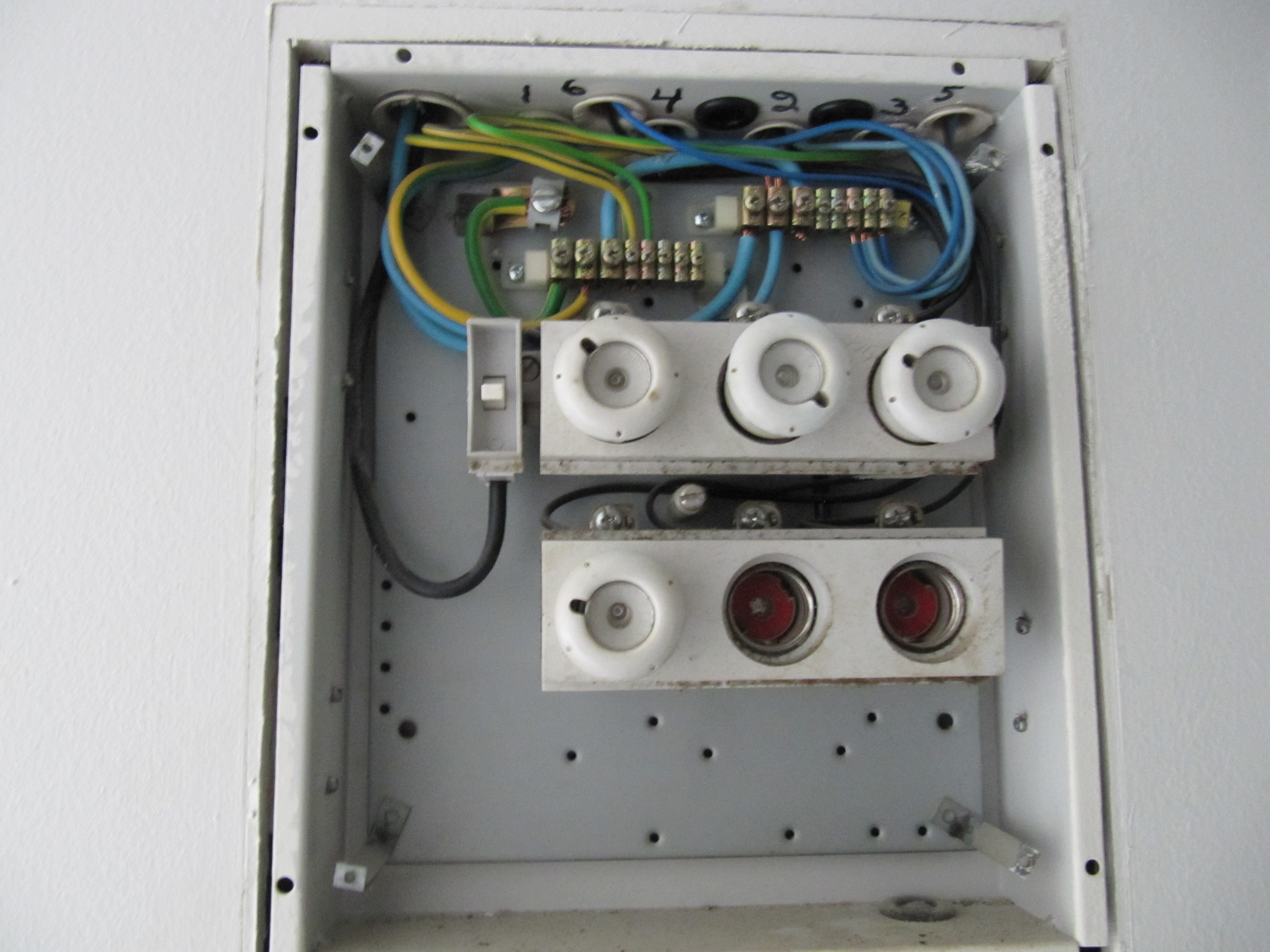

With the electrician, we measured the currents (oven on) from the (sub)panel of the apartment. We measured about 9.52 amps at the input (hot) and about 2.97 amps at the output (neutral).
The currents must always be balanced and the same amount of current must always return from the output (neutral). The return current (output neutral) should be always be the same.
Where did the rest of the current go?
We couldn't measure all the wires because we didn't have a small enough clamp amp. Let's assume in this case that most of the current went to ground wires (can also go to structures). Something is wrong with my panel. I just don't know yet what.
Blue wire = Neutral
Black wire = hot
Green/yellow = ground
- Output (neutral) 2.97 amps
Electrician measuring - IMG_1002.JPG (2.37 MiB) Viewed 15360 times
- Input (hot) 9.52 amps
Electrician measuring - IMG_1003.JPG (2.29 MiB) Viewed 15360 times
- My aparment subpanel
- IMG_0999.JPG (2.44 MiB) Viewed 15360 times
