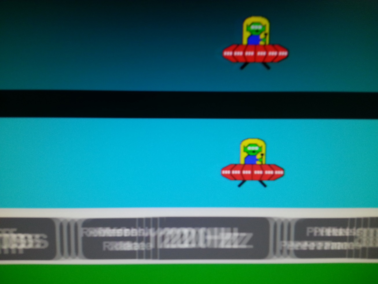

For comparison, you can see how extremely minor the Asus is...

Falkentyne
Posts: 2805
Joined: 26 Mar 2014, 07:23
Re: Cannot get CRT clarity. Custom Res etc tried
Post by Falkentyne » 14 Jul 2014, 14:58
Your replacement monitor will be the same.
BTW you can lower the ghosting to a more acceptable level (reduces it by about half intensity) by setting contrast from 50 to 40.
If you compare it by using profiles on the S switch, while the top of the screen doesn't 'change much, you do see the bottom area become about 50% more transparent on the inverse images (quite noticeable). This actually makes a lot of sense; one thing chief blur buster said to do on the Asus 24" (even more so for the 27" VG27H/HE, which always has more ghosting than the 24") was to reduce the contrast (which also tones down the lightboost pink tint slightly, and reduces ghosting even more), and the Benq also responds favorably to that).
The 24" should always have less ghosting than the 27", but regardless, Asus tracefree simply works much better than AMA. Benq needs to completely redesign their AMA; there's no reason why on the SAME exact panel (24" AU for both) that AMA should look that much worse than tracefree.
Do keep in mind that you can not adjust colors, contrast or gamma in lightboost. While the Asus motion blur clarity looks almost like a CRT, the contrast ratio and color accuracy take a MAJOR nose dive compared to the Benq's BR. Some people even stopped using lightboost because the image quality became so inaccurate and the colors so muted. So at the moment, the ONLY way to have your cake and eat it too is to use the Eizo screen.
Asus REALLY should have included their own fully tweakable 60-144 hz strobing on their new gsync screens with their adjustable tracefree...they would have had a slam dunk...(ULMB still locks the settings).
