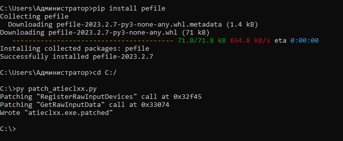

F1zus
Posts: 198
Joined: 07 Nov 2022, 17:59
Re: [Radeon+MouseHz Interference] atieclxx calls GetRawInputData causing mouse jitter - patched w/ python!
Post by F1zus » 14 Mar 2024, 16:00
Aeodyn wrote: ↑
13 Mar 2024, 19:04
F1zus wrote: ↑
11 Mar 2024, 05:43
Okay, I followed the instructions and still got an error with the wrong file name or something. atieclxx.exe and your script were in the same folder.
I updated the OP with more detailed instructions; lmk how it goes.
Okay, I followed the instructions and actually managed to patch the file.
It looks like it worked.
Three files with atieclxx.exe were located in the folder
Code: Select all
C:\Windows\System32\DriverStore\FileRepository\u0400567.inf_amd64_e8b6b2335bcb3cef\B400391
and
Code: Select all
C:\Windows\System32\DriverStore\FileRepository\u0400567.inf_amd6 4_e8b6b2335bcb3cef\B400392
and
Code: Select all
C:\Windows\System32
Replaced these files using totalcmd.
I'm using 24.2.1 Radeon ID driver mod. System - win11 22631.3296.
CPU - amd 5600, 4.6 GHz fixed.
RAM 3800cl14.
So I played about an hour with bots and a couple of matches in CS2.
I feel like the mouse's movements have become sharper and smoother.
It feels like I have double vertical sync enabled :). But I already play with vsync + freesync for the smoothest image and stable mouse sensitivity.
Unfortunately, I cannot measure the mouse polling rate using MouseTester, because when the mouse cursor moves outside the program window, the results become incorrect. It shows me 200000Hz and similar nonsense.
So I need to quickly move the mouse cursor in a small program window, this is difficult and incorrect.
PS: Thank you for the important script. I will continue to test further.
