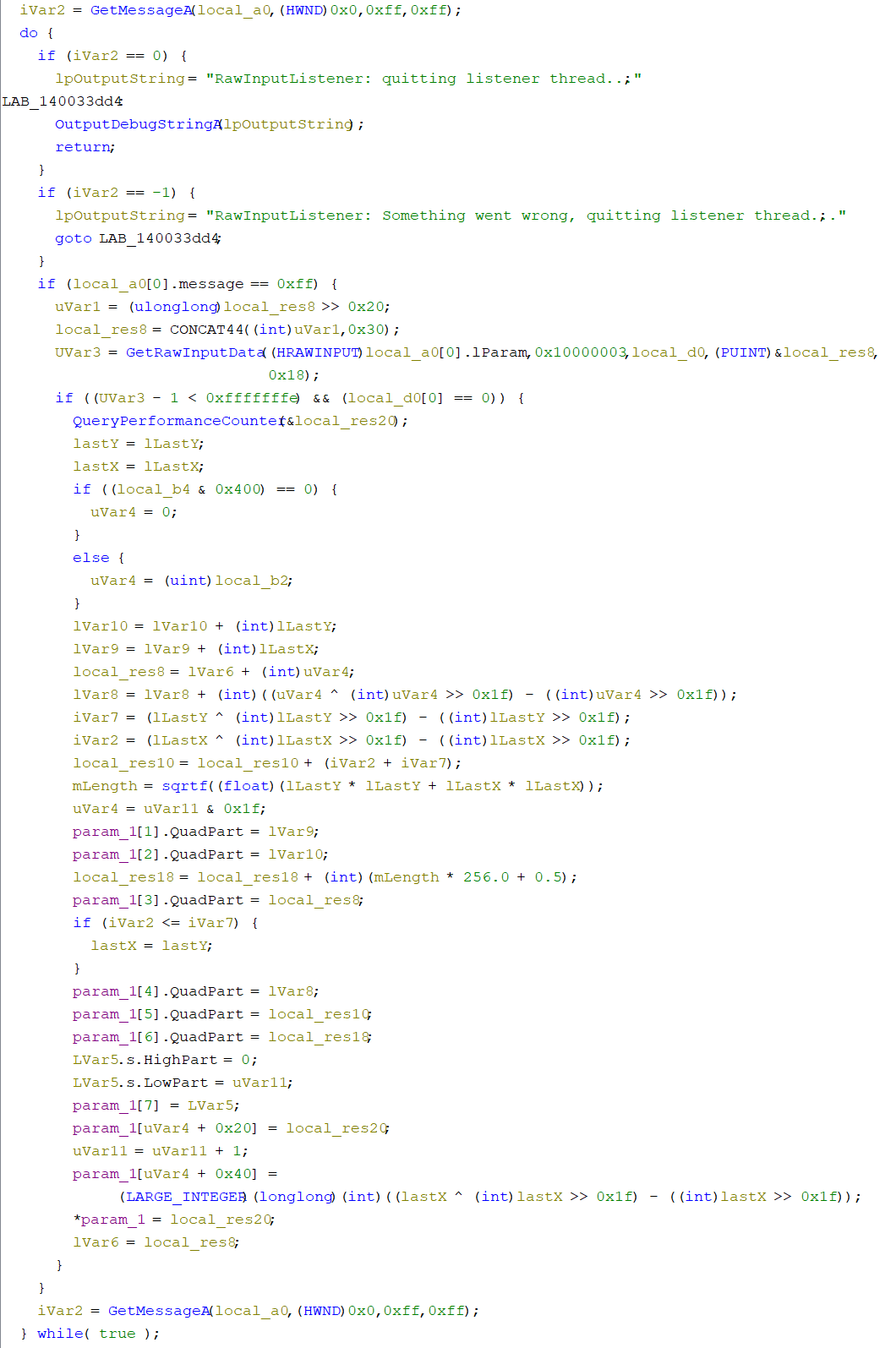

I've recently finally got my computer's MouseTester graphs stable with my dav3pro at 8000Hz. When I was digging into the last bits of jitter, I noticed in Windows Performance Aanalyzer that atieclxx.exe, a part of AMD's External Events Utility that is required for FreeSync and other things, calls `GetRawInputData` constantly. Killing that thread in particular fixes the MouseTester graphs, but also breaks FreeSync.
I threw the .exe into Ghidra and found the attached processing loop. Seems that atieclxx does calculations for Radeon Boost/Chill even with those features disabled, like getting the euclidean magnitude of mouse inputs. The `QueryPerformanceCounter` call I believe is needed for FreeSync, and is luckily cheap.
Regardless, turned out to be very easy to just NOP-out the RegisterRawInputDevices and GetRawInputData calls, for FreeSync without mouse input interference. Attached is a python script I made to patch atieclxx.exe automatically; it's also on my gitlab but I'm apparently not allowed to link there?

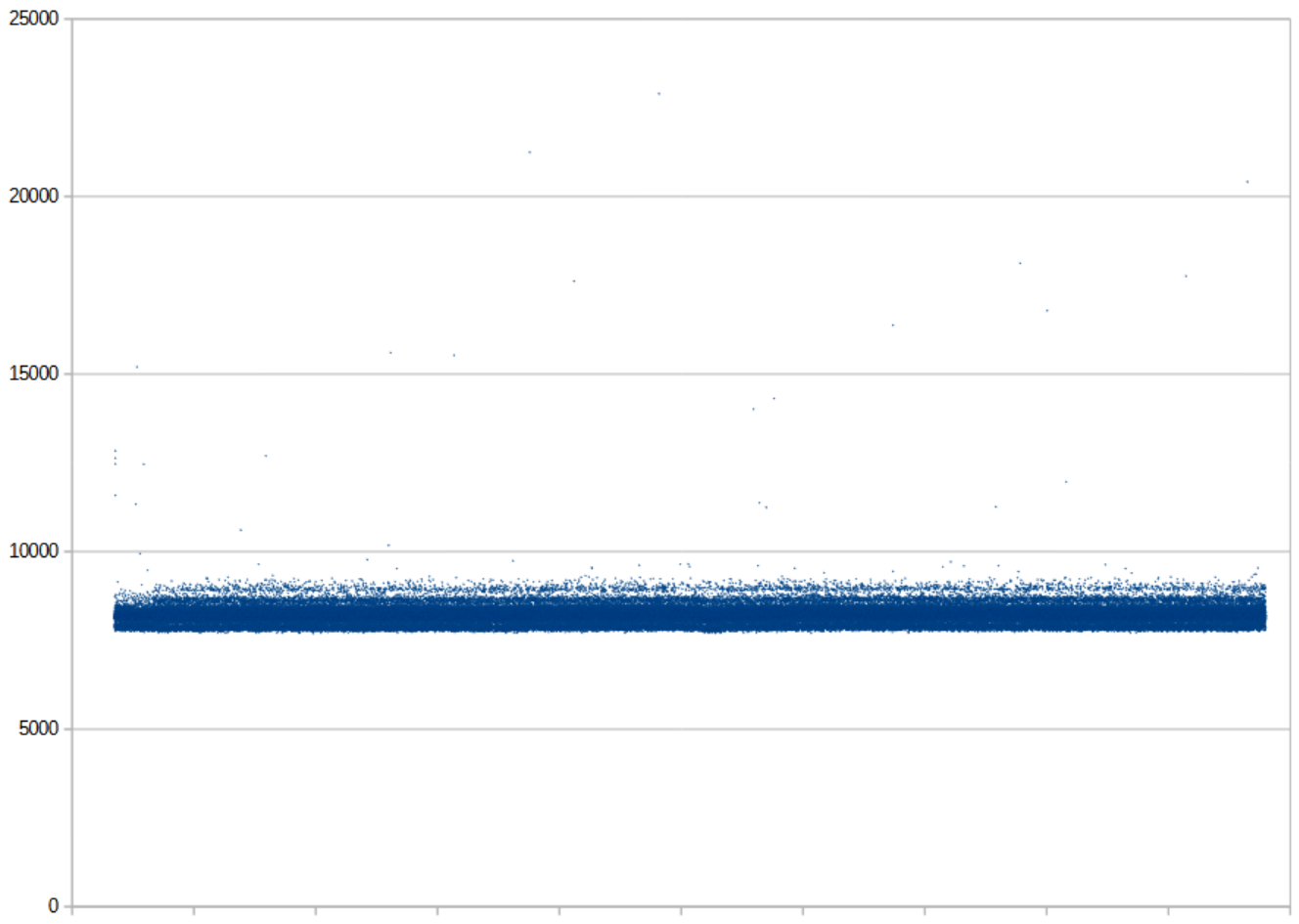

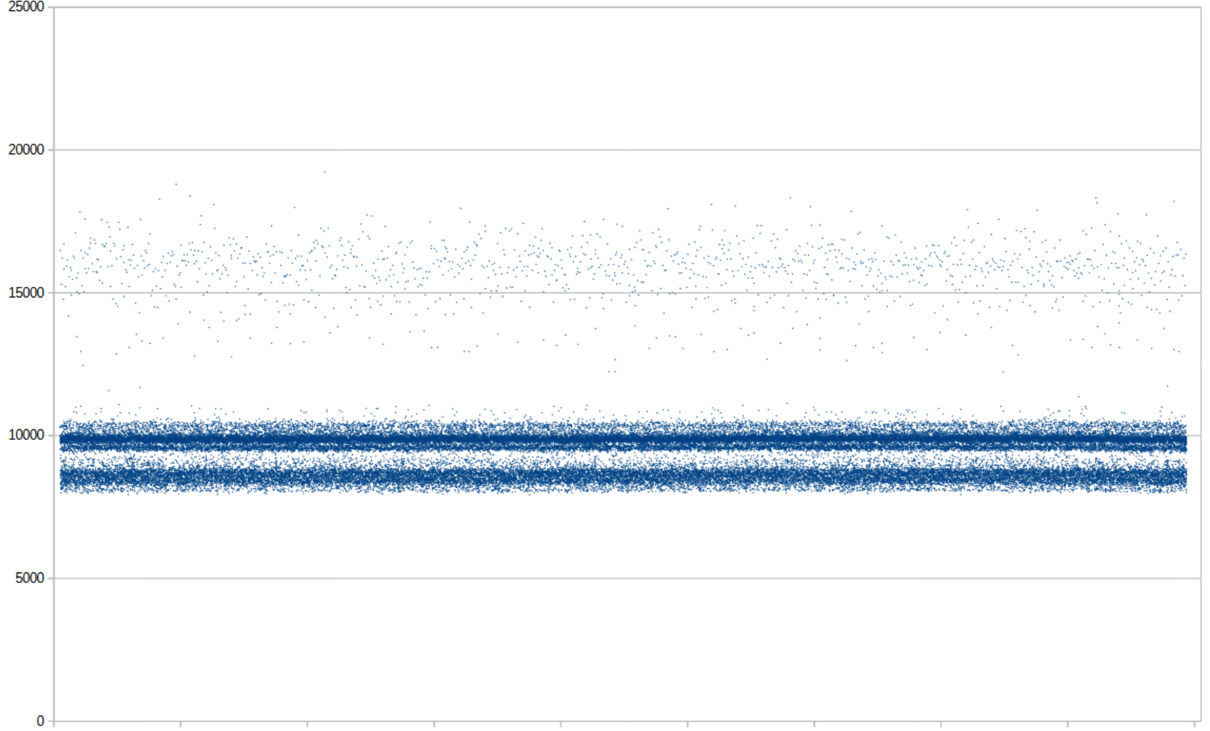

ISR-GetRawInputData latencies (in nanoseconds) before and after the patch:
Pretty much. The weird bitwise lines calculate absolute value of x, y, and scrolling inputs, and it takes those, combines them into euclidean magnitude and a couple diffent orderings of max() and abs(), and stores them all along with the QPC result into a memory-mapped shared object/file.Plyra wrote: ↑02 Mar 2024, 05:27Bad programming strikes again.
I noticed same behaviour on my setup (Radeon Software 24.2.1, latest version). When you check the stack that calls this subroutine unconditionally, it is possible to follow it until the function that initializes the actual driver. Driver checks the OS, enumerates the GPU version and does more but doesn't check if Radeon Boost or Chill is activated. So this subroutine that calls GetRawInputData() works all the time, in a do...while(true) loop. My educated guess is, it calculates mouse movement delta which is needed for Radeon Boost and Chill. They need to add a condition to check if those are enabled.
Put atieclxx.exe in the same folder as the script or vice-versa and run the script, then put atieclxx.exe back in its original location if you moved it. You can see where exactly it is by finding it in the Details page of Task Manager, right-click→properties. Again though, you may need to use a tool like AdvancedRun to move atieclxx.exe as the TrustedInstaller "user".RealTweaker wrote: ↑05 Mar 2024, 10:22How can i tell the script worked? When i run .py script the console flashes for a moment, does it mean it worked?
You can tell if it worked by comparing hashes of the exe before/after running the patcher, or comparing graphs, or using xperf+WPA to see if atieclxx.exe is making any NtUserGetRawInputDataCalls.

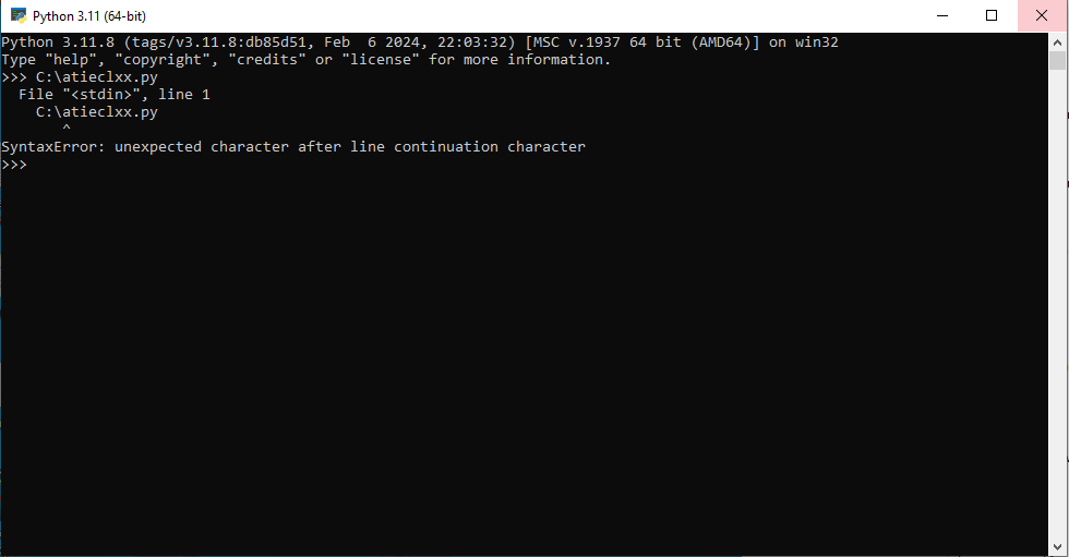

Okay, thanks for the answer. I downloaded python 3 on win10 and tried to run your script. It throws an error on the first line.Aeodyn wrote: ↑09 Mar 2024, 15:01I don't actually use Boost or Chill, but my understanding is that Boost varies your resolution depending on mouse movement, and Chill varies framerate depending on mouse movement (and is more a power-saving feature than anything else). atieclxx.exe seems to be a way for the driver to get that mouse movement data, but it does so unecessarily even when these features are disabled. Two different programs constantly calling GetRawInputData means both get a bunch of extra variance in polling timings.

And also, after using your script with AMD chill enabled, will there be problems with the mouse?
- error.PNG (14.39 KiB) Viewed 36023 times
