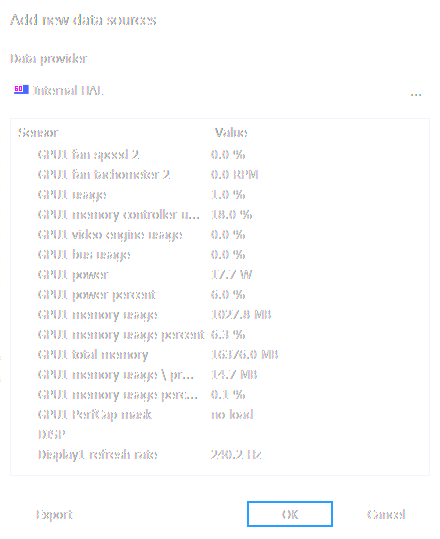

jorimt wrote:
31 Jul 2024, 09:32
RealNC wrote:
31 Jul 2024, 08:24
I think RTSS has that directly built-in now. It just needs to be added in the overlay editor. Will check later to make sure.
Even better, if so.
Just checked, and it has it as a data source in the internal HAL, at the very bottom:
I added it to the overlay and it correctly tracks current refresh rate, including LFC (35FPS for example shows 70Hz.)
