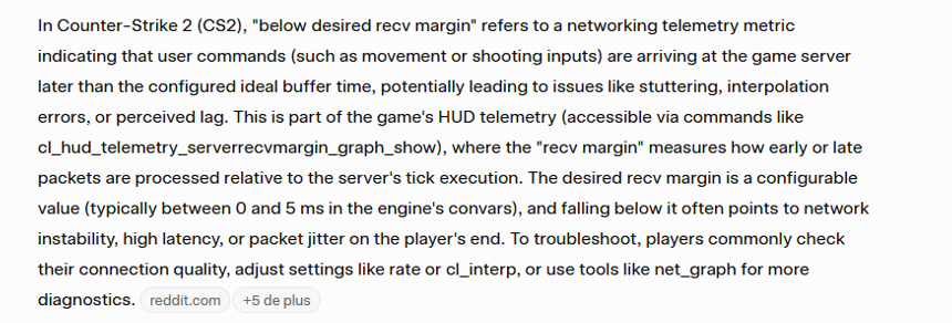

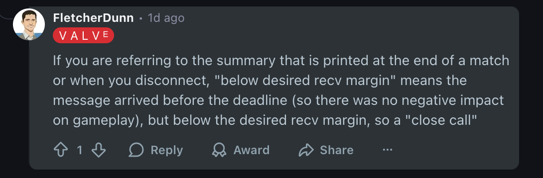

Someone on reddit asked the same question to FletcherDunn (engineer at Valve, working on networking) about the recv below margin here is what he replied
"He says that "below recv margin" means that the tick messages arrived before the deadline and that there is no negative impact on gameplay. "
He is surely more competent than me in that matter, but i hardly disagree... here is why :
1) If those numbers does not impact gameplay negatively as he wrote, then why integrate it in the latency breakdown?
2) why when those numbers are high IT IN FACT DOES AFFECT gameplay

Even tho i hate AI and avoid it as much as possible the explanation of ChatGPT makes more sense than the explanation we got above?
Also the fact that FletcherDunn says it "should not impact gameplay negatively" is just wrong? imho... then why integrate it in the latency breakdown?
I partly agree with him that when sometimes i have 3% or 5% it has almost no impact on my gameplay but when the number is above 20% it is literally unplayable (especially on upstream)
