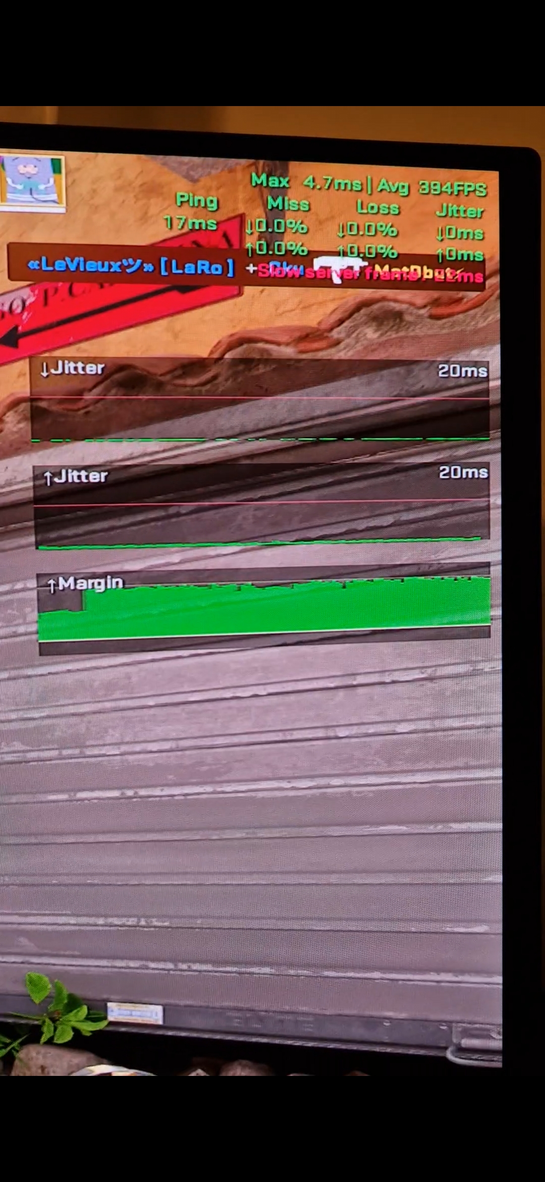

One of former CS pros stats on faceit after match while streaming:
Can you please share how your graph looks?
which pro player are you taking this from in your screenshot? please be specific this is public information it's not like we are talking about super secret stuff.
Here is a capture from former pro player scream (found it in a clip someone made on twitch a few weeks ago)
Omg if someone told me how to replicate this I would be the happiest person alive all below 1% wtf

can you share what your margin graph looks like? i'm curious to see especially with your very high downstream recv margin.
It was from pashaBiceps.
Mine is usually around 5 to 20% for downstream, upstream usually much better in single digits mostly. Graph depending on server is fully green and consistent. Only on some servers with intertwined yellow parts all the time and you can tell something is off right there.
I remember Scream complaining about some issues some time ago. Would be cool to have stats from that time. Maybe next time you see some good player say such things, tell them to check those stats and compare to the time when they don't complain and they play good.
It is interesting stat that it is hard to find any explanation what is supposed to be good value.

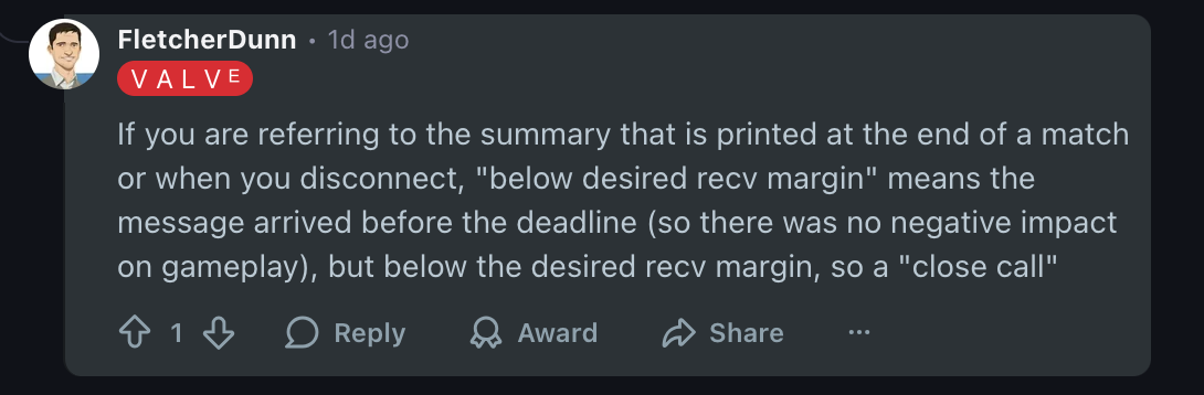

Someone on reddit asked the same question to FletcherDunn (engineer at Valve, working on networking) about the recv below margin here is what he replied
below recv margin fletcherdunn.png (85.93 KiB) Viewed 3171 times
"He says that "below recv margin" means that the tick messages arrived before the deadline and that there is no negative impact on gameplay. "
He is surely more competent than me in that matter, but i hardly disagree... here is why :
1) If those numbers does not impact gameplay negatively as he wrote, then why integrate it in the latency breakdown?
2) why when those numbers are high IT IN FACT DOES AFFECT gameplay

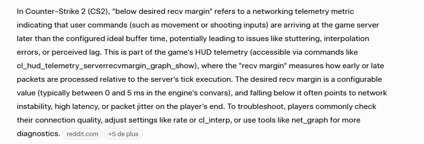

Even tho i hate AI and avoid it as much as possible the explanation of ChatGPT makes more sense than the explanation we got above?
recv chatgpt.PNG (183.03 KiB) Viewed 3058 times
Also the fact that FletcherDunn says it "should not impact gameplay negatively" is just wrong? imho... then why integrate it in the latency breakdown?
