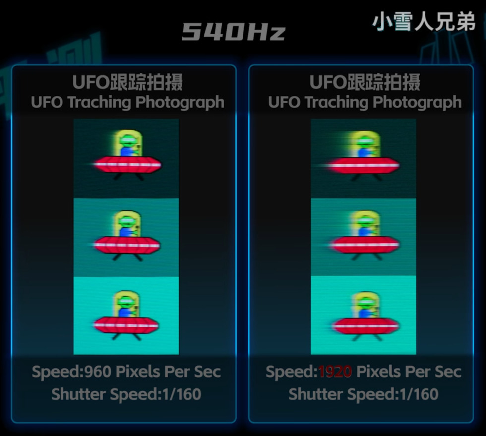

1000Hz IPS at ~960 and ~1920 px/sec speeds.
Eye tracking at high speeds isn’t amazing on these LCDs. This is also a good example of how higher speeds accentuate GtG issues better than lower speeds - a message to reviewers.
Philips 27M2N5500XD 540Hz QHD 960 and 1920pps.jpg (143.64 KiB) Viewed 99130 times

Discorz wrote: ↑
23 Apr 2026, 07:28
I have been nudging reviewers to use 1920 pixels/sec at www.testufo.com/ghosting
It's the new default motion speed.
Many reviewers are slowly switching over, though I wish more would use UFO Deluxe, because more reviewers need to cite "TestUFO" not just "UFO". TestUFO is our trademark and I need reviewers to give TestUFO credit.
Still, many recognize it as TestUFO, but I wish more reviewers would properly cite/credit Blur Busters properly.
Also, shutter speeds are getting too brief at 1000Hz, that's why my sync track now supports 10-tickmark modes! Shutter speed can be slower if they use 5-tickmark or 6-tickmark pursuit camera modes. It can avoid short-exposure problems (photos too dark and noisy), as human vision settings are more similar to a slower camera shutter, when configuring pursuit camera settings to emulate the slowness of a human vision.
