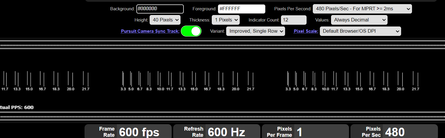

I checked the monitor on your advice and the first digit at the initial speed of 480 Pixel/sec is 3.3ms (when turning on the 600Hz refresh rate), on my old 240Hz monitor the initial figure is 4.4ms.

radeko
Posts: 61
Joined: 04 Apr 2024, 19:04
Re: I bought a fake 600hz monitor, help.
Post by radeko » 17 Jan 2026, 11:47
Add overdrive .maybe the results will improve
Don't take screenshots. It won't help us at all.

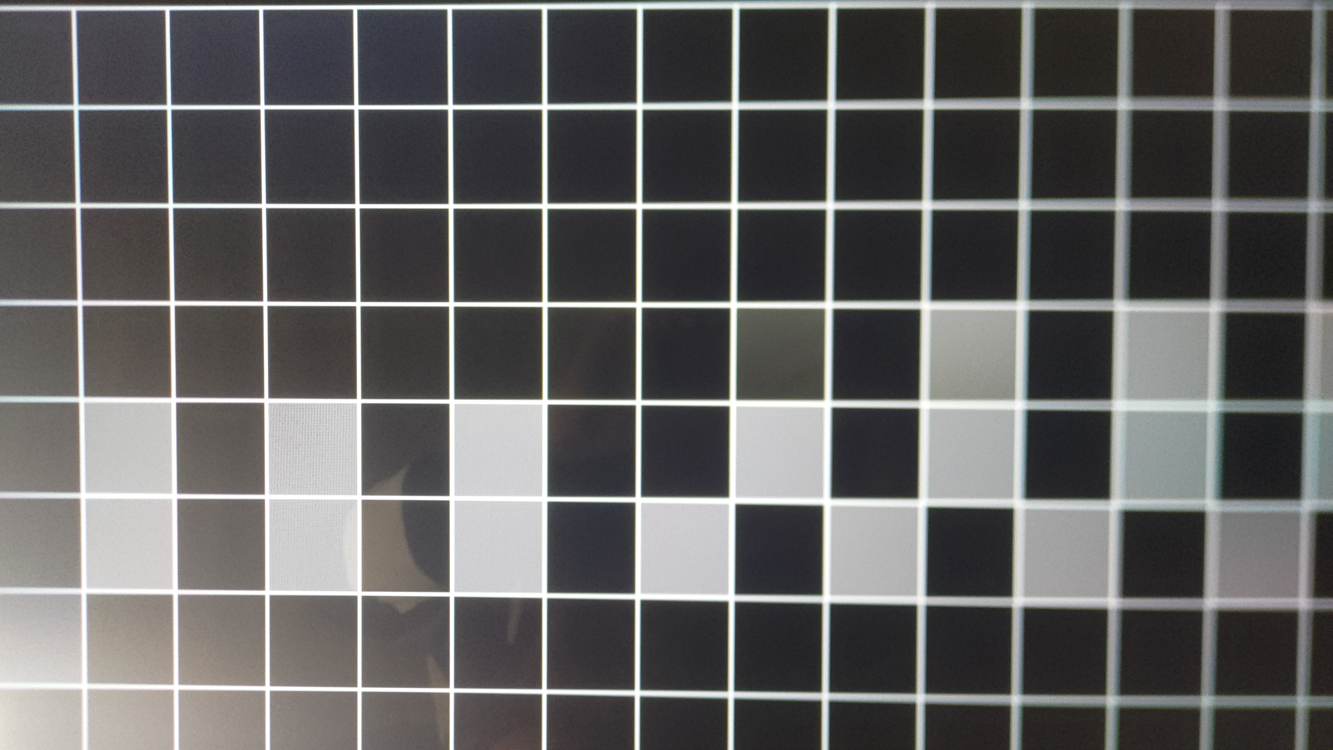

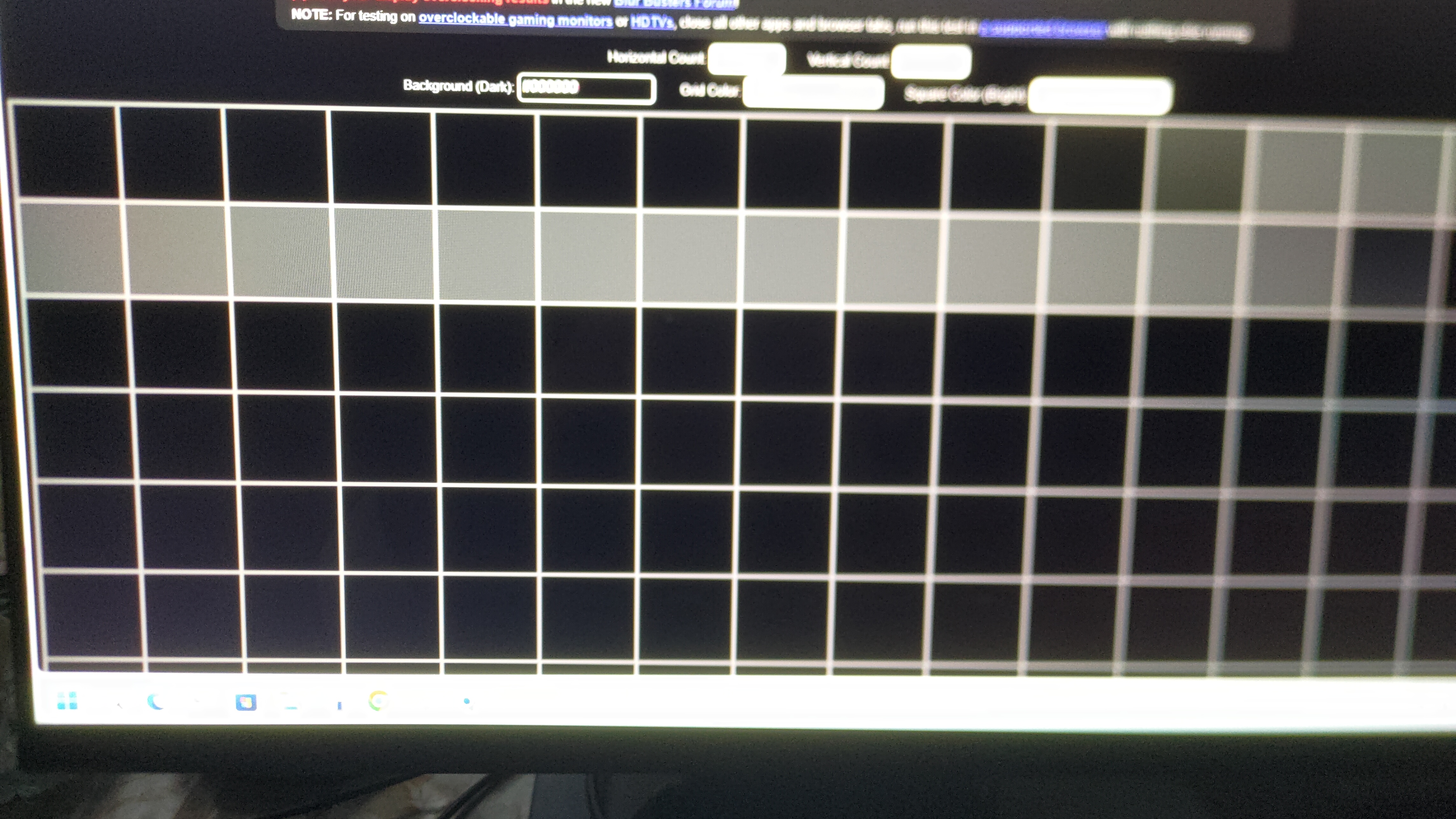

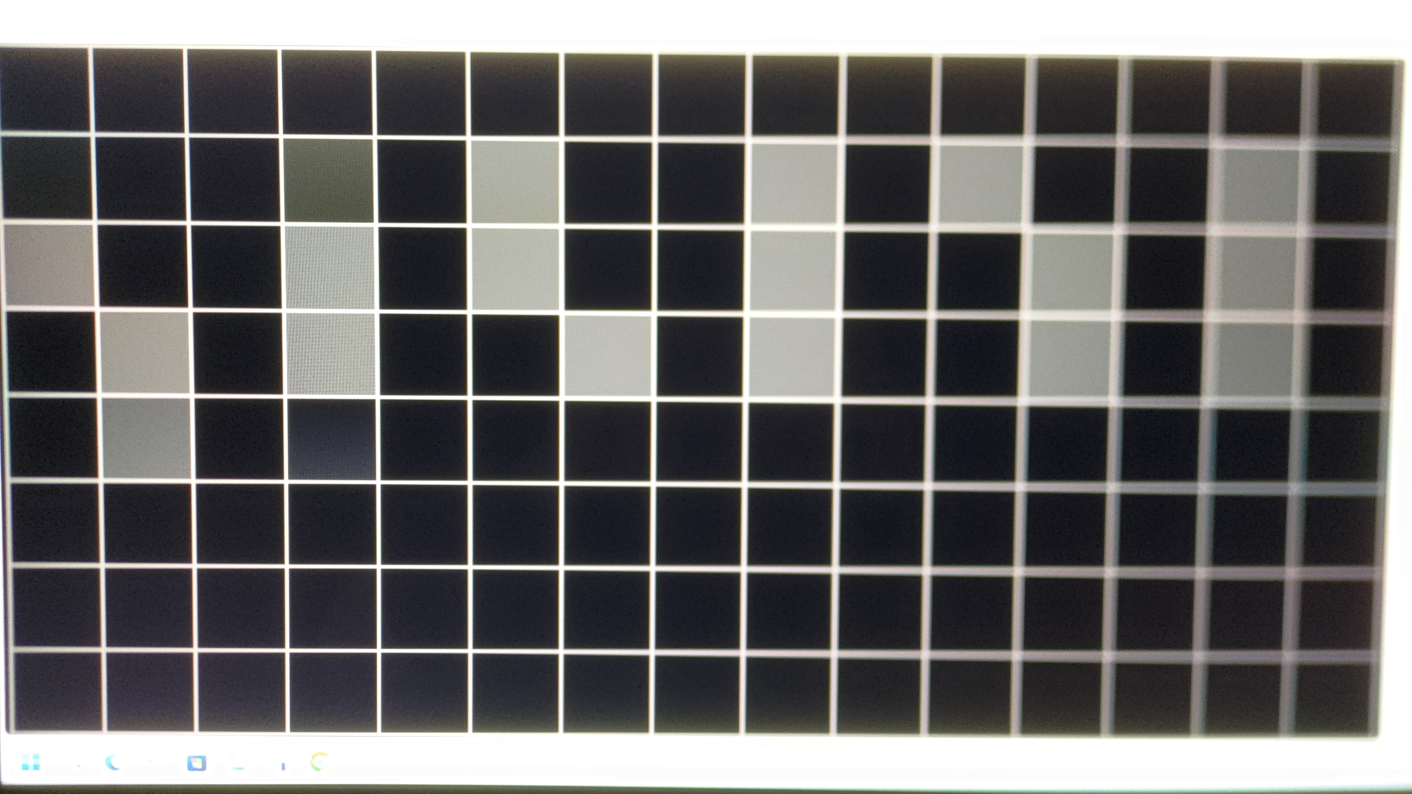

Yes, indeed. At 240Hz, I see 16 squares in a row, but at 280Hz, there are already gaps in the row of squares, and at 600Hz, they start going from top to bottom, not from right to left as usual. Look at the first photo: 600Hz, and the second: 240hz.

This is a terrible monitor. Just look at how it skips pixels at a refresh rate above 240Hz. It's simply unusable. Now I understand why it's so cheap. I bought it for about $442.
I've now written to the seller about a return. Either the timings in the CRU are incorrect, or it's an overclocked panel with a true refresh rate of 240Hz. Never buy the AG248F, it's a fake!!! They're simply selling you an outdated 240Hz panel with modified firmware. These unknown Chinese manufacturers are scamming people!

"Fake" refresh rates are done by accepting high refresh rate input, but the panel actually refreshes at a lower rate. In that case, you will see frame skipping, which manifests as black squares on that test.
Looks like you've been scammed.
You can't use screenshots or photos for this -- you need to eyetrack your eyes and speed up the motion until you see some blocks overlapping vs not overlapping.

If www.testufo.com/frameskipping says "600fps" and "600Hz" and says green READY and you have no gaps in the photos == you definitely have 600 Hz. But if you have gaps like in the photo = it's fake.
Originally I was wondering about LCD GtG taking several refresh cycles, meaning you can't easily tell apart refresh rates above approximately 100-200Hz(ish) except for the reduced stroboscopic stepping effects (www.testufo.com/mousearrow) -- but this is not the case here.
Instead, your newer photos shows a fake 600Hz, showing only 240 out of 600 cable-delivered refresh cycles per second.
