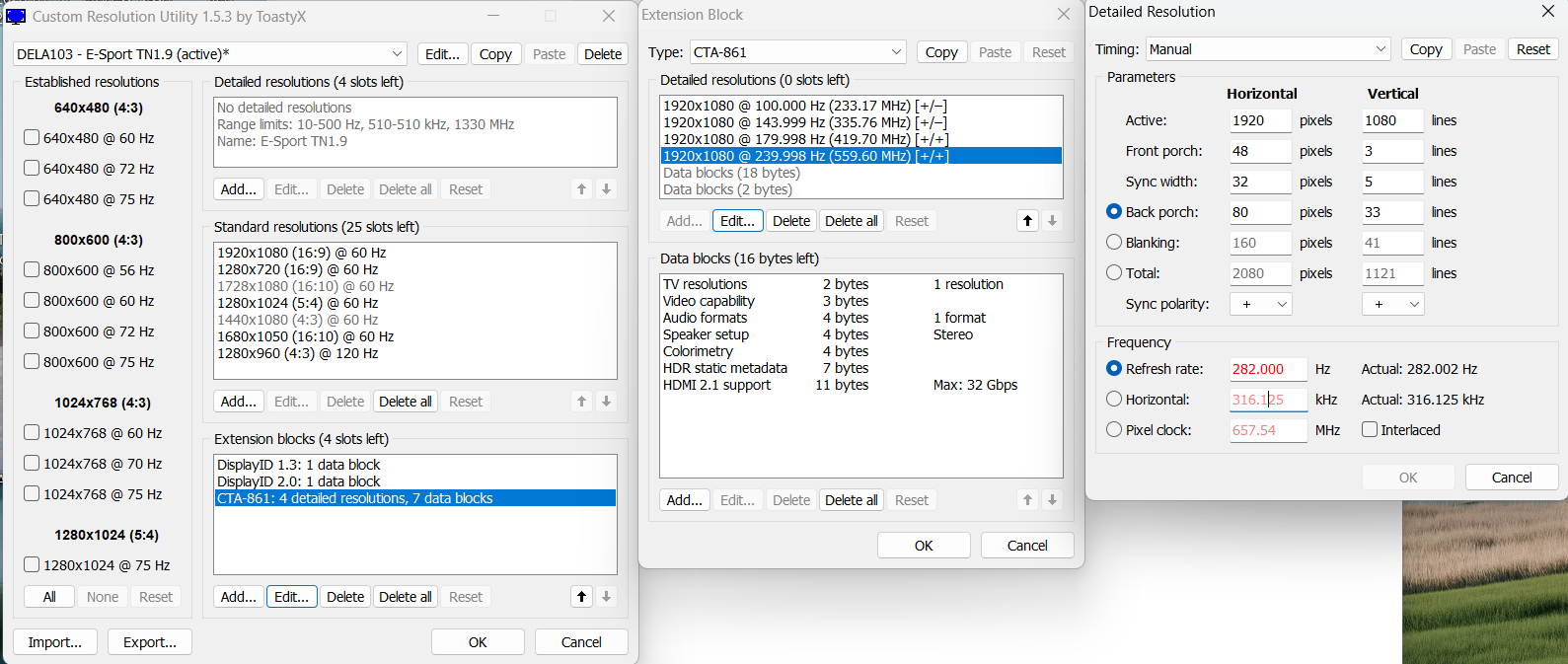

But for now, I need help with the CRU. Can you tell me why the maximum refresh rate I can add to the CTA-861 is 281Hz? The values below are in red. I need CRU settings from other 500-600Hz monitors.

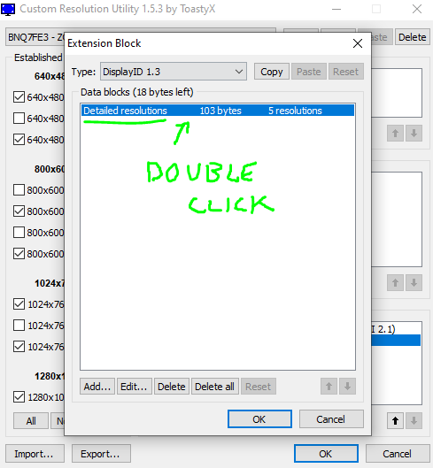

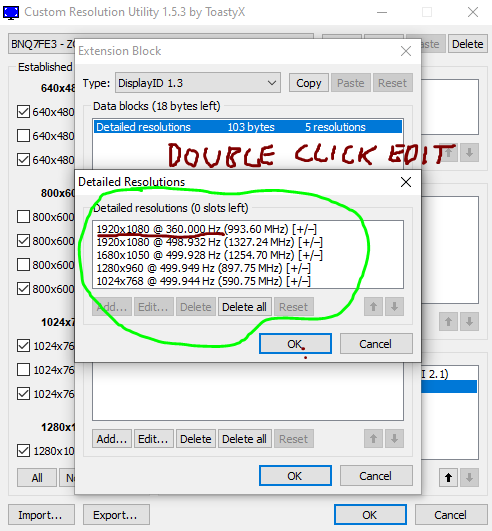

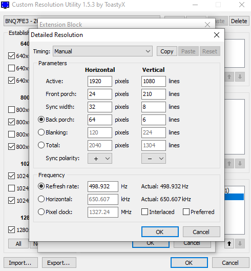

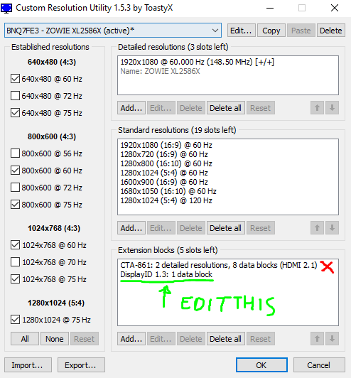

heres my zowie at 500hzF1zus wrote: ↑17 Jan 2026, 07:03It's not so easy to do when you buy from abroad, you need to coordinate the return with the seller.
But I'll try to return it.
- zow3.PNG (43.32 KiB) Viewed 8319 times
- zow2.PNG (28.52 KiB) Viewed 8319 times
- zow1.PNG (31.51 KiB) Viewed 8319 times
MSIfanboy
- Posts: 188
- Joined: 15 Apr 2022, 13:51
Re: I bought a fake 600hz monitor, help.
zowie, and obviously cru restart afterwards or restart pc
- zow4.PNG (35.17 KiB) Viewed 8318 times
