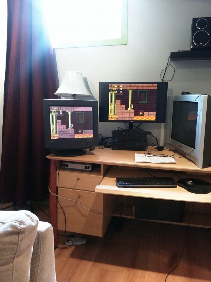

I was able to set the CRT to 100hz refresh rate. I having a timing option I can play with CVT, CVT reduced blanking(Didn't use this), GTF, DMT and manual. It was set to manual and I switched it to CVT. Not sure if it's the best option. I read somewhere else on your forum this is an old feature for CRT as a guard delay. I still prefer the LED for computer use(reading web pages) but you are totally right if I distance myself away from it gaming on it is good. Thanks again for the suggestions.Chief Blur Buster wrote:That's because of the EDID / DisplayID system that transmits Plug-n-Play information between the display and computer.
Most old CRTs did not have this, and Windows 10 does not unlock >60Hz by default.
Make sure you don't exceed the specs of your CRT -- horizontal scanrate and refresh rate. Make sure you check the rear of the CRT for the scanrate ranges, and keep within that with Custom Resolution Utility. Use the old blanking interval feature (CRT sized), not the CVT-Reduced (designed for digital displays) -- CRTs can't handle reduced blanking intervals.
- Sonic.jpg (130.24 KiB) Viewed 7108 times
