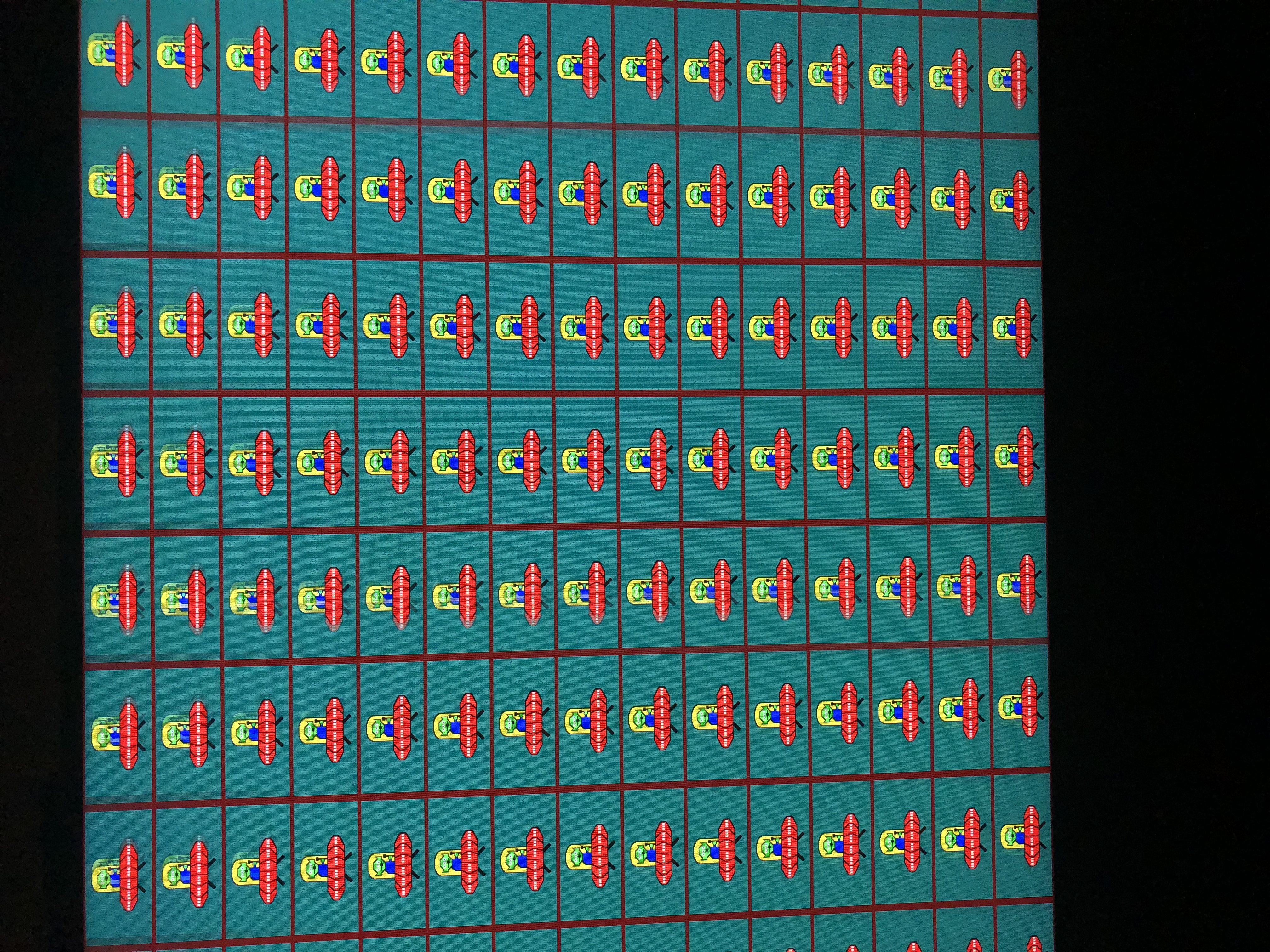

I think your camera is not good enough for eye distance display capturing. Fullscreen capturing is used for strobe crosstalk.
This is your second pursuit but with tuned exposure and sharpened a bit. That's how would I do it.
XG2431 240Hz Ultra Fast 960pps - PS edited
XG2431 240Hz Ultra Fast 960pps.jpg (347.03 KiB) Viewed 29820 times

that edit looks great to me! if anything the it looks slightly better in person, but I think that's mostly down to the colors being better/eyes being better than 4k. I'll mark that as 'the' 240hz example shot for now.
I've reorganized that drive directory a bit, here's a link to the top level. I appreciate you both providing guidance and oversight. I figure I'll try to get at least a 240hz 'normal' and then figure out the whole QFT thing for 60 and 120hz strobing before dumping those images and my subjective thoughts back in the main xg2431 thread.

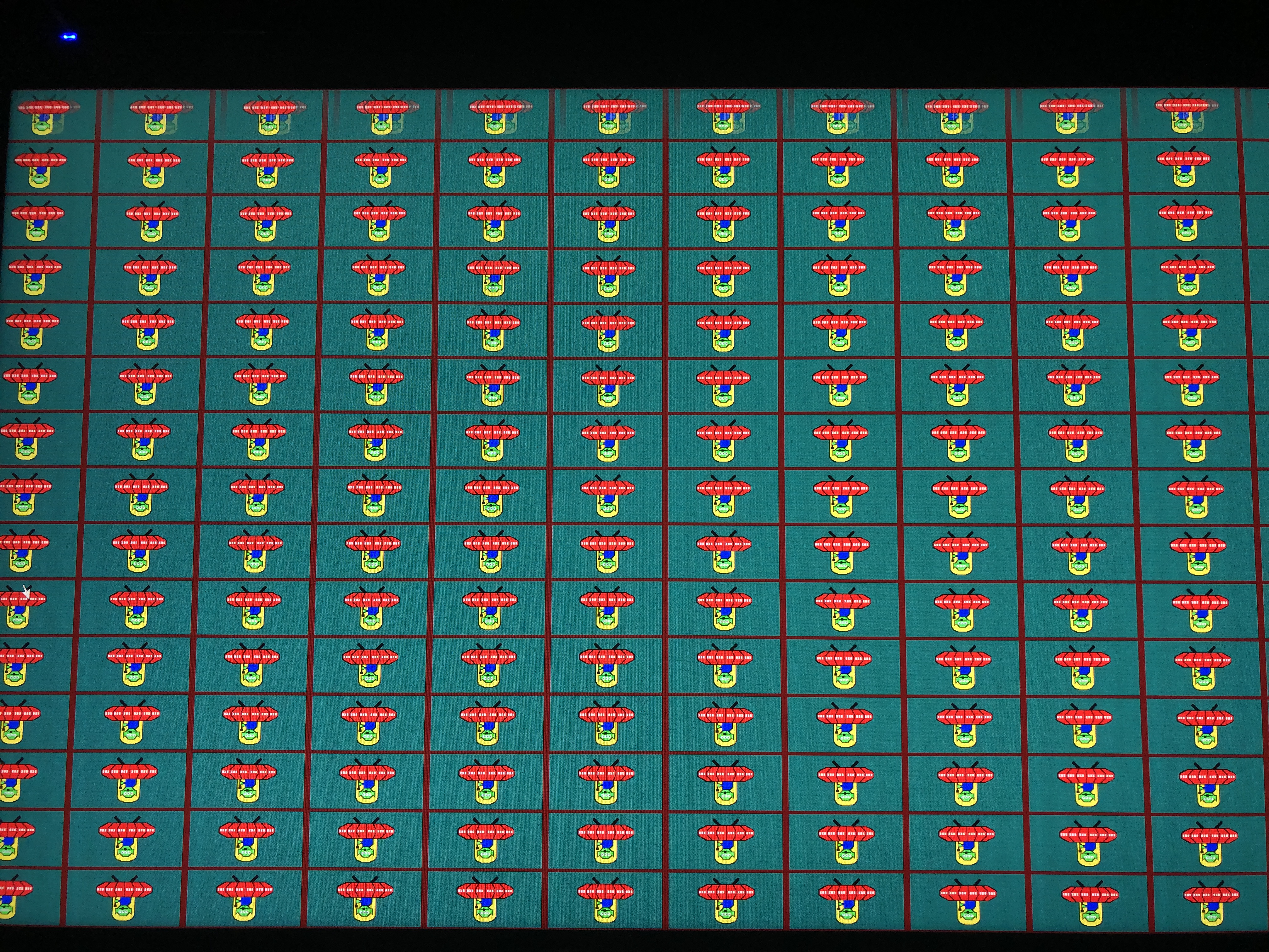

I did one pass of strobed/pure xp pursuits, and boy does that make it easier to see the sync lines. how do y'all think this one looks?
xg2431 240 extreme 960
best_ (1).JPEG (1.32 MiB) Viewed 29814 times

This is amazing! Now we finally have a bit better view. Thank you for doing these.

Good strobed pursuit photo! Strobed pursuits is easier, yes.
Which refresh rate? It appears you used factory tuning at a high Hz.

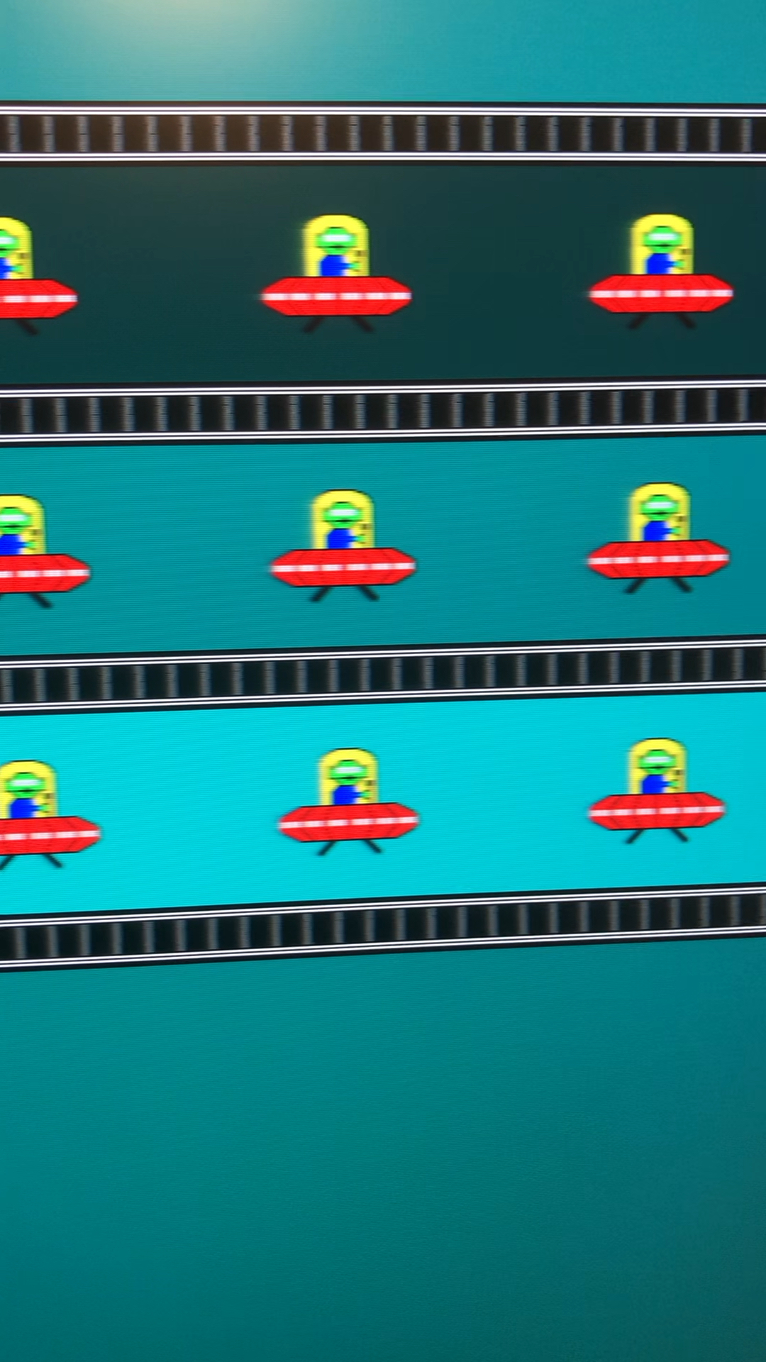

the one I posted in this thread is 240hz at 'extreme' and I also did one for 'normal.' my assumption (which I think is supported by your explanation) is that the factory 240hz modes are as best as you can get for a given brightness level. I could probably live with a brightness slightly in between the normal and extreme presets, but I already feel like I'm splitting hairs to spot the difference between those two modes. the difference between 240hz strobed vs unstrobed is pretty stark for me in ufo tests, though I'm not sure I appreciate the difference in game trying to A/B them. I'm staying on strobed for a few days to see if I can notice a change after adjusting to it.
I did give 60hz and 120hz a go after figuring out that the 'stock' 240hz mode is in the extension block. I'm able to double the VT to 2250 for 120hz. indeed at center screen (I'd say the middle 33%-ish) there's no detectable cross talk, on the lower third it's still difficult to spot, and the upper third is a bit more noticeable. I'm not sure what happened to the left-of-center column, some sort of photo artifact? shutter speed was 1/120 for this stationary photo.
120 strobe full screen (ROTATED).JPG (5.01 MiB) Viewed 29600 times
[Click for Zoomed Image]
for 60hz, I wasn't able to achieve 4500 VT. I could get an image at 4225 VT, but the screen would flicker to black every few minutes. this didn't happen at a VT of 4200, so I tuned there and it did result in a cross-talk free image from top to bottom. using those steps, though, results in a refresh rate of 64hz. I admittedly didn't investigate much, but is there a way to get this to 60hz while maintaining that 4200 VT? or is the discrepancy of a 64hz refresh rate vs 60 fps content not going to be noticeable? I fired up sonic mania as a test case for real world content and...I'm not really sure I notice a difference even when I look for it. I'm also assuming the bottom row is a photo artifact of some kind. shutter speed was 1/60
60 strobed full screen (ROTATED).JPG (5.15 MiB) Viewed 29600 times

Fantastic 120Hz strobed crosstalk photo. Yes, there's a shutter artifact. A camera sensor slowly scans, so part of sensor captured one strobe, and another part of sensor captured a different strobe -- this can vary from camera to camera if you're not doing pursuit camera with strobing. Pursuit camera avoids this type of artifact.
Can you post a screenshot of your Strobe Utility settings for your VT4225 QFT mode?
I presume you followed instructions at www.blurbusters.com/xg2431 when tuning strobe.
GammaLyrae managed VT4525 with this Strobe Utility setting:
viewtopic.php?t=8113&start=360#p70213
Try re-read the Quick Frame Transport HOWTO to make sure you're properly configuring your QFT mode. You need to modify a max-Hz mode with unmodified Pixel Clock numbers;
