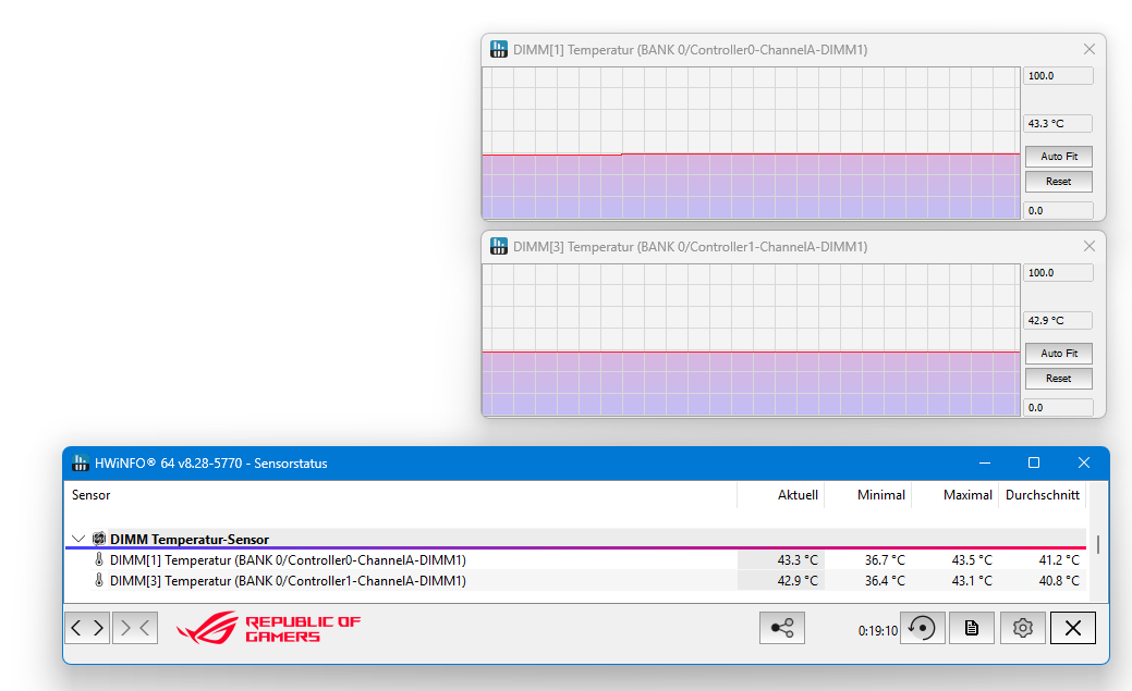

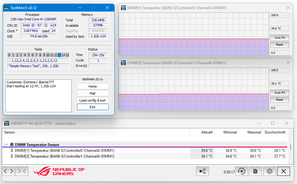

Dude, I KNOW it's not the RAM. You don't get the point of this I think. The procedure I've posted isn't meant to "fix" it or provide the actual solution. Look, when you're troubleshooting stuff like this, it's important to isolate as many variables as possible. It's necessary to get everything to a baseline state, which you know works 100% of the time. Doing my suggested steps will achieve that. You have to do this with your memory, because again, its stability is temperature dependant, unlike most other devices in your computer. If you're heating it up with a test and then have it retrain at these elevated temperatures, only then you know for certain that it'll be running in a stable manner in any scenario you can throw at it, for example a 45 minute round of BF2042. It has nothing to do with running XMP or stock settings or anything, but the temperature and its effect on the memory sticks.
Again I ask you to do the steps I've listed in yesterday's post. Then, after you've done the steps with your memory, play more rounds of BF2042 and record packet captures in both scenarios, when the game feels good and when it feels bad.
We're not going to get anywhere with this unless you're willing to help me out a little bit. I'm trying my best, but your input is required here. Nothing I can do if you can't do these simple things for me. Thanks.

I did everything according to your instructions.
The game feels like what I'm used to on a Sunday. My shots aren't registering properly. It was 50:50 for the round.

Alright, nice. Thanks. The next step would be to do the Wireshark capture again when the problem is there, and also when it's not there. When you've done that, you'd be looking for differences in the captures. You can start with the I/O graph again and post in in here. The ultimate goal is to find a consistent, reproducable difference in the packet captures which can be used as an indication if a round will be good or not.

And that's to be expected. Again, the point of that procedure was to consistently eliminate the memory from the equation, so we don't have to think about it any more. Now, there's one less thing that could be the root cause and we don't have to worry about it. It leaves less possibilities open and makes troubleshooting infinitely easier.
