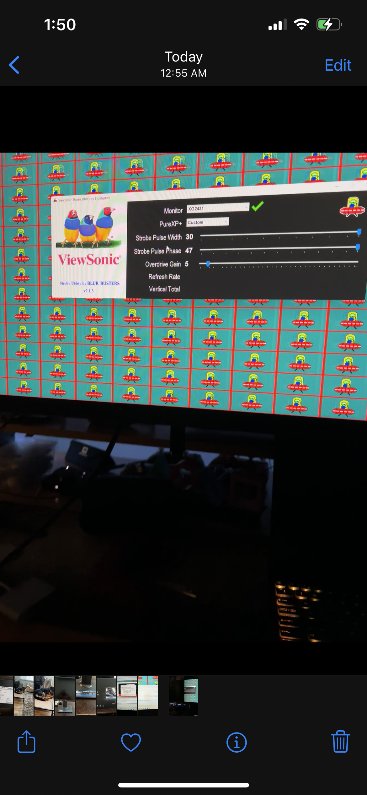

Hey Chief,
I tried what you said. I used the strobe utility on Pc for “custom” profile I tried settings that another used on the forum regarding 60hz which was 30 Width, 60 phase, and gain 5. When I try this my phase maxes out at 47 (on strobe utility)? Also on the strobe utility vertical range and refresh rate are not displayed while plugged into my gaming laptop?
Also for view mode I’m unsure if I should use standard versus FPS mode (I play Alex legends on ps5)? Standard has better visuals and brightness. For colour temperature I have it at 90 red, 90 green, 100 blue. Thanks chief sorry to keep asking questions I really want to get this monitor calibrated properly!
Weird! I've never seen Strobe Utility do that --
Are you using multimonitor mirroring with the laptop screen? That may be missing from my QA debug test suite, I have a Razer laptop but it works fine in monitor spanning mode -- but I never tested monitor mirroring (laptop screen = external monitor = same image). That would probably cause the problem, because Strobe Utility doesn't know which screen is using what vertical total, and just displays nothing. (That's my theory at least)
Try temporarily disabling the laptop screen whenever an external display is connected then try again. External display as the only display. That should fix things, I hope.
You may have discovered a laptop-screen-mirroring-specific Strobe Utility bug for me to fix -- thank you!

Thanks for the info greatly appreciate it! I was able to get it working with the laptop. I adjusted my custom profile however is there a way to adjust vertical total? I tried looking it up and was lost. Thanks Chief!
