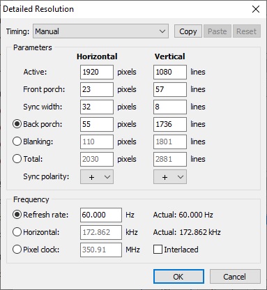

Did some more experimenting with the XG2431 when connected to a Steam deck, using Windows as my testing environment.
The drivers in Windows aren't very mature (or maybe there's a hardware limitation I'm not understanding...), so the function in CRU to restart the GPU driver doesn't work as you'd expect. The GPU driver does restart, but then monitor information is no longer properly detected. Different areas of Windows will report you're running at either 1hz or 64hz. Rebooting restores the expected normal functionality, but anything you changed in CRU is gone. Busted. But! If you use CRU, enter some new data, and then restart the steam deck instead of just the GPU driver, the changes stick.
I tried settings that I knew should work (and had gotten to work before when using this monitor on my main PC). No go - I knew I was under the pixel clock being used by 240hz, so I wasn't sure what was up. Using the Vertical Total calculator function of CRU, I experimented with reducing the pixel clock in 100-200mhz increments until I could switch to 60hz with a high vertical total that worked. A small tweak in manual mode to push it to a flat 60hz later, and it still worked fine.
I think there may be a vertical total limit in the driver or hardware. It seems to handle high pixel clocks OK, but really didn't want to go too high on the vertical total. I managed 2881, and slightly higher may be possible, but I ran out of patience for continuous Windows reboots. Definitely within the upper bounds where pushing up to the exact actual limit is not likely to produce perceivable results. Here's a screenshot of my CRU settings for the high vertical total 60hz mode I got working on the Steam deck in Windows.
steam deck custom 60hz.jpg (52.24 KiB) Viewed 10309 times
Next step is to figure out how to change the resolution timings in a more permanent manner on the steam deck in game mode or desktop mode, and see if I can get a high vertical total mode for 120hz dialed in...
