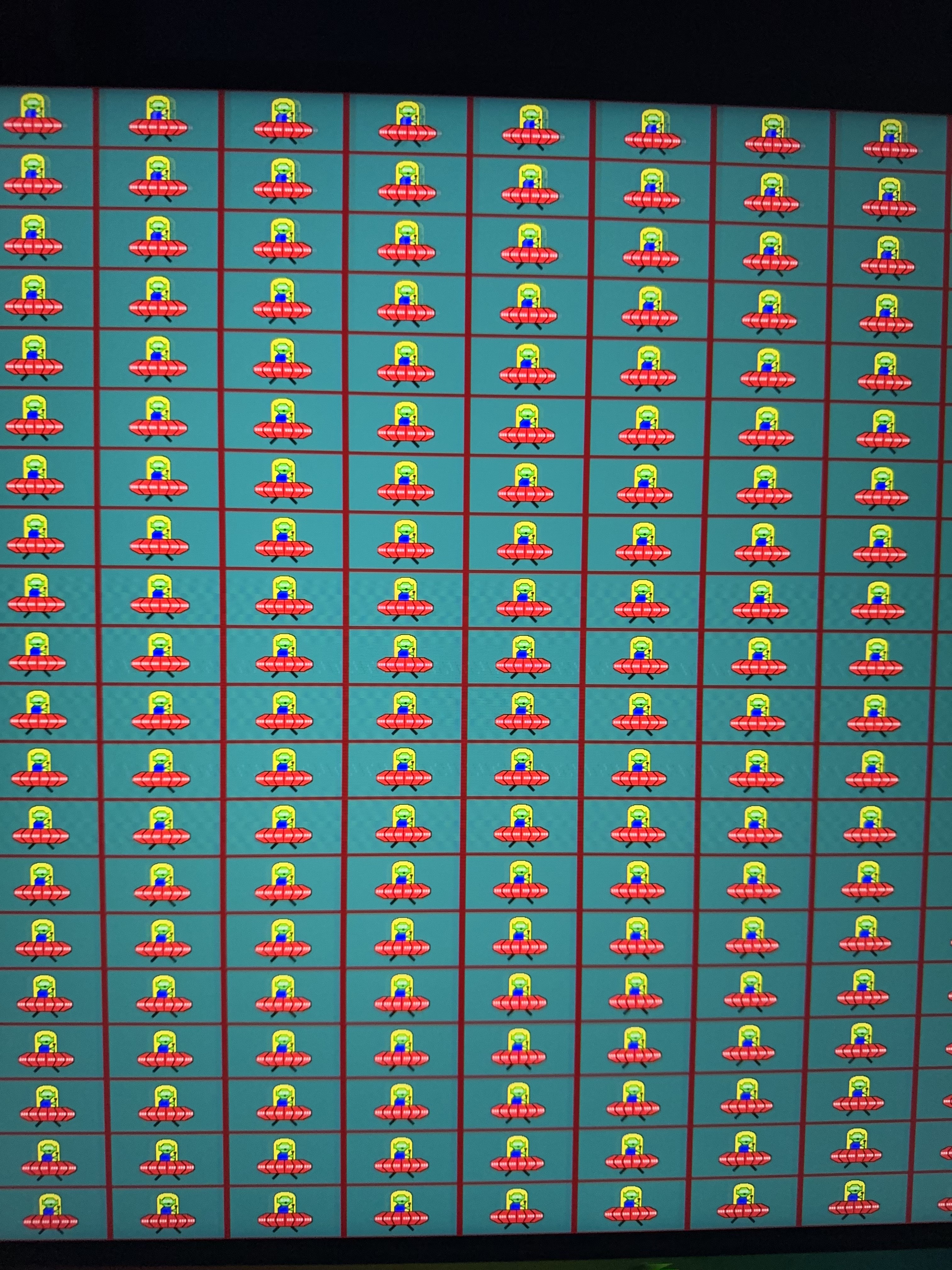

FW 1.1.10 ULMB2 240Hz PW10 Pursuits
Notes:
  • 1/60sec shutter, taken as photos (not video frames).
  • Selected px/sec speeds also match real speed at 240Hz
  • Image retention from having pursuit cam test on earlier does show in these images especially center of the screen in the crosstalk test
Testufo pursuits (2400px/sec)
Strobe crosstalk test (1920 px/sec)
Crosstalk performance at 240 is seriously impressive. I don't know if there's other monitors out currently that can balance this low persistence, with this low crosstalk at this refresh rate while not giving you TN colors.

edgintheledge wrote:
12 Sep 2026, 20:04
In the QHD sphere? Not that I know of. It's mighty impressive results, considering that QHD/4K high refresh rate models are plagued by KSF fringing.
Could you do some PW=30 or PW=40 pursuits? I believe those 2 should be around 100-150cd/m², which is a usable brightness target to be at.
~50cd/m² (PW=10) is somewhat unusable IMO.
If you have a way to map out brightness levels on each PW target (steps of 10, 10-100), that'd also be nice. Either with a smartphone or a external device.
Ideally, you'd find the ~1 px of blur target of each PW setting on 240Hz & 360Hz by choosing different TestUFO speeds till you find the correct one.
In the case of PW=10 @ 240/360Hz, I'd argue that it's definitely ~0,5ms pulse on-time (~2000 Hz effective motion clarity)
Based on TestUFO pursuit photographs, I could plot out the performance in a new, empirically correct graph.
