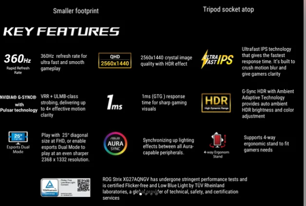

Post by radeko » 14 Dec 2025, 19:40
4x Motion clarity. It could be rolling BFI.
Only 400nits of Brightness . It not sounds good for full frame BFI. But rolling BFI done in one frame could give more light
Zrzut ekranu 2025-12-15 013759.png (177.09 KiB) Viewed 29705 times
