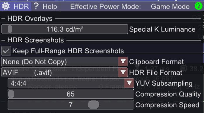

If you use SpecialK, you can take screenshots in AVIF format. Set it to quality 65 (ctrl+click on the slider to be able to enter that number.)
AVIF HDR screenshots are very small (like 1MB or so.)
