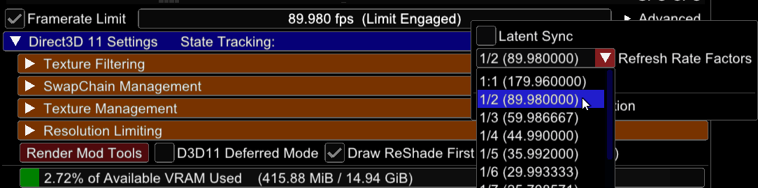

For games that don't stutter much and thus have very little VRR flicker, I use g-sync at 144Hz with a 90FPS cap (I don't need more than that.) 144Hz results in less visible VRR flicker because the display doesn't jump all the way to 240 during frametime spikes.
For games that do stutter more and thus have too much VRR flicker, I use 180Hz (with g-sync disabled in NVCP) and cap to 1/2 refresh rate (90FPS) with SpecialK. Input lag is very low that way, because capping FPS below the refresh rate eliminates vsync lag. There is no stutter because SpecialK can cap the framerate perfectly to exactly half:
240Hz with a 1/2 cap to 120FPS is an option as well.
