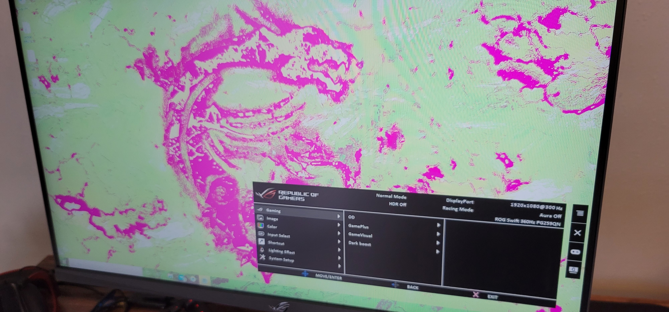

Screen is pink and green. I have plugged same cable into another monitor and switched out GPUs and the other monitor is fine. Everything points to the monitor unfortunately. What a shame. I guess I will start the RMA process unless anyone can think of a solution.
GPU is GTX 1660 Super ? Occur in all DP ports ? at all monitor frequencies like 240 or 60 ? also with HDMI ? Test disabling GPU overclock.
Here is a picture of what the screen looked like. I also replied to your questions in a separate post. Thanks for the help.
Rog Swift Pink Screen.jpg (1008.81 KiB) Viewed 8005 times

Strange how the OSD isn't messed up like the rest of the screen

So I had a very strange issue on mine recently but I've also been messing with other stuff. I saw vertical bar artifacts all over my screen but the OSD was rendered correctly so I knew it was likely a signal issue vs a panel issue.
I also tried different cables, ports, resolutions, refresh rates, timings, etc. to no avail.
Then I DDU uninstalled my Nvidia driver (safe mode, no internet), reinstalled it, and everything was back to normal.
Seems like something related to the driver somehow got corrupted.

So I had the vertical bars going across the screen as well. It's just hard to see in the picture. So, it must be a driver issue because it sounds like we had the same problem. Weird thing is that I did try another monitor and it worked fine. I don't know why a driver issue would only effect this monitor.

If it's vertical bars then it's the issue that 240hz 24" AU Optronics panels had, shame they have it again for the 360hz versions. My Alienware 240hz had it think it's called pixel inversion artifacts and looks like a lot of vertical lines down the screen almost like a CRT

I just looked up pixel inversion artifacts and what I had was totally different than what I see in example pics from the Google search, unless it was a super extreme version or something.
I should've taken some pics but basically imagine alternating vertical bars roughly 5 or so pixels wide were solid and static in position. The other bars were somewhat correct but I believe still had some other types of artifacts.
Also, the weird thing is that mine was resolved after a driver uninstall/reinstall... Perhaps it was somehow related to the additional custom resolutions and refresh rates I had although the single one I'm using now is exactly the same as the one I had prior to the driver reinstall (prior I also had other custom resolutions, just not in use).

From some other users here, mine and others were like this that randomly showed up and went away, hopefully the 360hz monitors don't get this problem anymore

Yeah, that's different than what I had.
Another strange thing is that I only had the problem on my PG259QN while my PG258Q was running fine in tandem.
Oh well. Hopefully it doesn't recur.

I had that. Tried to reboot the computer, unplug the cables, etc. What solved for me was disconnecting the monitor from the power.
I have an Asus Strix 3080
