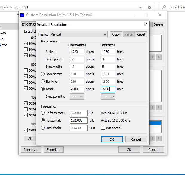

I tried this with my BenQ XL2411P but I get a black screen, is it not compatible with this monitor?
I tried doing 144 to 60 & 120 to 60 but always get a black screen. See attached image
Posts: 12306
Re: HOWTO: Quick Frame Transport (QFT) - Large Vertical Totals (reduce lag, reduce crosstalk)
Post by Chief Blur Buster » 22 Oct 2021, 09:59
bhoff wrote: ↑
21 Oct 2021, 17:41
To give advice, I need a screenshot of the original pre-tested working 144 Hz non-QFT mode too. Thanks!
