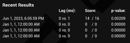

Just got the VG279QM.
Also got a HyperX Pulsefire Surge mouse.
Decided to give this another try. I thought I was getting too old but seems I still got it.
The image is smooth, I did it super fast like in 6m.

Someone give this a man a job! Is anyone else able to detect sub-millisecond differences?

hey what monitor settings did u use on your 279qm to do this test man it’s amazing that u can do that with the vg I wanna know what was your settings for that test if u don’t mind
MatrixQW
Posts: 311
Joined: 07 Jan 2019, 10:01
Re: Should you be worried about 1, 5, or 10 ms of input lag? Use Latency Split Test (LST) and find out!
Post by MatrixQW » 30 Sep 2023, 14:35
280Hz, OD80, Racing Mode, Shadow Boost 'off', Brightness 50, Contrast 80, VividPixel 0, Color Temp. User Mode R98 G99 B96
At 280Hz it has low input lag but I think that for games it might be better 240Hz because of faster response times and more room for the refresh cycle at 4,16ms instead of 3,57ms.
