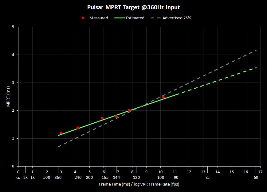

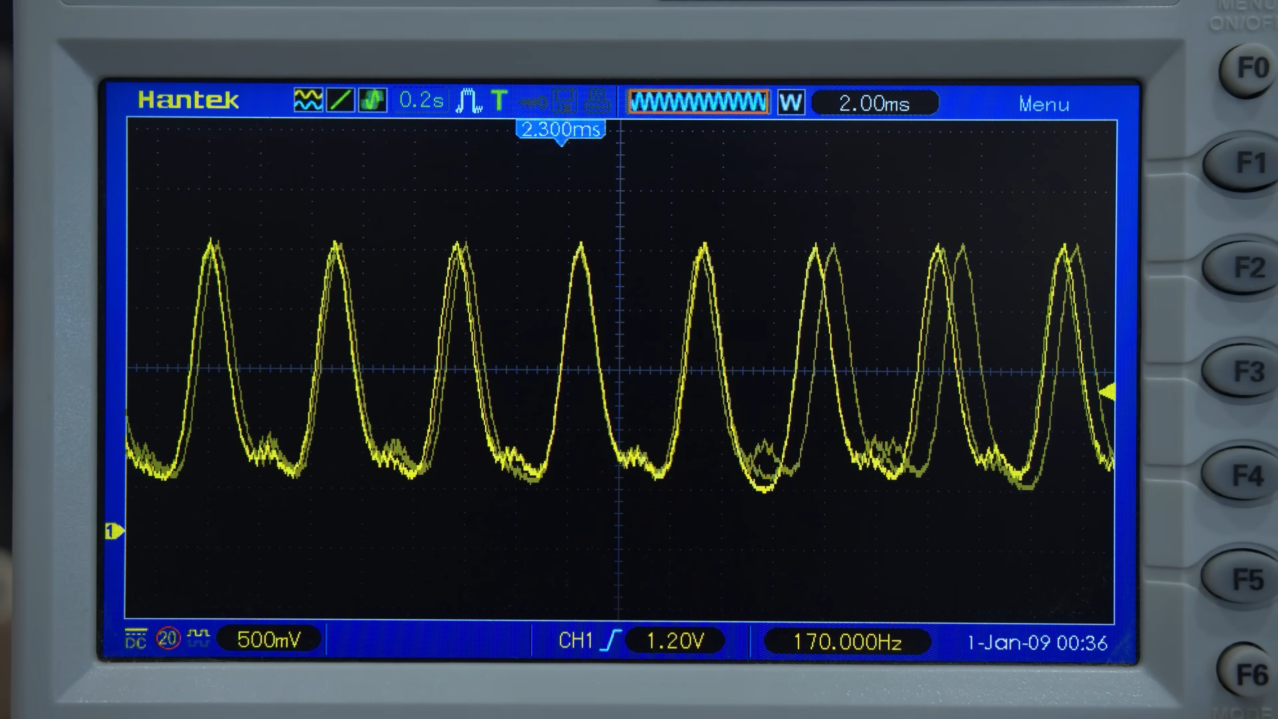

by Discorz
I just noticed something! Based on the oscillographs MUB provided, the main pulse width is unproportionally narrower at the bottom end and wider at the top end of the range. That means pulse width is not a fixed 25%. I measured them manually, then transferred the findings to one of my MPRT charts to see how it scales over the range. It's a less steep straight line that intersects with advertised 25% line at 120 fps. So it still scales linearly, just not in a way we are used to. After some rounding up this is what I got:
  • 100 fps * 23.8% = ~2.4 ms
  • 120 fps * 25% = ~2.1 ms
  • 144 fps * 26.5% = ~1.8 ms
  • 170 fps * 28.1% = ~1.7 ms
  • 240 fps * 32.5% = ~1.4 ms
  • 330 fps * 38.1% = ~1.2 ms
  • 360 fps * 40% = ~1.1 ms
Interesting behavior! Not sure if this is intentional or some limitations are at question. Also, my findings don't fully correspond with their "Over 1000 Hz Effective Motion Clarity" claim. However it does go beyond "quadruple motion clarity" below 120 fps.
The chart allowed me to visualize a shortcut formula for approximate Pulsar MPRT target (main pulse):
  • MPRT = (1000/frame rate)*0.175 + 0.625
For now formula works for 360Hz input and VRR frames below. It’s still unclear how Pulsar scales across different input frequencies, or how it behaves with VRR off (ULMB 2). Also beware of the LFC at <90 fps. Things might change for bottom range if they introduce algorithms in firmware update.
Pulsar MPRT 2026.png (26.83 KiB) Viewed 1644 times
MUB Pulsar 98 Hz fps
MUB Pulsar 170 Hz fps.jpg (562.23 KiB) Viewed 2032 times
MUB Pulsar 239 Hz fps
MUB Pulsar 330 Hz fps.jpg (578.09 KiB) Viewed 2032 times
