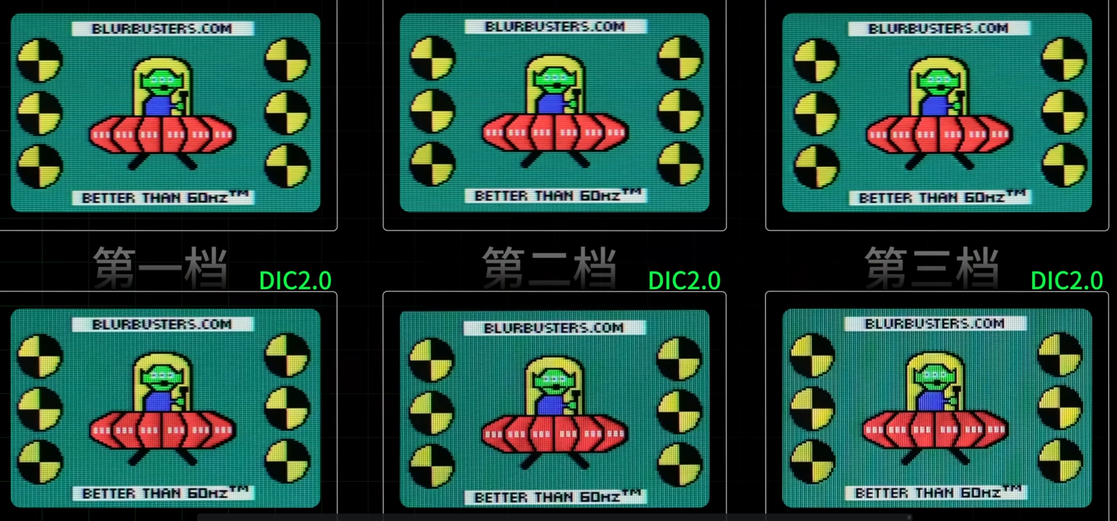

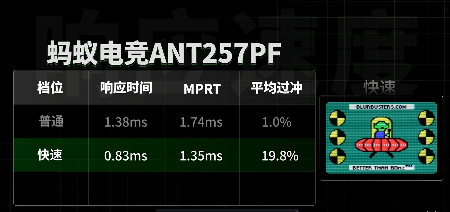

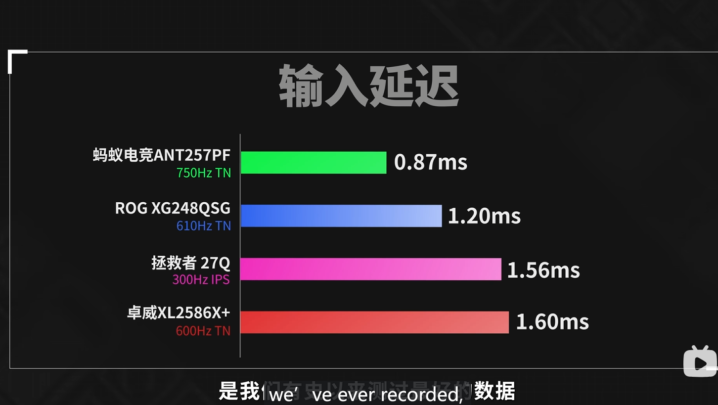

I KNOW ITS unrelated, but imagine this pulsar tech on a 750hz tn
this is the new ant gaming 750hz tn, a new TN not made by auo, its insanely fast
https://www.bilibili.com/video/BV1zHk6B ... 21a216589e
use ai subtitles, can now watch these videos
