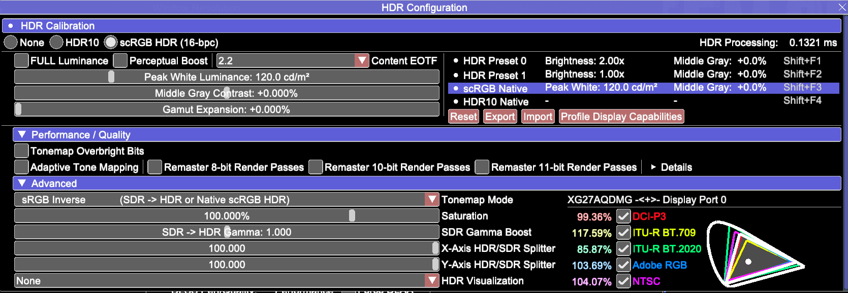

Desktop usage in HDR mode? Don't use that tool for that. Windows (both 10 and 11) will clamp to sRGB color when in HDR mode.
Other than that, SDR games can be made to look correct in HDR mode by using either Reshade or SpecialK to fix the wrong gamma. This is the workaround I'm using right now (SpecialK) since SDR mode is borked without novideo_srgb. For games where SpecialK doesn't work, you need to use Reshade instead, which is more complicated to figure out.
I posted this on Guru3D, but I'll copy it here as well:
A workaround right now is to run SDR games in HDR, and fix the gamma using SpecialK using these settings:
Click the "Reset" button first to reset all processing, and select "SDR->HDR or Native" in "Tonemap Mode". This should result in plain SDR looking as intended. The "Peak White Luminance" slider in this setup acts as a general brightness slider. The most important setting here is to use "2.2" in the "Content EOTF" setting. This uses 2.2 gamma which is what the vast majority of SDR games use.
