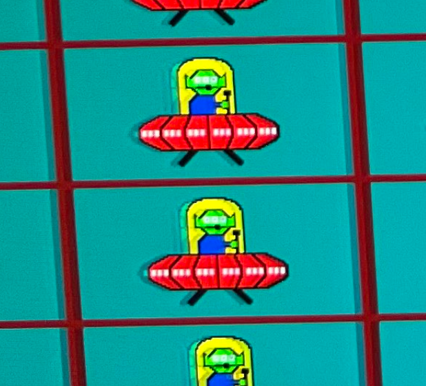

kyube wrote:
20 Oct 2022, 12:13
Crosstalk tests are here! (disclaimer: panel hasn't warmed up yet) Source: Zace from r/monitors discord
Discorz wrote:
20 Oct 2022, 13:00
Oh great! Thanks for forwarding.
I think top one is 240 and bottom one is 360 Hz. Higher refresh rate always has narrower spacing between frames assuming both are taken at same speed. And GtG proportion is better at 240 Hz.
Also for stationary-camera smartphone photo, make sure smartphone shutter is at least 2x faster than refresh cycle. This minimizes chances of accidentally capturing two strobe into the same camera exposure.
Sometimes you have to download the ProCam or DSLRCamera app to do this, to force fast shutter speed.

Chief Blur Buster wrote:
21 Oct 2022, 06:12
I think its pursuit camera because frame is blurred on 360 Hz shot. Can be hard to judge sometimes. Pls add Sync Track to full screen strobe crosstalk test.
Those apps can be weird. I've tried dozens of them. While they provide more flexible shutter, other basic settings are lost.
Re: ZOWIE XL2566K Discussion Thread [24.5" 360hz TN]
Posted: 21 Oct 2022, 07:54
by Chief Blur Buster
Discorz wrote:
21 Oct 2022, 07:23
Doesn't seem like it.
Reduced size thumbnails just make it look blurry.
You have to zoom to original size.
It looks like multiple exposures, like camera shutter too slow for refresh cycle. Need camera shutter that's no slower than 1/360sec.
See zoomed crop of the earlier attached image:
I know XL2566K does better than that.
I hereby invalidate those reddit photographs as worse-than-actual-XL2566K
21 Oct 2022, 07:54
Discorz wrote:
21 Oct 2022, 07:23
Thats probably 240 Hz you cropped.
I meant the monitor frame.
