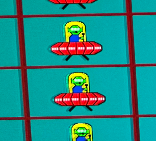

Crosstalk tests are here! (disclaimer: panel hasn't warmed up yet) Source: Zace from r/monitors discord

I think top one is 240 and bottom one is 360 Hz. Higher refresh rate always has narrower spacing between frames assuming both are taken at same speed. And GtG proportion is better at 240 Hz.
Also for stationary-camera smartphone photo, make sure smartphone shutter is at least 2x faster than refresh cycle. This minimizes chances of accidentally capturing two strobe into the same camera exposure.
Sometimes you have to download the ProCam or DSLRCamera app to do this, to force fast shutter speed.

I think its pursuit camera because frame is blurred on 360 Hz shot. Can be hard to judge sometimes. Pls add Sync Track to full screen strobe crosstalk test.
Doesn't seem like it.
Reduced size thumbnails just make it look blurry.
You have to zoom to original size.
It looks like multiple exposures, like camera shutter too slow for refresh cycle. Need camera shutter that's no slower than 1/360sec.
See zoomed crop of the earlier attached image:
I know XL2566K does better than that.
I hereby invalidate those reddit photographs as worse-than-actual-XL2566K
Thats probably 240 Hz you cropped.
I meant the monitor frame.
https://i.ibb.co/LJL6FWv/XL2566-K-Dy-Ac ... mid-up.jpg
