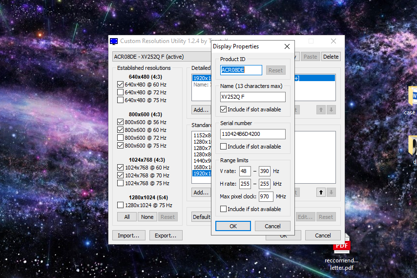

Do you mean vrr is not working when fps/hz goes over 360fps/hz with nvidia gpu? If that is the case you might need to manually expand vrr range in CRU. That's what I had to do for my VG279QM (g-sync compatible certified) with amd gpu, change it from native 240 to 280Hz.fracture wrote: ↑24 Jun 2021, 14:46I might get an amd card to use freesync on this panel. Now that I have played more battlefield 4 online with it I can see how great it is just due to less ghosting and blur at the higher refresh rate. The problem with gsync compatible is that I am not getting the full vrr range. I have no idea what the range is with gsync compatible.

I'm not sure if I am getting limited or not I just wanted to know because on the nvidia site is explains that with compatible gsync it might give you only like 48hz-120hz since its not the real thing.
This is what my VRR range looks like in CRU. 48-390hz. Does this mean gsync compatible IS letting me have full gsync range ? is V Rate VRR range ?
