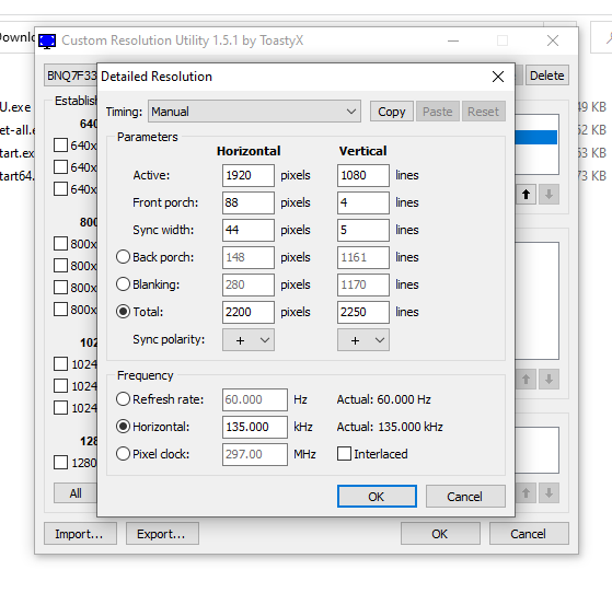

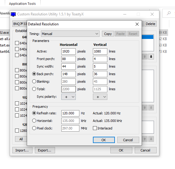

I deleted all my resolutions except 120hz & 60hz QFT for testing, here's a screen shot of a fully working normal 120hz and a screen shot of the 60hz QFT that gives a black screen.
- 60hz 120q black screen.PNG (36.62 KiB) Viewed 41539 times
- 120Hz fully working.PNG (38.44 KiB) Viewed 41539 times

Re: HOWTO: Quick Frame Transport (QFT) - Large Vertical Totals (reduce lag, reduce crosstalk)
Thanks!
The easy QFT formula is much more unreliable on monitors that do not support FreeSync. XL2411P does not support FreeSync.
While fixed-Hz QFT is not VRR, the existence of FreeSync means the scaler is usually QFT-compatible.
However, XL2411P does support some undocumented QFTs but requires a lot more random hacking of the VTs. You now found your upper bounds of experimentation. Now try locking the radio button on the refresh rate, and then decrementing your VT until it works. XL2411P does support smaller large vertical totals at 60Hz.
You may, possibly try to continue to attempt QFT on XL2411P by using a different porch (e.g. modify the Front Porch, the Sync, and the Back Porch) to transfer the some VBI allowances between all three. Vertical Total is the vertical sum of (sync + back porch + visible + front porch):
So on some monitors, a problem is solved by changing the ratios between the porches as well as the sync. However, this does not always work on all monitors, and you have to instead just begin decreasing the porches instead to a more manageable number like VT1500 or thereabouts.
You lose the easy QFT formula in this QFT HOWTO, so you have to do more experimentation/hacking to get XL2411P to do a QFT mode. There are some documented working QFT modes in some of the other threads (e.g. VT1350 and VT1502)

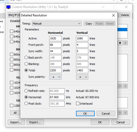

I tried playing around with it and was able to get this working
What's weird is my monitor says "Out of range" and blocks me from accessing the monitor settings, but the image looks perfectly fine.
