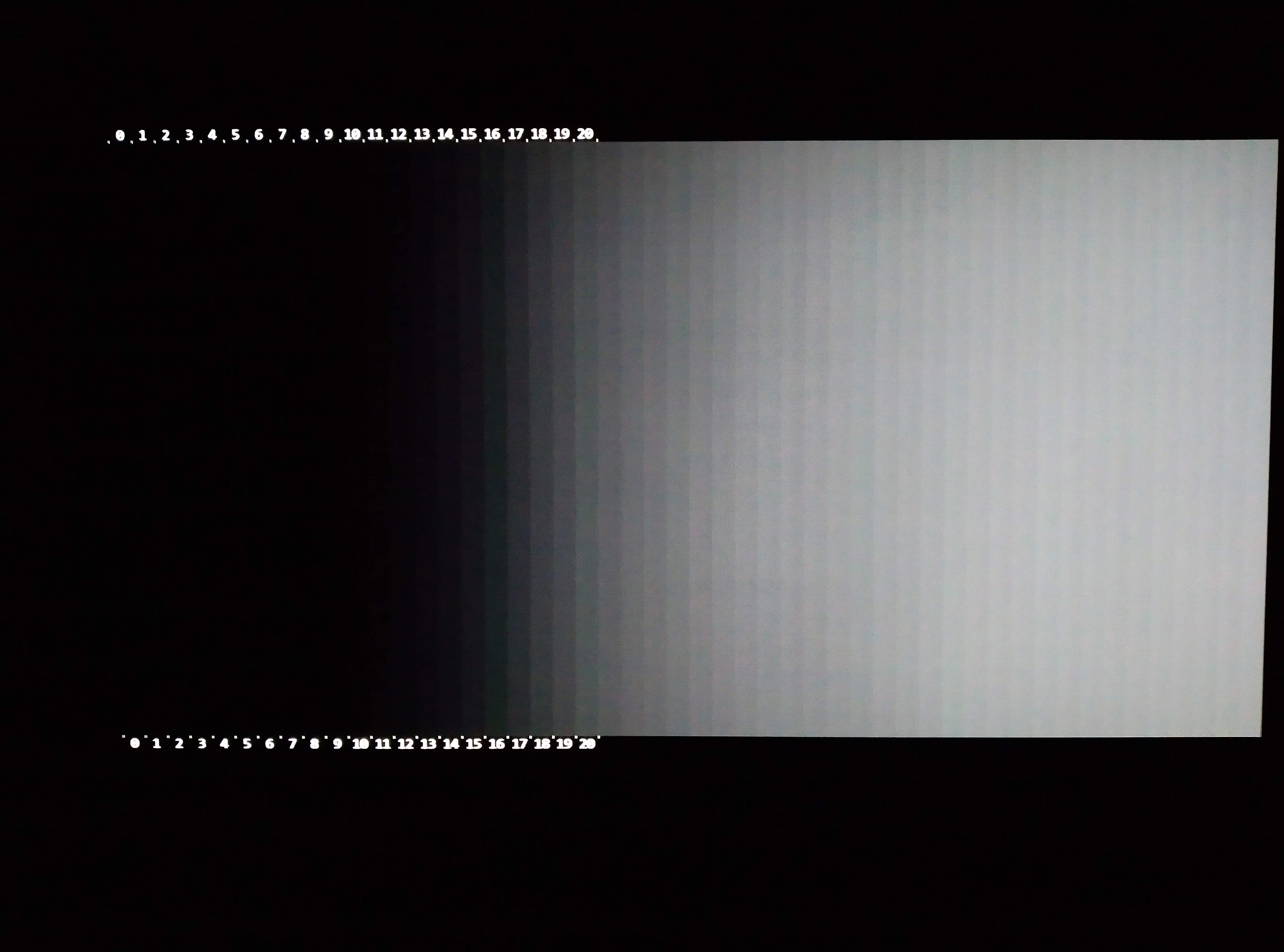

Recently I had a chance to try out the LG 27GX790A WOLED, but ended up returning it due to banding/posterization and other issues. Now after seeing your post I wonder how it would've performed with 6-bit temporal dither tweak. Can you take few pictures of your panel using this gradient test pattern in good old SDR? It would be interesting to see photos of:
1) factory default settings
2) your personal improved OSD settings
3) your personal improved OSD settings + 6-bit dither tweak
4) other settings you find helpful/interesting
Make sure camera exposure is not clipping and consistent, and the room is dark.
Images bellow show what I was dealing with - black crush, missing shades, abrupt shade change. By shifting the whole spectrum down via OSD by couple RGBs I managed to work around the black crush issue. How OSD settings affect shades is nicely demonstrated in this video. But other flaws were unavoidable. Especially the "no shades" part. The spectrum can be moved further down just until the "abrupt shade change" but that came at the cost of considerably raised blacks and overbrightened gamma. Did you come across similar issues?
Shitty camera from a cheap Nokia phone from 2018 :P
(These are on Linux, because novideo_srgb stopped working on recent Windows Nvidia drivers.)
No dither, display in wide color gamut mode, sRGB color clamp through the video driver:
6-bit temporal dither, display in wide gamut mode, sRGB color clamp through the video driver:
6-bit temporal dither, display in sRGB color mode:
Using the sRGB mode of the monitor itself makes 0-8 completely black. Leaving it wide gamut and doing the sRGB clamp though the driver only has 0-4 completely black. The 6-bit dither has a weird effect. It has 0 completely black, 1, 2 and 3 visible, and 4 completely black. So it has its own issues :P

Thanks. I see your woled also crushes some black, but the gradients appear much smoother compared to mine. This makes it much more manageable I suppose. Interesting! It remains a mystery why woleds handle darks unreliably.
