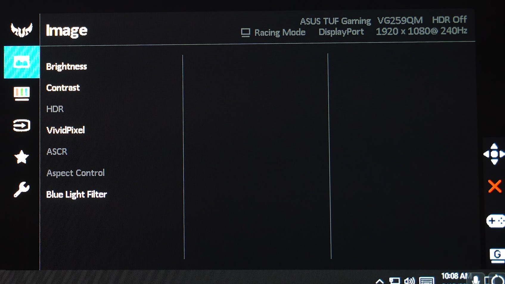

I have one question left, is there blue light reduction option on this monitor?

Post by RealNC » 02 Jun 2021, 05:06
Optimal wrote: ↑
01 Jun 2021, 23:20
All monitors that allow RGB color adjustment can be configured to remove blue light, even if no explicit "blue light" option exists.
But the VG259QM does have an explicit setting anyway:
